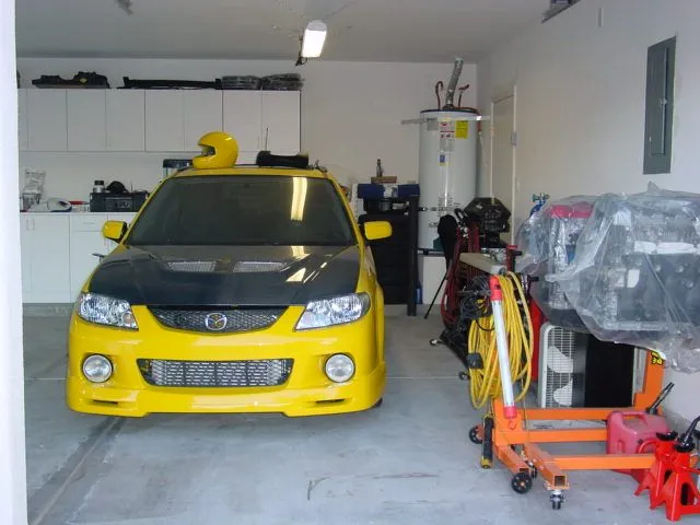

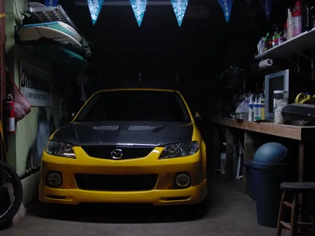

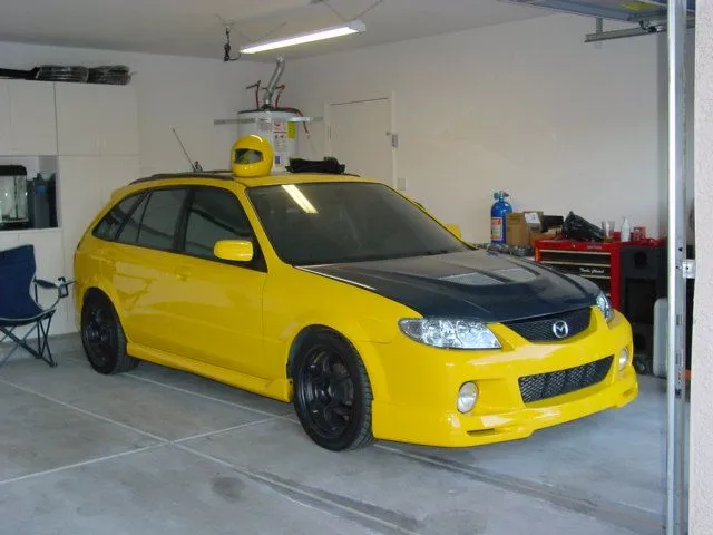

Dyno sheet to come, he still hasnt sent them to me. Heres a picture though

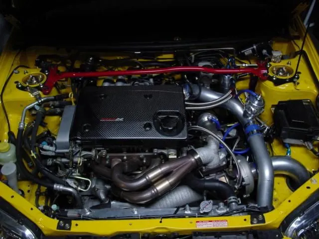

In short.
fully built motor
fully built transmission
t3/t4 ball bearing
motec m4
to much to list, but thats the core of it.

Here is a updated motor pic.
