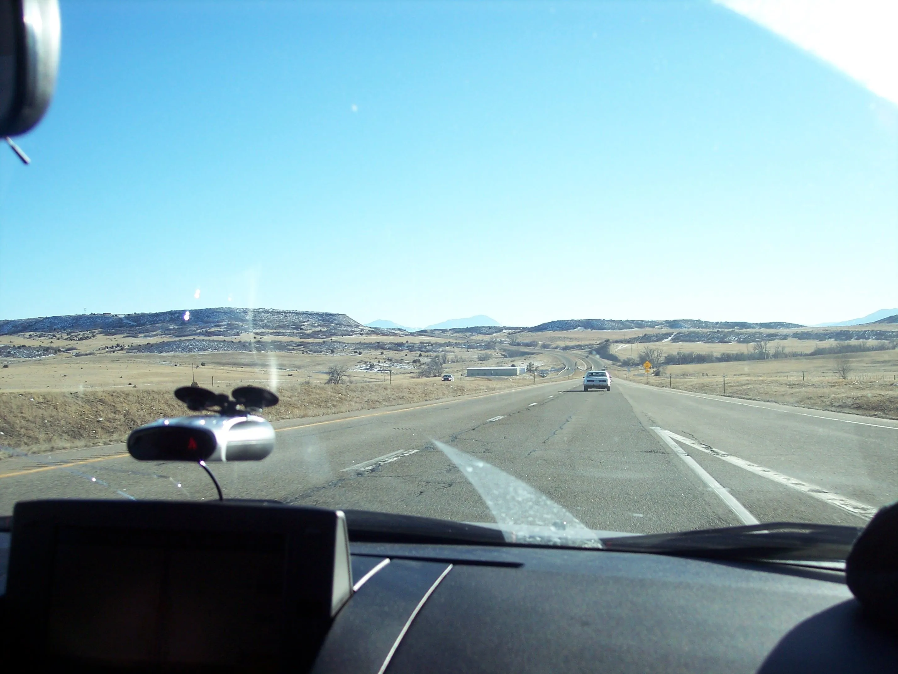

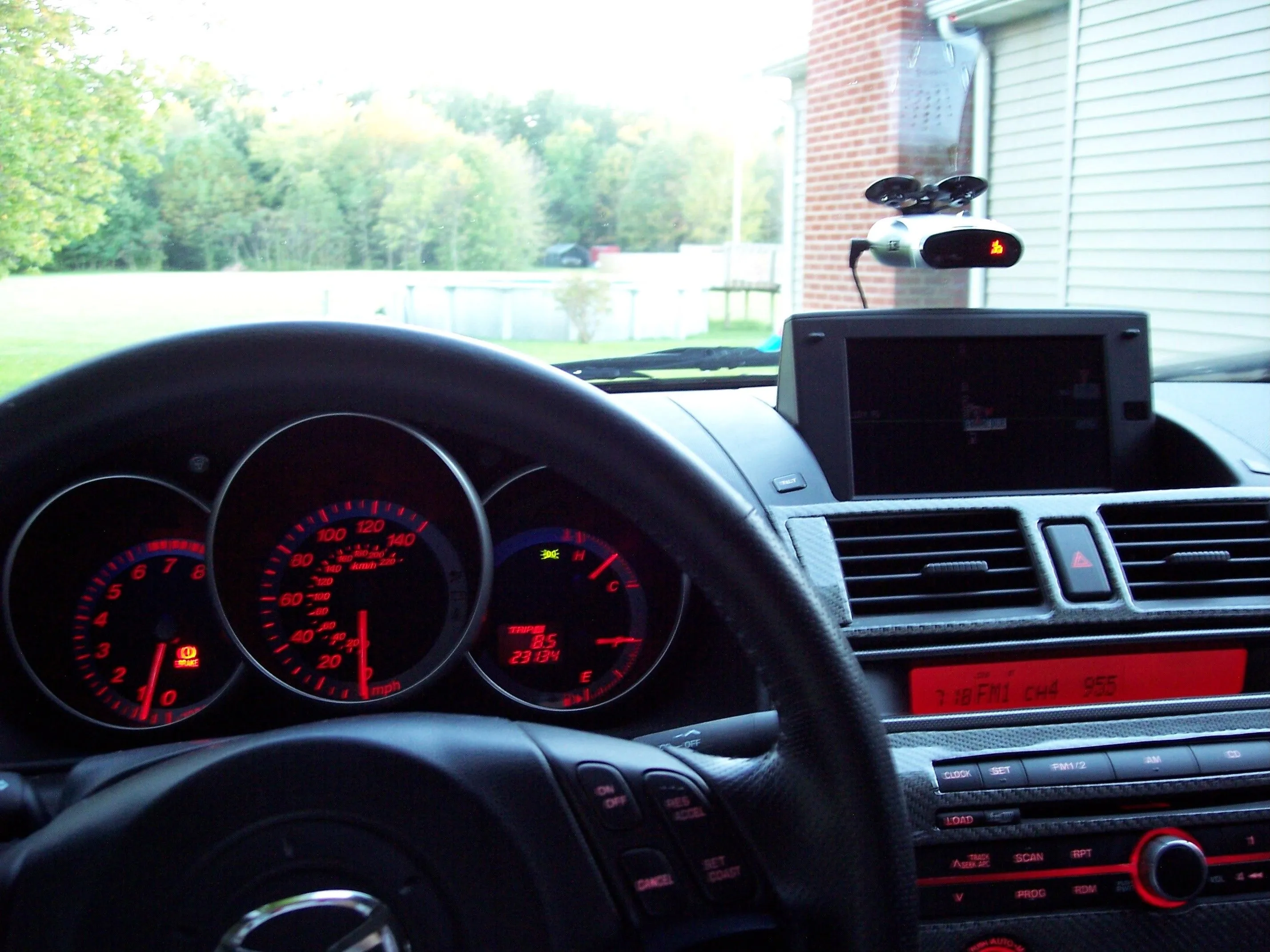

i pulled my dash apart and ran the wire under my navigation screen from the sig lighter. the only part of the wire you can see if the 2" from the dash up to the radar detector. lemme see if i cant find a pic.....
Not the best pics, and dont mind the huge crack in my windshield in the first one.

My radar detector wires go across the headliner, down the pillar, and taps into one of the switched 12v wires found in the kick panel (I added a 1A fuse just in case). Ground just goes to one of the chassis grounding points nearby. It's hard to explain without pictures, but I made a bracket that slides between the headliner and the passenger visor clip (I hate suction cups) to physically hold the detector. It works well, but does not allow the passenger visor to fold all the way back towards the windshield - but it does allow it to come down.
