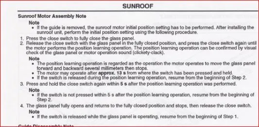

Anyway, I'm not sure if its the same concept as the mazda5 sunroof. But here
is the sunroof calibration for the MAZDA5.
