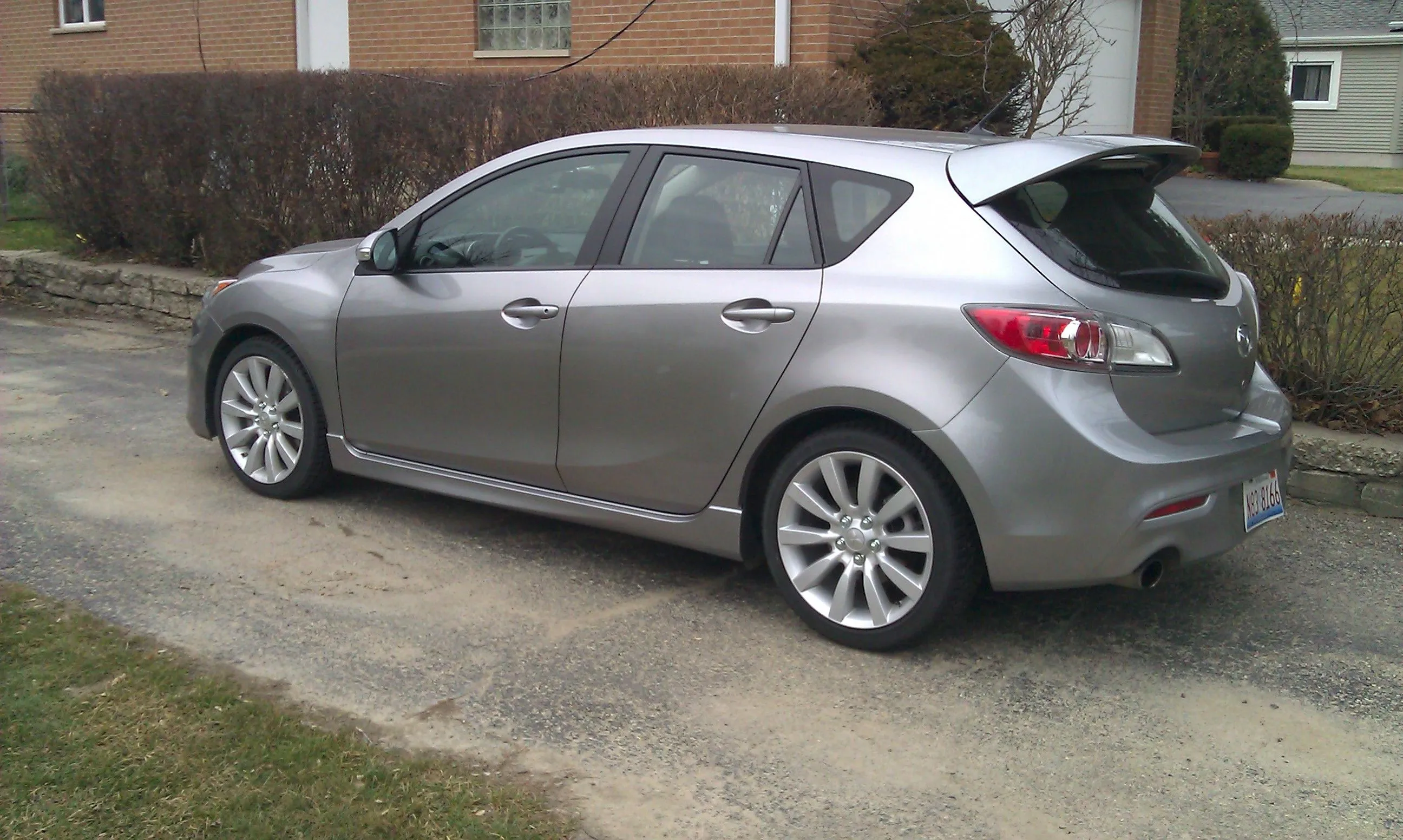

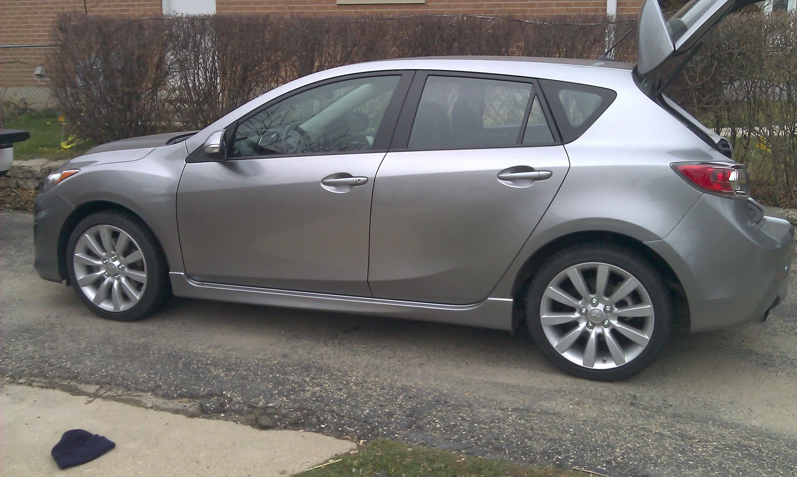

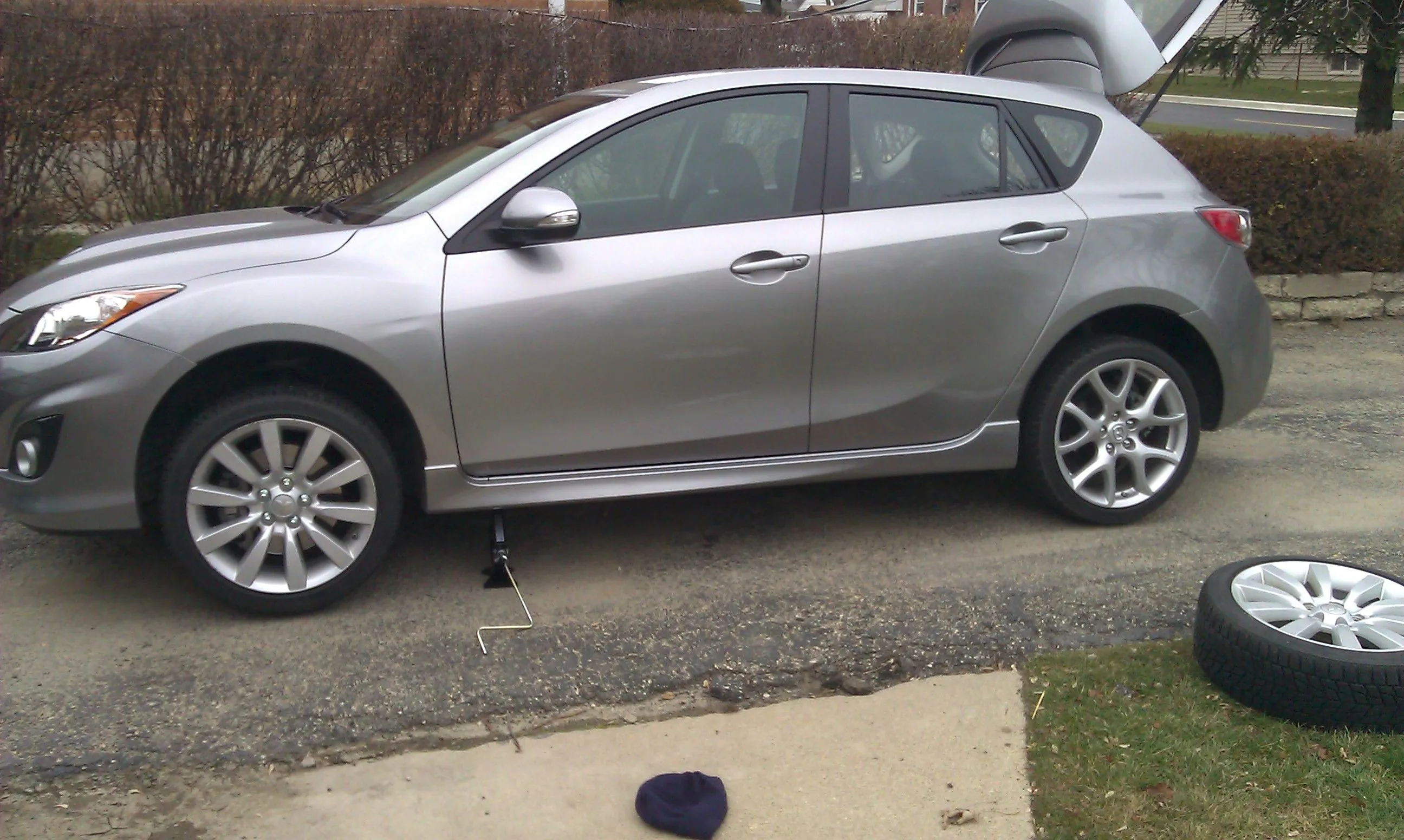

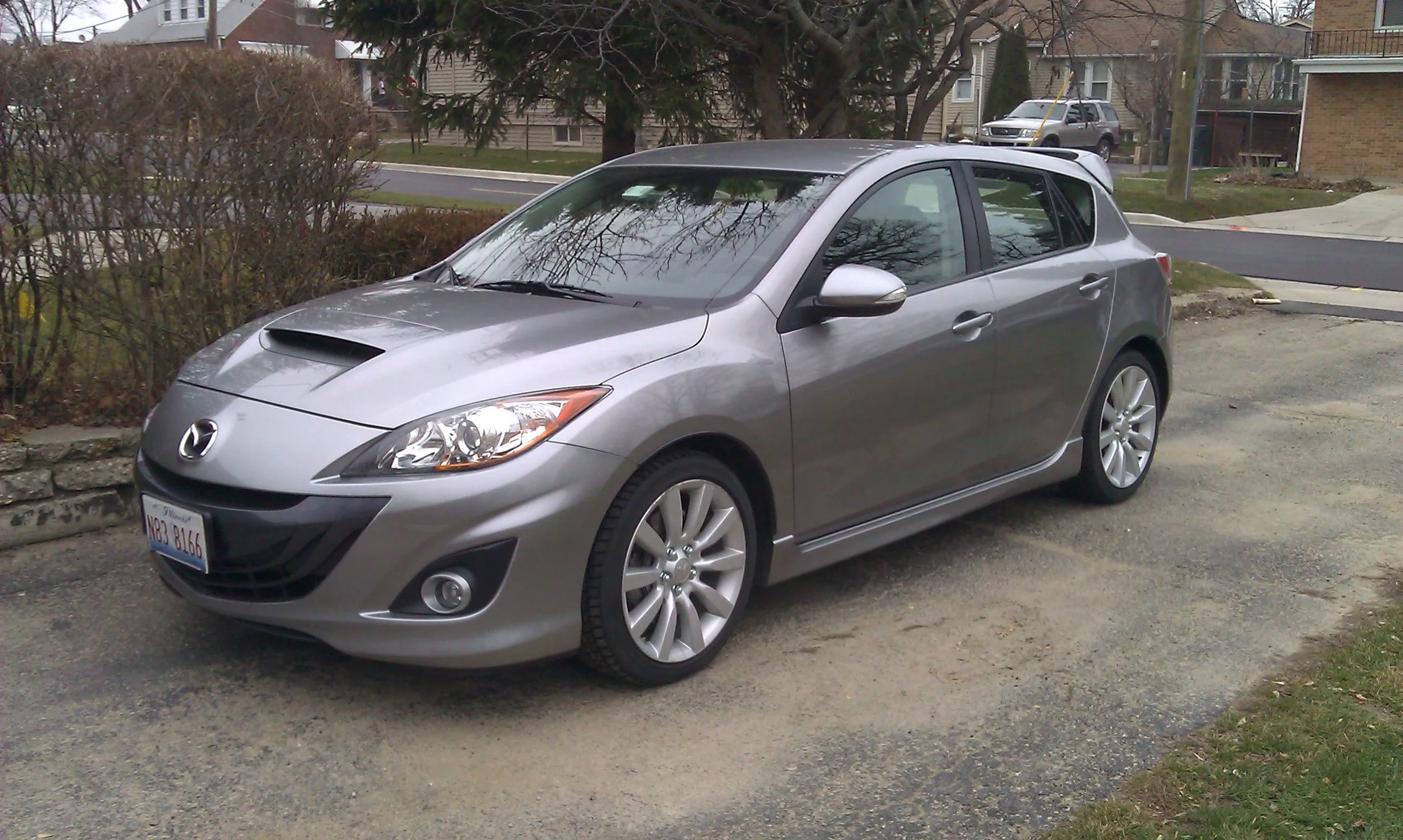

Well I guess I will just have to find out the hard way. If it works I will take pics and post
They will fit but you will need to use her lugs. The mitsubishi use a flat-washer style lug and we use an acorn/taper design. They are the same thread pitch as ours though so they will work with out bolt studs.
I thought my front tires spun alot before, I will have to keep my right foot off the throttle in 1st and 2nd if I want these blizzaks to last long. Wheels fit fine, as mentinoned above, I needed to use Mitsubishi lug nuts.
