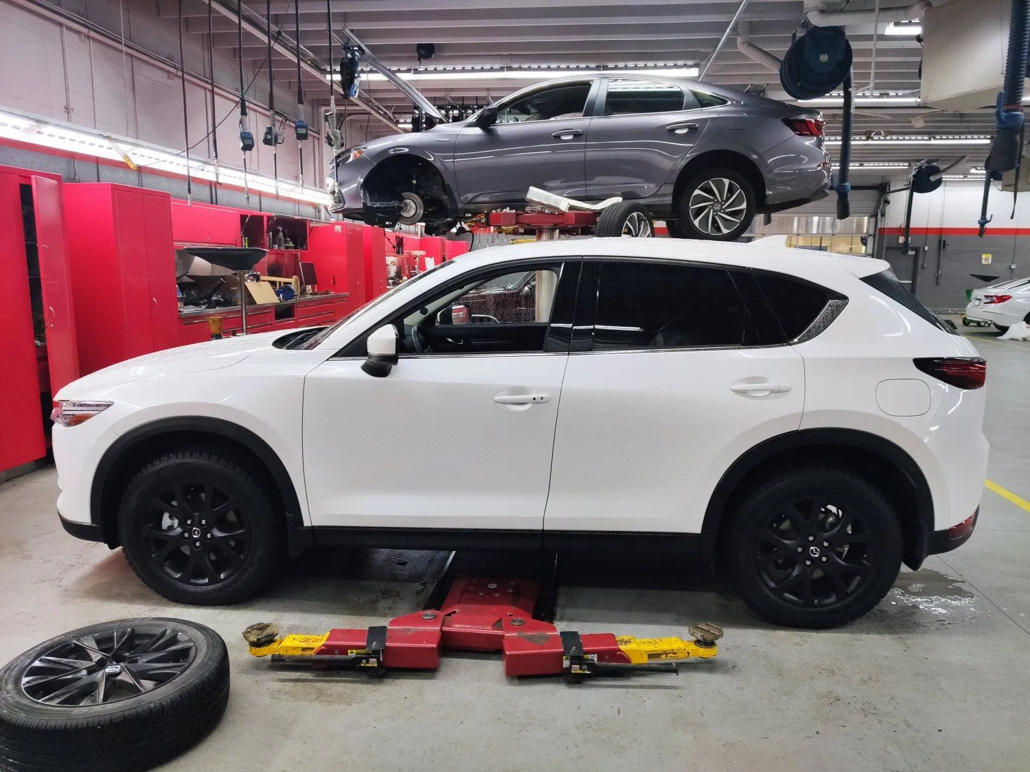

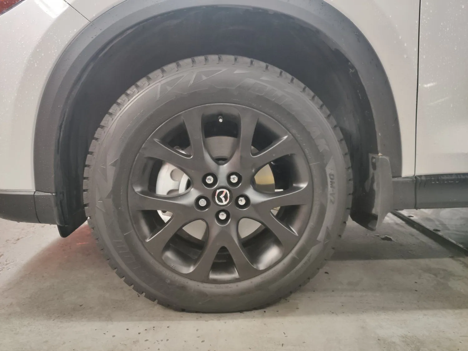

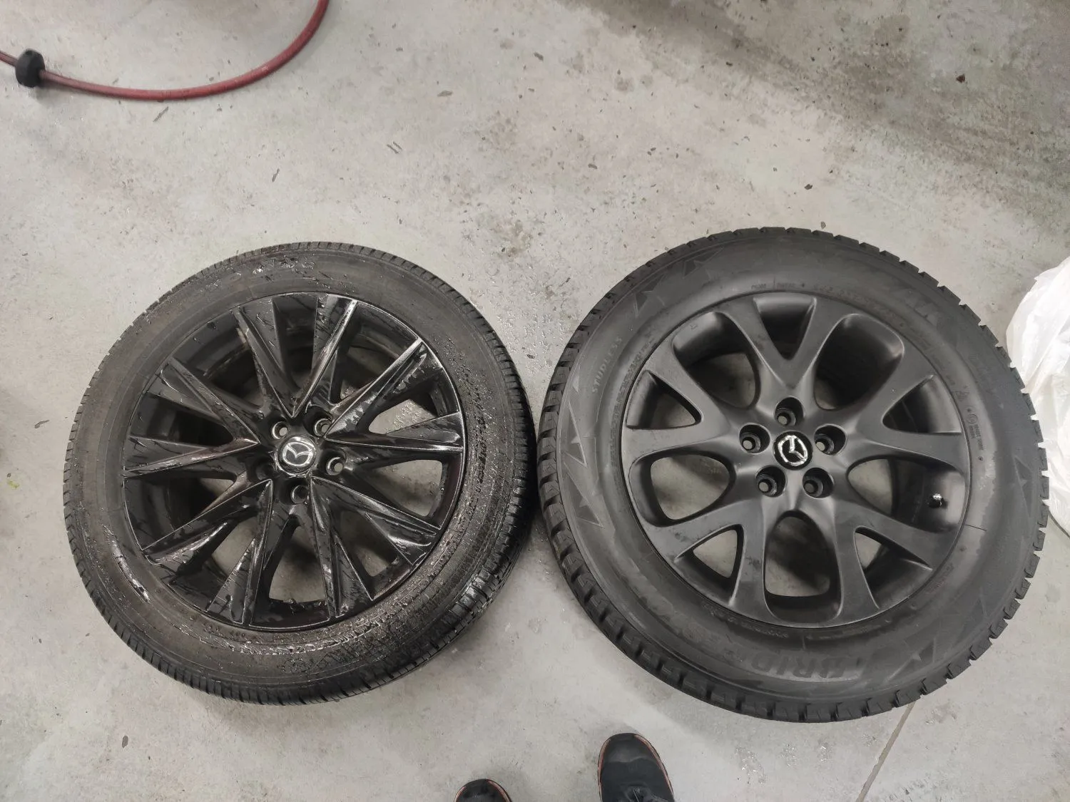

Alright sorry about the late pics! here it is. rims is from a cx7, i plasti dipped it black, center cap and valve stem cap from ebay, tire is 245/60/18 Bridgestone Blizzak.
OEM rim with toyo

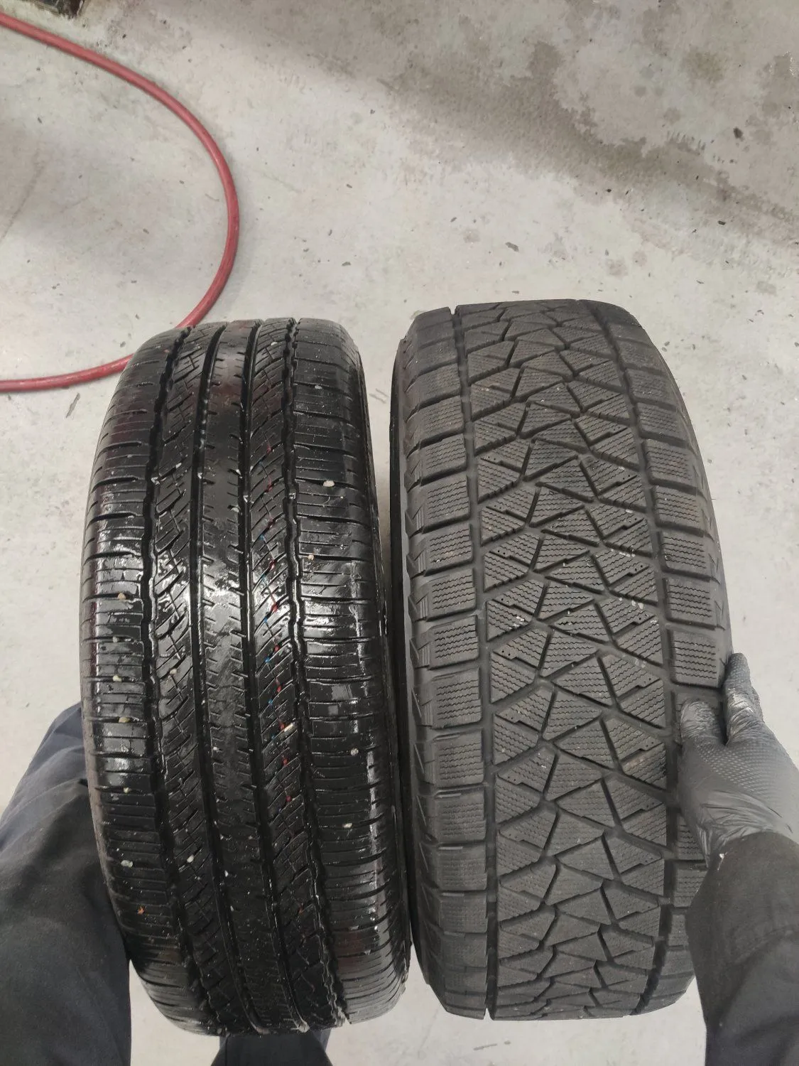

Comparison between the two rims and tires

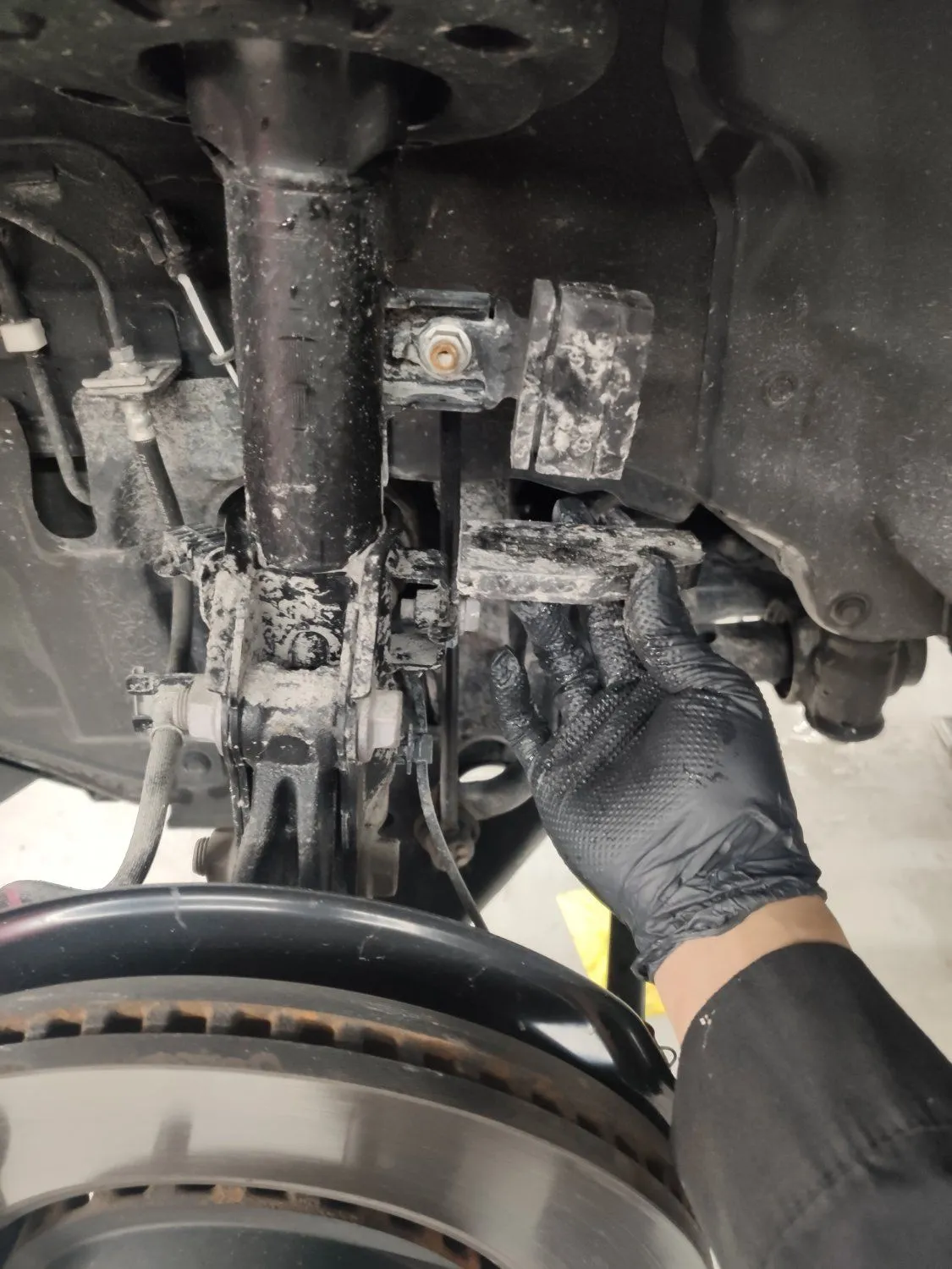

Since it is a different offset rim comparing to oem rim, you will need to remove one of the rubber vibration dampener on the front suspension. (the one im holding) No difference in terms of comfort with or without this rubber, i actually prefer the winters more, feels more comfy and gripy.

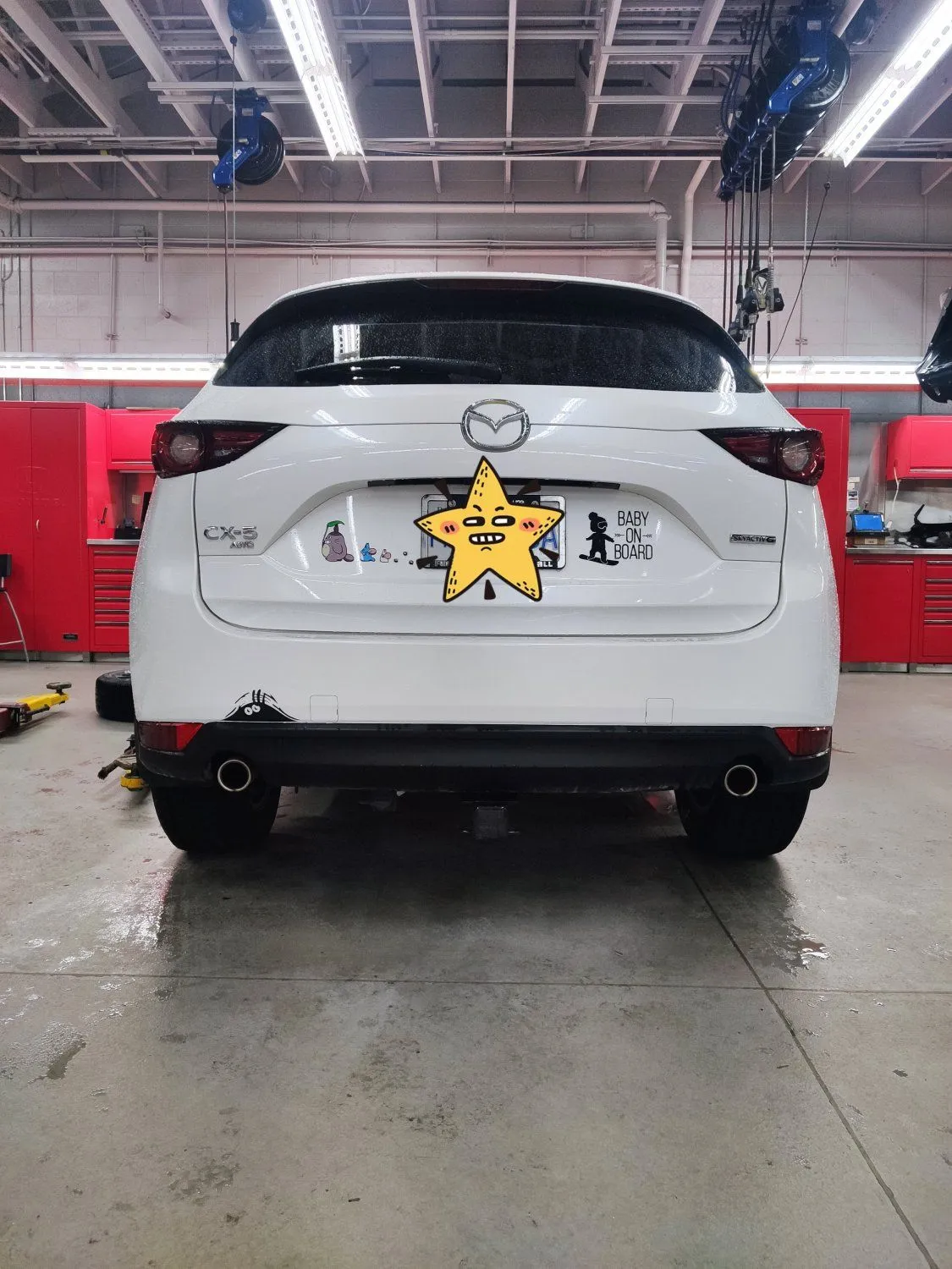

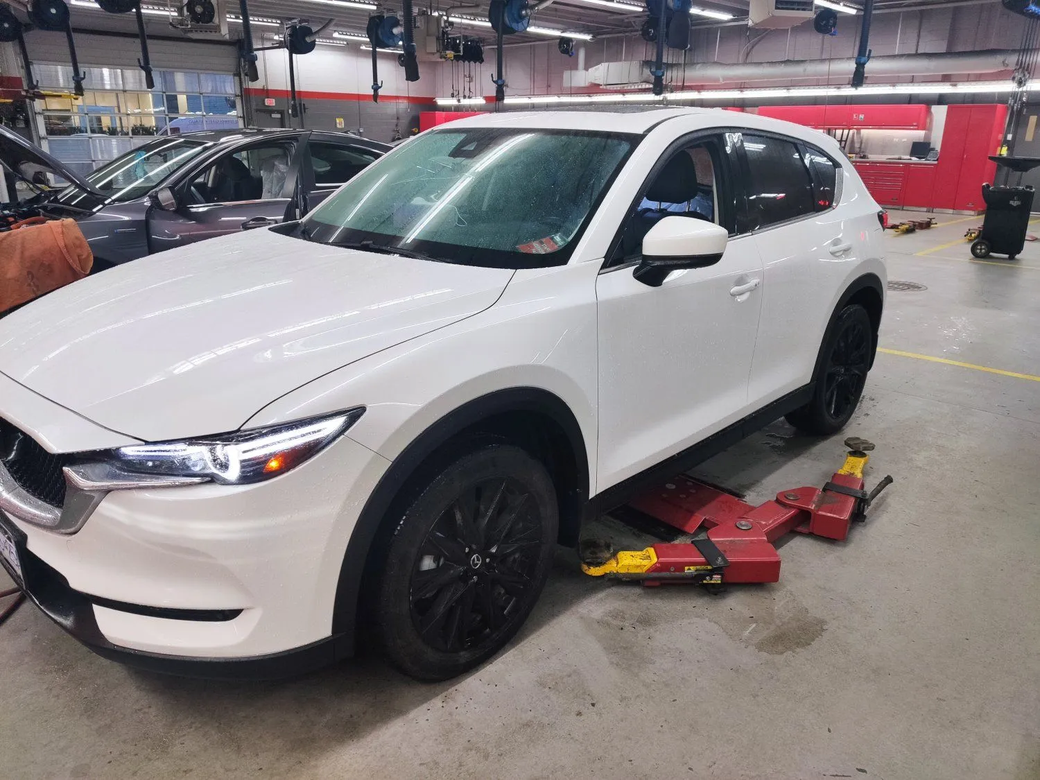

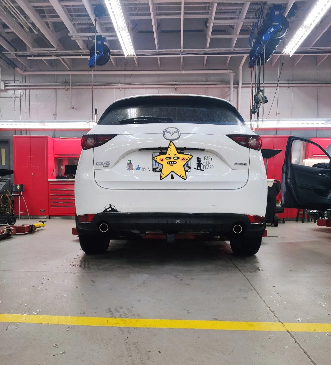

Heres the pics with rim on the car, honestly for me it looks alot better from the back, the tires are alot wider and i do like the look of the rim on the cx5, looks very agressive.
OEM rim with toyo

That sticker with peeking creature is awesome. Oh and the Baby On Board is also a gem. These are the kind of stickers I enjoy seeing on cars!
haah yea i was browsing aliexpress, and i saw these stickers, they are like a dollar each so i thought why the hell not .
