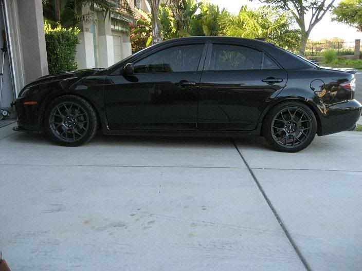

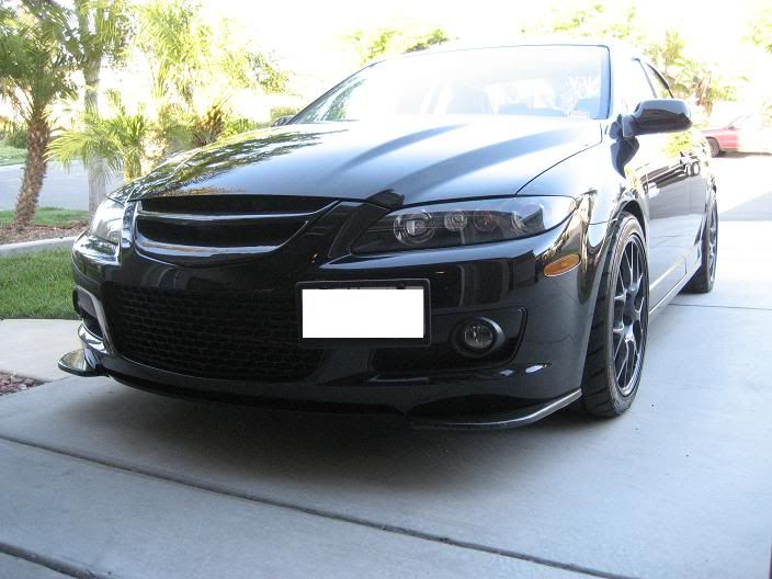

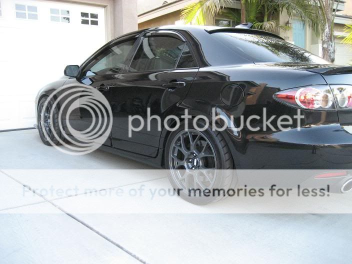

Evo wheels will fit...I have some EVO X MR BBS wheels on my MS6 (18x8.5 with 245/40/18) No boring out....Just gotta roll the fenders.
pics of this....i've been looking for new wheels and this seems like a great option. i've really been wanting to upgrade to a wider tire. did it improve the handling much?
autoexe lowdown springs (cut one coil on the fronts) with nitto nt-05 245/40/18 tires. and thank you DelB
