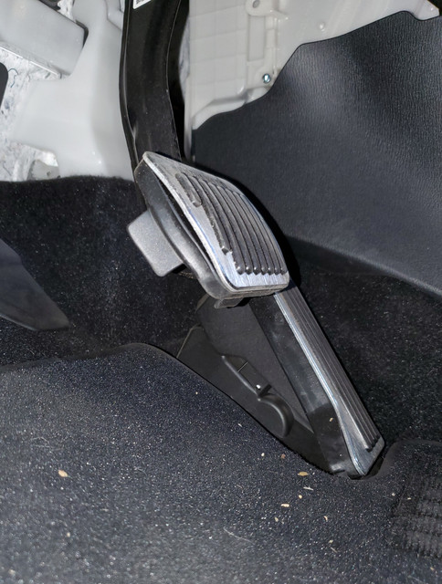

images
Geez after I posted this photo I went looking for photos of CX-5s pedals and most of them line up very well.
Mine don't, at all.
Went to go take a photo to illustrate my point but they are lined up. Then I realized that my parking brake is on and the brake pedal goes down when that happens.
Never know this’d be the case. Not normal to me.
This is on mine with parking brake on. Gas pedal probably around half an inch difference vs the brake pedal.

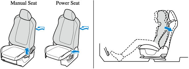

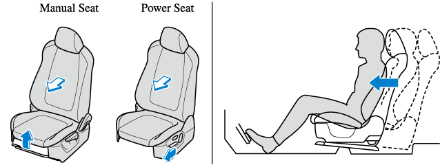

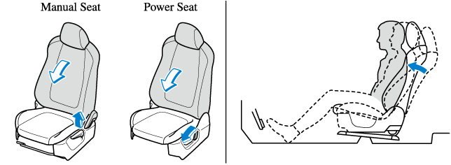

Referring to the seat adjustment procedure in the manual (see bolded text):
Adjusting the seatback angle (reclining)
Adjust the seatback to the angle providing a comfortable seated posture.
  1. With your posture slightly slouched, move the seatback forward to the angle where your waist feels slightly cramped.
  2. Move the seatback backward to a comfortable seated posture without any feeling of cramping in your waist.
Adjusting the seat position forward and back (sliding)
Adjust the seat to the position best for operating the accelerator and brake pedals.
  1. Place your left foot on the footrest, your right foot between the accelerator and brake pedals, and position your heel to the position allowing easy switching between the pedals.
  2. With your heel set on the floor, set your right foot on the brake pedal and move the seat forward as far as possible until you feel a slight cramping in your ankle.
  3. With your right foot set on the brake pedal, move the seat back until you no longer feel cramping in your ankle.
  4. With your heel set on the floor, make sure you can move your foot between the brake pedal and accelerator pedal smoothly.
  5. Depress the accelerator pedal completely with your heel set on the floor and make sure that your ankle does not feel over-stretched.
In this case, following the instructions (or using them as a reference) shows you how to find the right spot for your heel, so you can comfortably pivot between the brake and the accelerator.
