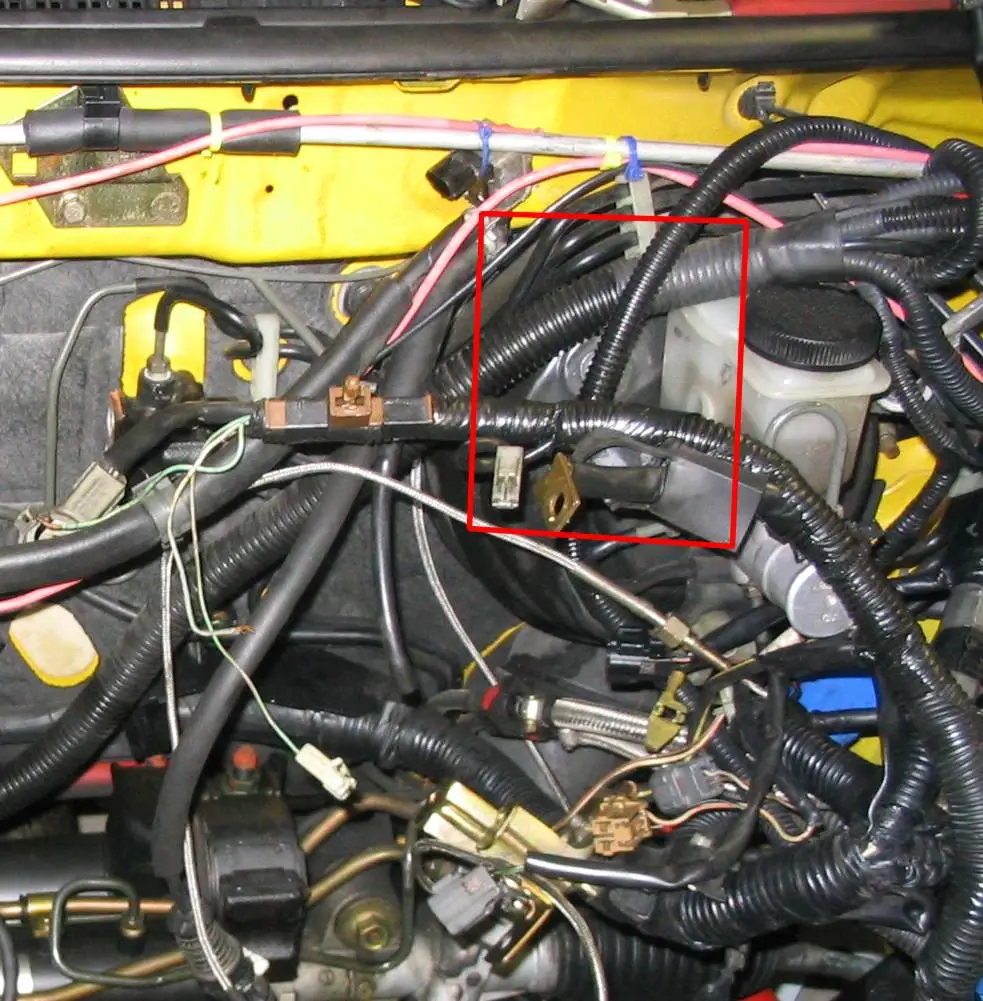

I would like to say that I am in no way upset about Turfburn's product. I really don't know what is causing this problem. Maybe it is the vacuum source. Which is the brake booster line. Anyone have a pic, i'll try it. I just wanna hold 9 to 10 psi without falling off to 5 or 6 psi.

The brake booster vacuum line is the rather large line coming off of the big round black drum looking structure on the firewall that your master cylinder/clutch/brake fluid resevoir is mounted to. You migh need an adapter though to use that as I believe the line is like a 5/16" line and the lines for the turbo and the MBC are typically 5/32"-1/4"
This may have something to do with your wastegate which is where the problem gets to be more complex. GlowMunkey however has one of my MBC's and has the same problem as you. He can put a JoeP on though and it solves the issue. Which makes me wonder if the pressure losses through my MBC are high enough that it is lowering the "signal strength" in the line enough to cause your issue. However, all the other ones are very stable and work very well. Additionally, if the MBC was restricting the signal too much it would actually in fact raise the boost rather than cause it to fall off, as would a vacuum leak. So that is why it seems to be more mechanical in nature. I can get you another MBC out if you wish to see if that solves the problem. Otherwise if you are willing to work on this until it gets figured out that would be wonderful and I'll see what I can do for your time and troubles!
I'd be very curious to see what happens when you T it off the brake booster. That is one of the strongest signals on the car for sure.
EDIT: Attached image with the brake booster and approximate location of the hose identified.
