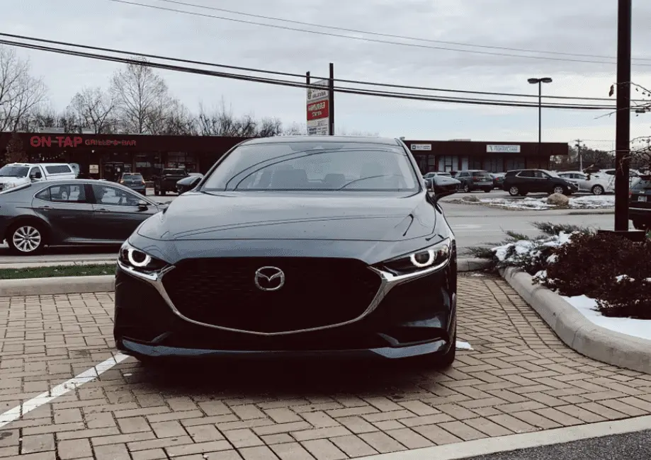

The Mazda 3 has the same lights and only enable the DRLs during the day. The CX-30 also turns on the headlights - making the DRLs impossible to see. I wonder why that is, and if there is a way to disable the headlights during the day ? The Mazda 3 without headlights on is a much nicer look !

I took a close look at the headlights and taillights in a dark garage where the headlights are fully ON. The first thing I noticed is that the front and rear lighting have a very similar (and cool) design - flutes along the outside of the taillight housing that connect to a ring open at the top. The idea is the light comes through the flutes to the ring (or visa versa). Looking closely you can see that the rings and flutes are lit independent of the headlights and taillights. This makes sense because an active headlight would not be able to light the rings consistently because it 'moves'. I'm back to my original premise that the front DRL's are lit and the front headlights are also lit during the day. It would look much nicer (like the Mazda3 below) if they didn't power-up the headlights during the day. Now if I could get to the right person at Mazda to explain why they wired it this way, and if there is a way to turn the headlights off during the day and leave the DRL's on like the Mazda3.
