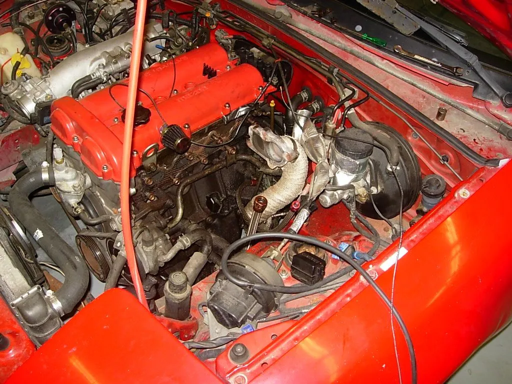

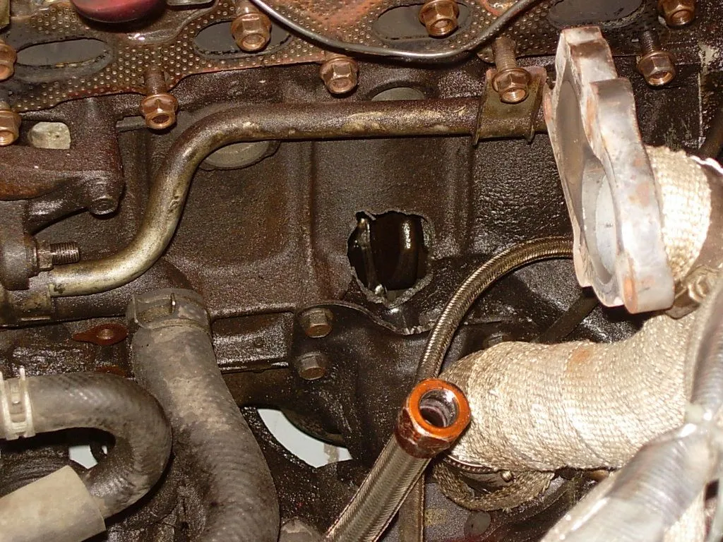

Death came to Challenge Miata that wasn't. It's demise came quickly and painfully. I have to hand it to Phil. He handled it a lot better than I would have.

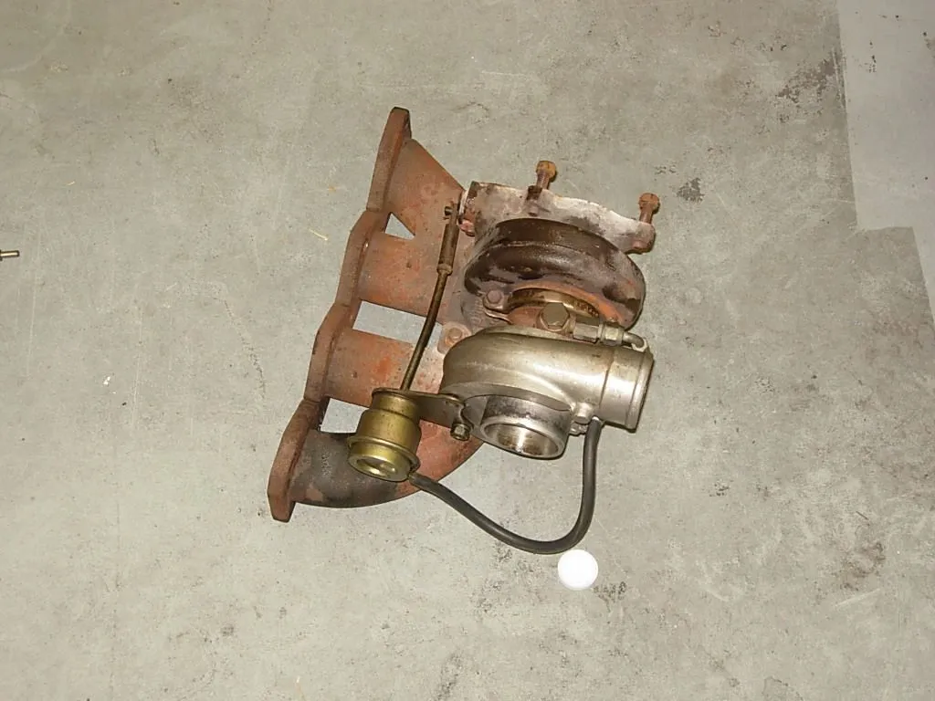

He'll be bringing it to my house this weekend so that I can swap a new engine into it. Unfortunately, the turbo will have to be replaced also as it injested a few junks of an adventurous connecting rod.
The carnage:
I'd be uber PO'd if the engine AND turbo were toasted due to one mistake.

I think there was something seriously wrong with the car before Phil received it. First, the stock injectors are undersized and second, I wonder what the timing advance was set to.

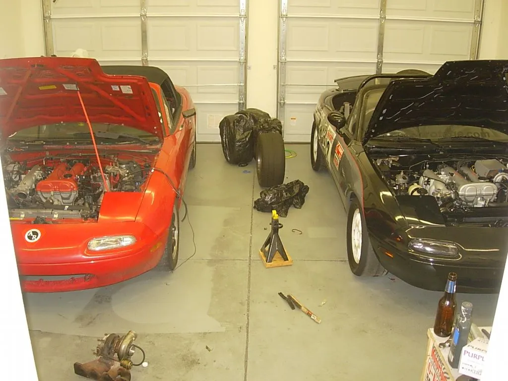

Phil finally got a chance to drop off his Miata off last night and the disection has commenced today. During the process of disconnecting and removing various bits to enable removal of the engine, I discovered several oddites. It, at one time, had some sort of engine management as there are taps for sensors in various places including but not limited to an EGT port, ECT tap, and BOV. Furthermore, the wiring harness is butchered and there are exposed crimp on connectors everywhere, ugh.
The most notable abnomaility was how far the timing was advanced. Looking at it's position, the CAS was advanced no less than 20*. In fact, it was modified to be advanced outside of the OE range.
Just for fun, I'll post a few pics of the process of the removal and install of the old and new engines (as well as a few of the bottom end rebuild of the replacement engine).
