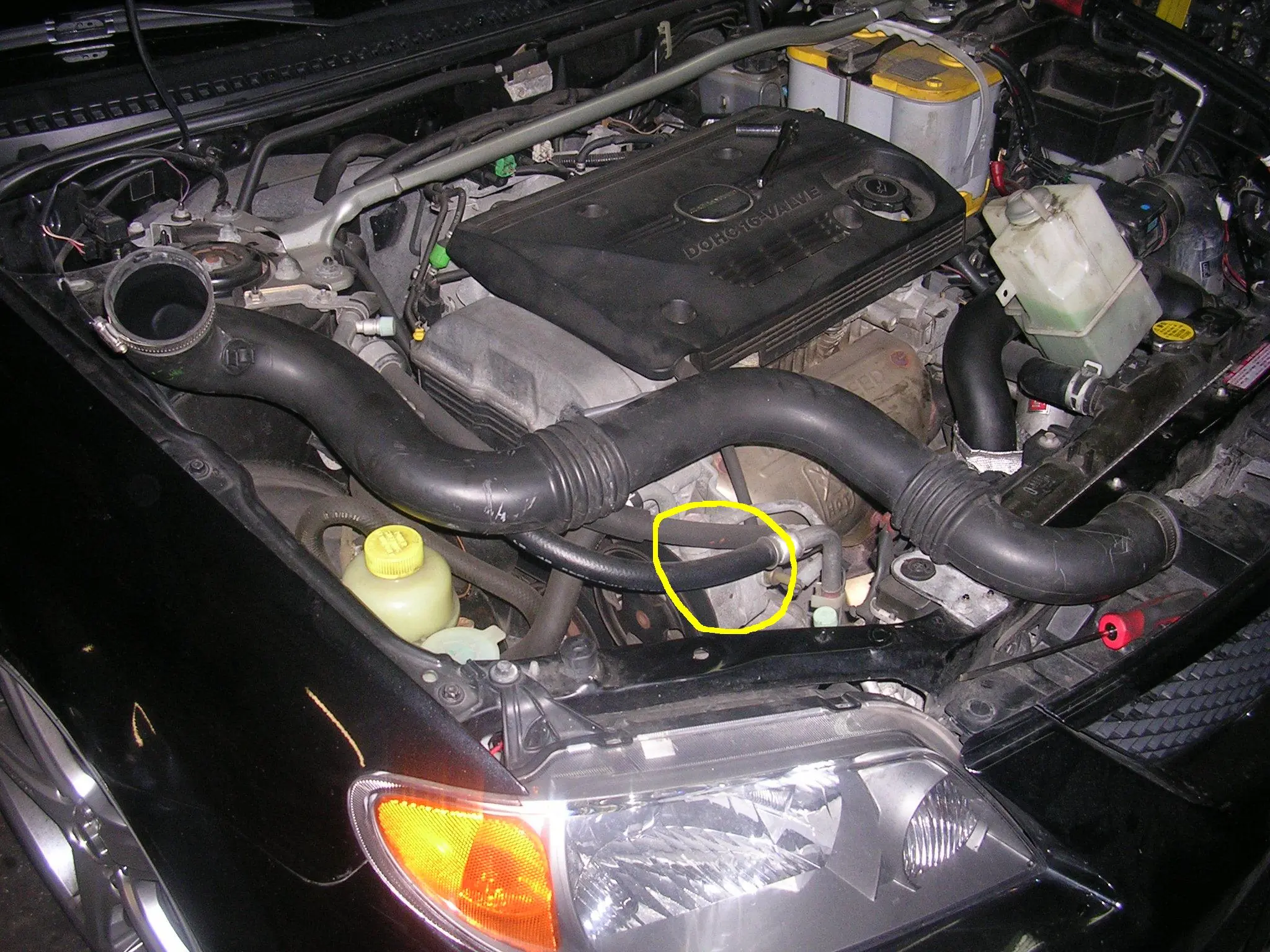

lmao of course not!!! I will leave it then... I am worried becuase it looks like
its leaking alittle.
so I take these devices go bad when they start to leak if so one should not
repair just purchase a new pump?
repairing can be just as much as buying a used... good part.. much easier to replace, then to rebuild it.. plus pams always give a warranty with their products
Thanks I couldn't find it for my year on that web site but I will continue to search...
so its not the pump?
u might be able to shoot down to Napa and get some lines made.. they make pressure fitted lines.. by the look of that pic.. it looks like u circled the A/c line
its not the lines I put in new A/C lines becuase the prick that install my 3 inch
DP damaged them... after replacing the a/c lines I cleaned the fluid off the
ps pump and it return after driving..
oh ok.. def.. in that situation, check to see how much new pressurized lines would run.. shouldnt be too pricey
