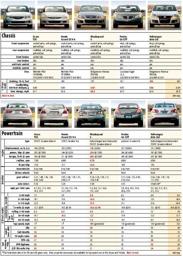

Car and Driver:
0-60 5.4
1/4: 14.0@99 MPH
