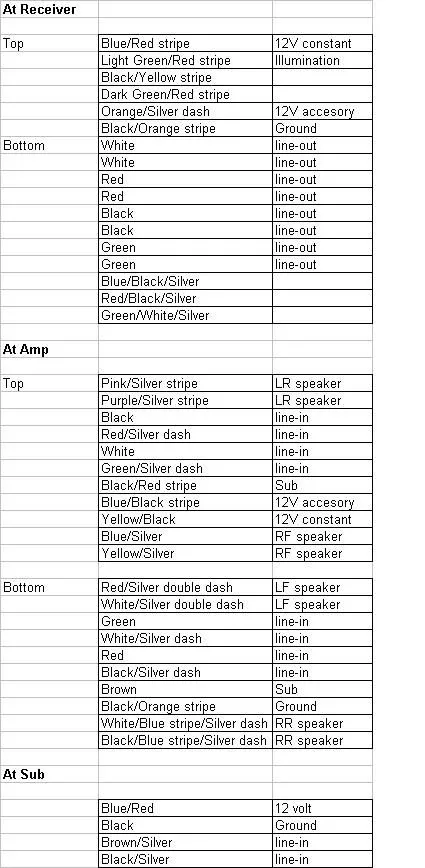

thanks to another fine forum member, I was pointed to this...
killer is, my powered sub has a seperate wire ( yellow ) for 12V constant, and a blue wire for remote on/off. So ..... I connect my sub's yellow wire to the blue/red, but what do I do with the blue remote on/off cable?
You will have to run it to the 12V accessory wire that is at the amp under the passenger seat and splice it in there.
ta da!
Using that chart, and using these instructions below, I got my sub all hooked up. Wasn't too hard but I could friggin kill the moron that decided to stick the amp under the passenger seat, and kill him again for not putting any slack on the cables going to it.
