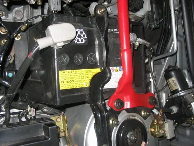

My manual doesn't have anything about water levels in my battery, all I see are 6 big plastic screwheads flush with my battery -- do I open these to check the water levels? I'll try and post a pic....
A normal battery configuration has generally six cells. My P5 isn't here at the moment so I can't check it, but the screwheads should give access to the water levels. Some batteries have clear housings so you can see water level, others you just look inside of. If it looks like there's more than an inch or so from the top of the battery to water level, then you might want to add some. Most car manuals aren't going to mention anything about water levels in batteries.
You can check the level on a stock P5 Battery without opening the top. The Cell is made out of semi clear plastic...
