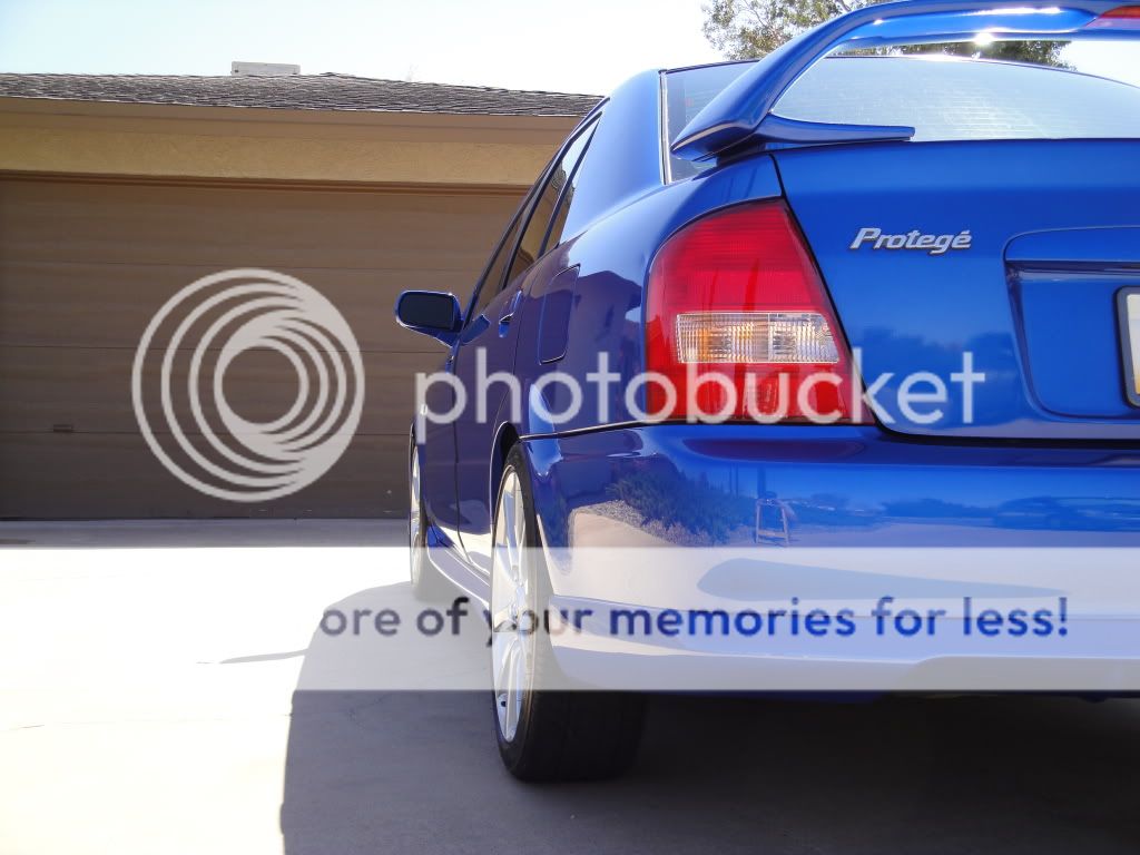

I have a bunch of pictures before and after but none of them came out very well, this is after:
Flush with the car but the wheels still tuck under the fender at the top.
