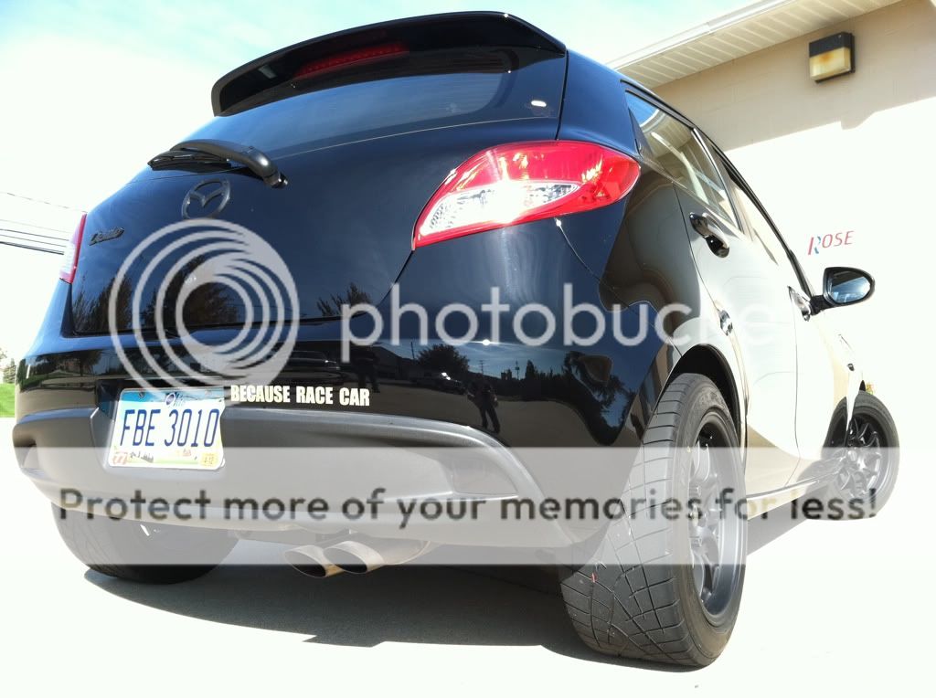

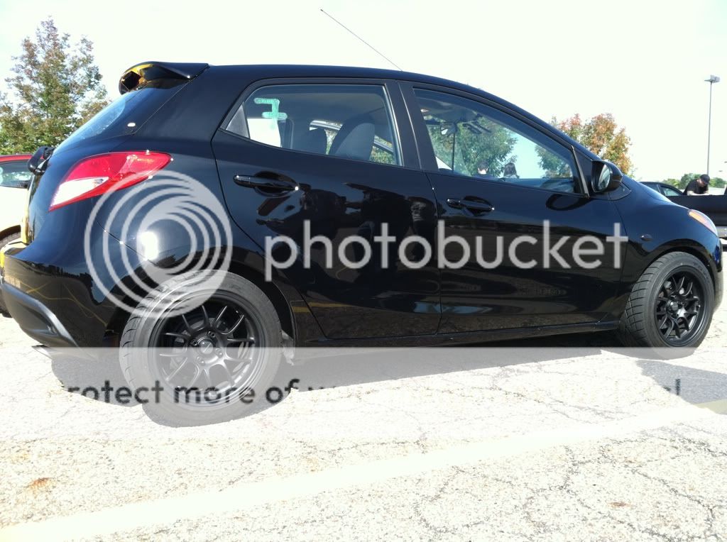

Posted this in the official Mazda 2 wheels thread but might be helpful to have in here.
949racing 6UL
15x9" +36mm offset
Toyo R1R
225/45/15
H&R Sport Springs
Need a ~3mm spacer in the front to clear the strut. Front pokes a little bit, rear is damn near flush. No rubbing at full lock that I've felt or seen. On big bumps/dips it's enough to slice the tire so it will need at least a fender roll, front AND rear.

Wow, just WOW! Black on black with those black 6UL and monster tires are just badass! Do you have any other mods (engine or chassis-wise)?
Just wait for those Koni shocks to be on sale and you will have a mean little corner carver!

I lowered it on H&R Sport Springs and added the Corksport torsion bar in the rear... that's it besides a muffler.
