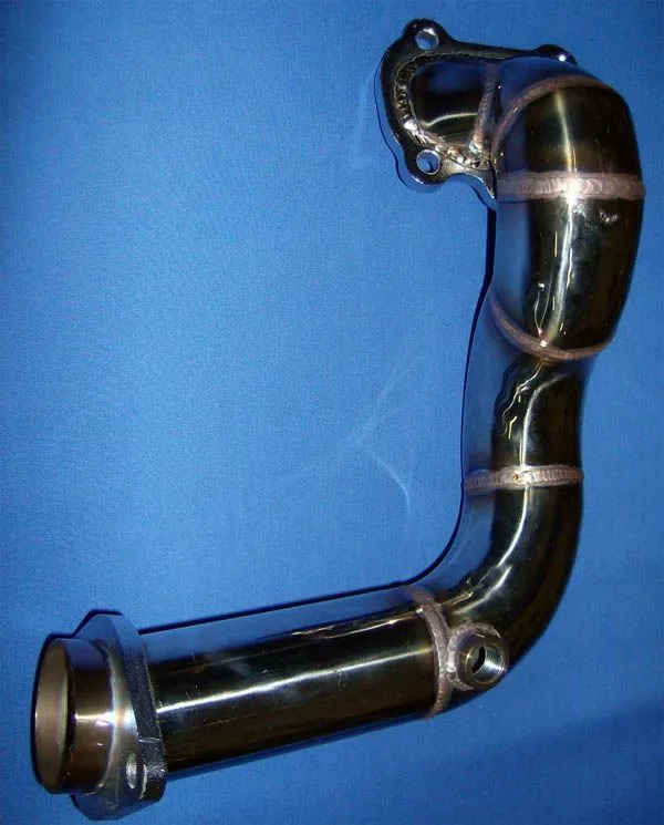

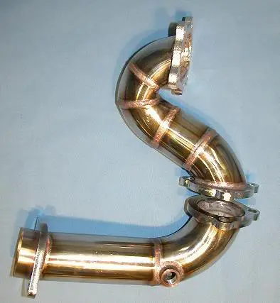

On the old design, where's the O2 bung, on the "s" or on the "j" piece?
Here's the 2 versions as you can see the bung is on the lower section "j"

Those are both the Corksport downpipes, the first version is the one piece and the second updated version is the two separate pieces. They are hard to find these days.
Crap. Yeah I acquired the first piece for about 10$ on offer up last year. If you know of anywhere to find it I'd love you forever.
I know someone that has the J pipe but I don't think he wants to sell it. I will ask. Otherwise like I said, they are hard to find. Best bet would be to put up a feeler on the facebook protege part groups. $10 is an amazing steal, you should be happy enough with that. That would easily go for $200 online.
That is awesome yeah the guy had no idea what it was and it looked well built to me. I appreciate you reaching out for me I just have been trying to get a suitable j pipe for it and really don't want to weld anymore without a flex pipe. I found a couple of tri bolt flanged pipes that don't have flex pipes and they were like 2.35in or something stupid when I actually put them on. I can tell the difference. Too much back pressure not good
