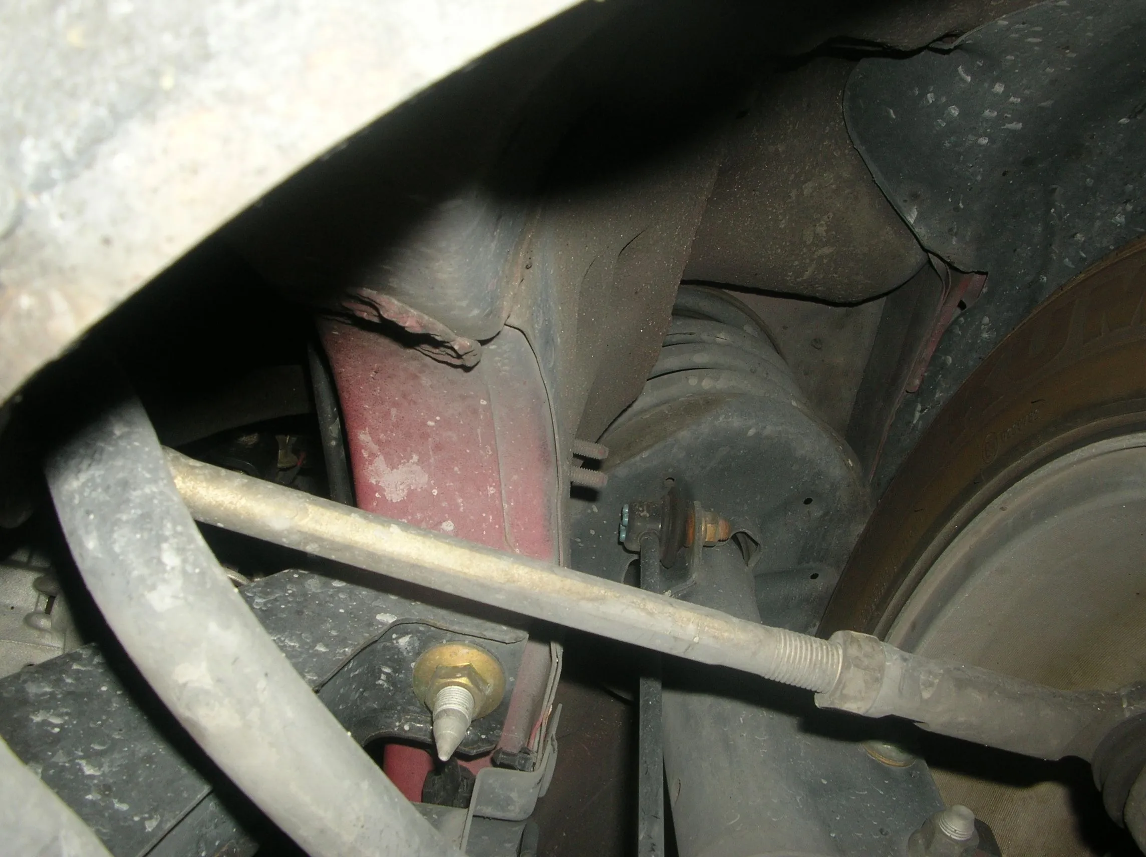

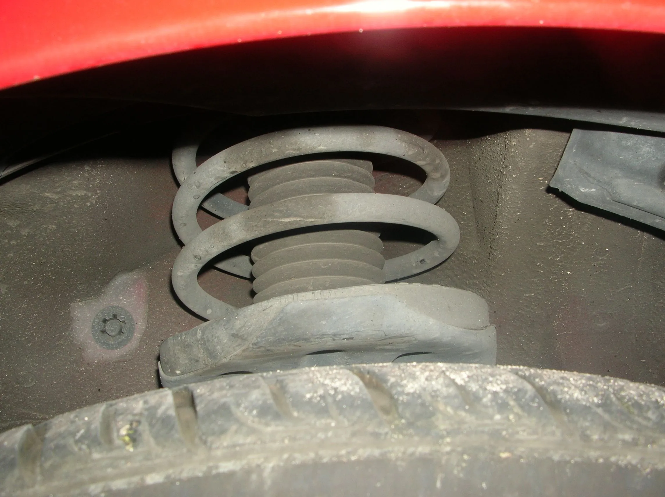

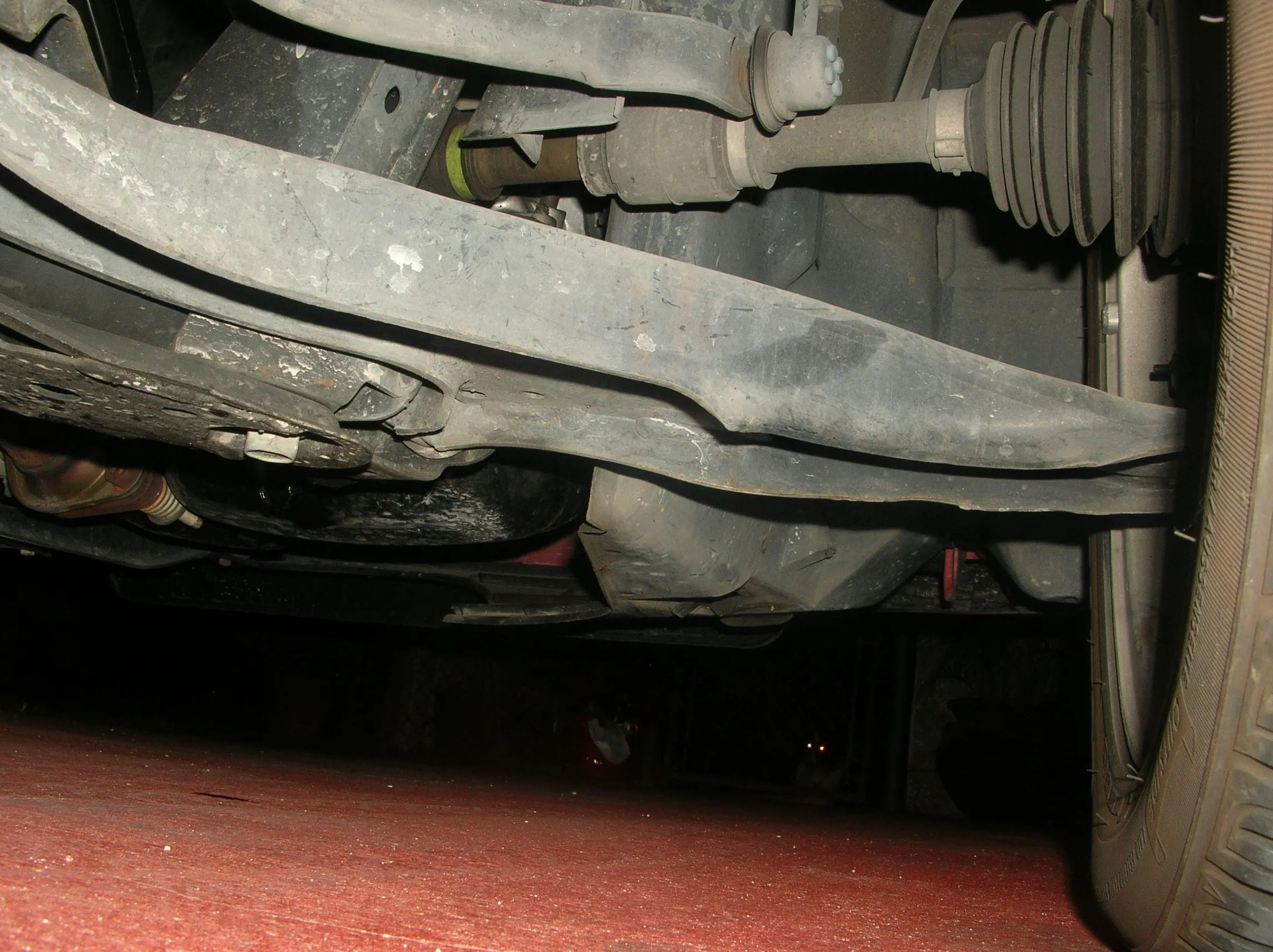

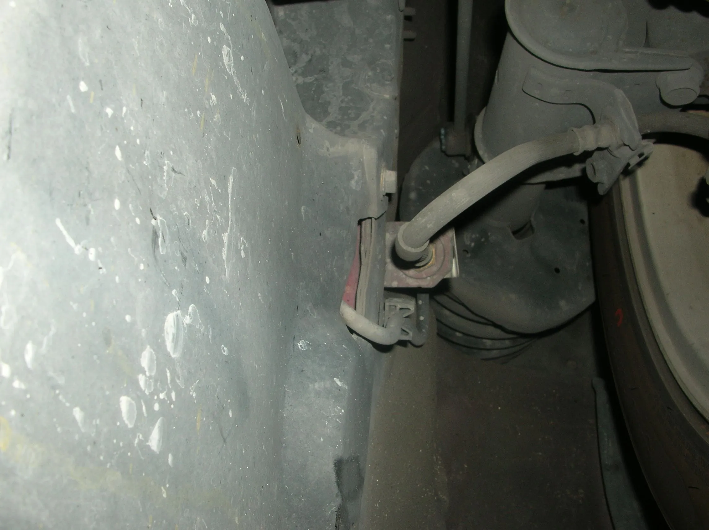

well mine doesnt look as bad as amaff the wheel isnt pushed back touching the body like that ill see if i can take some pictures
I hope for your sake it's not. But ya, jack the car up and get some pics of the damaged corner and lets see what u've got

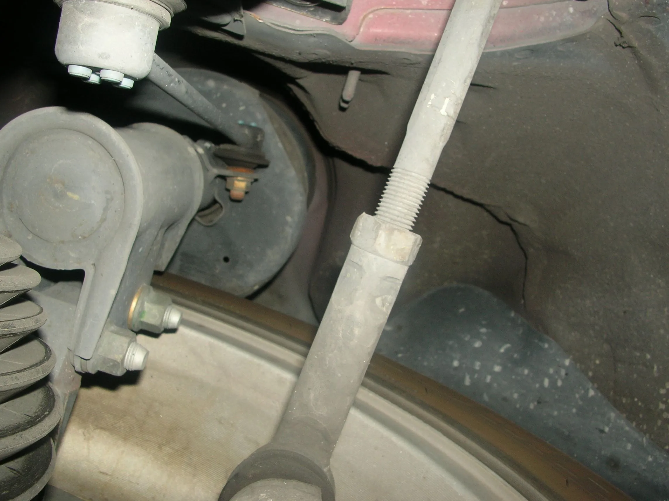

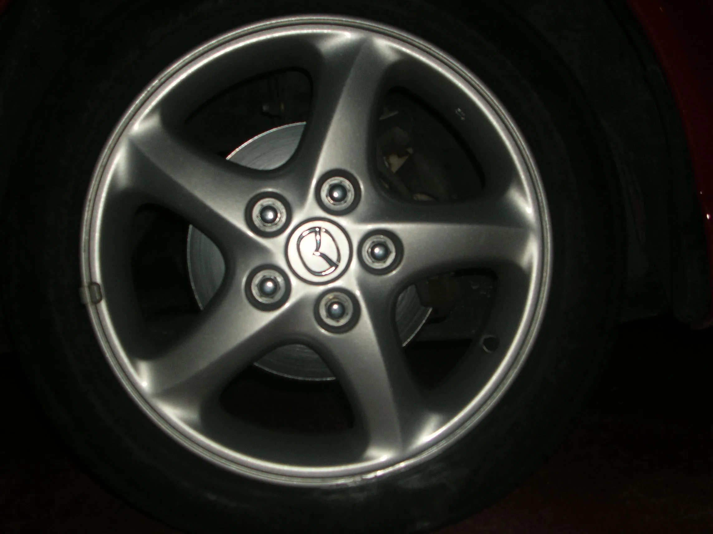

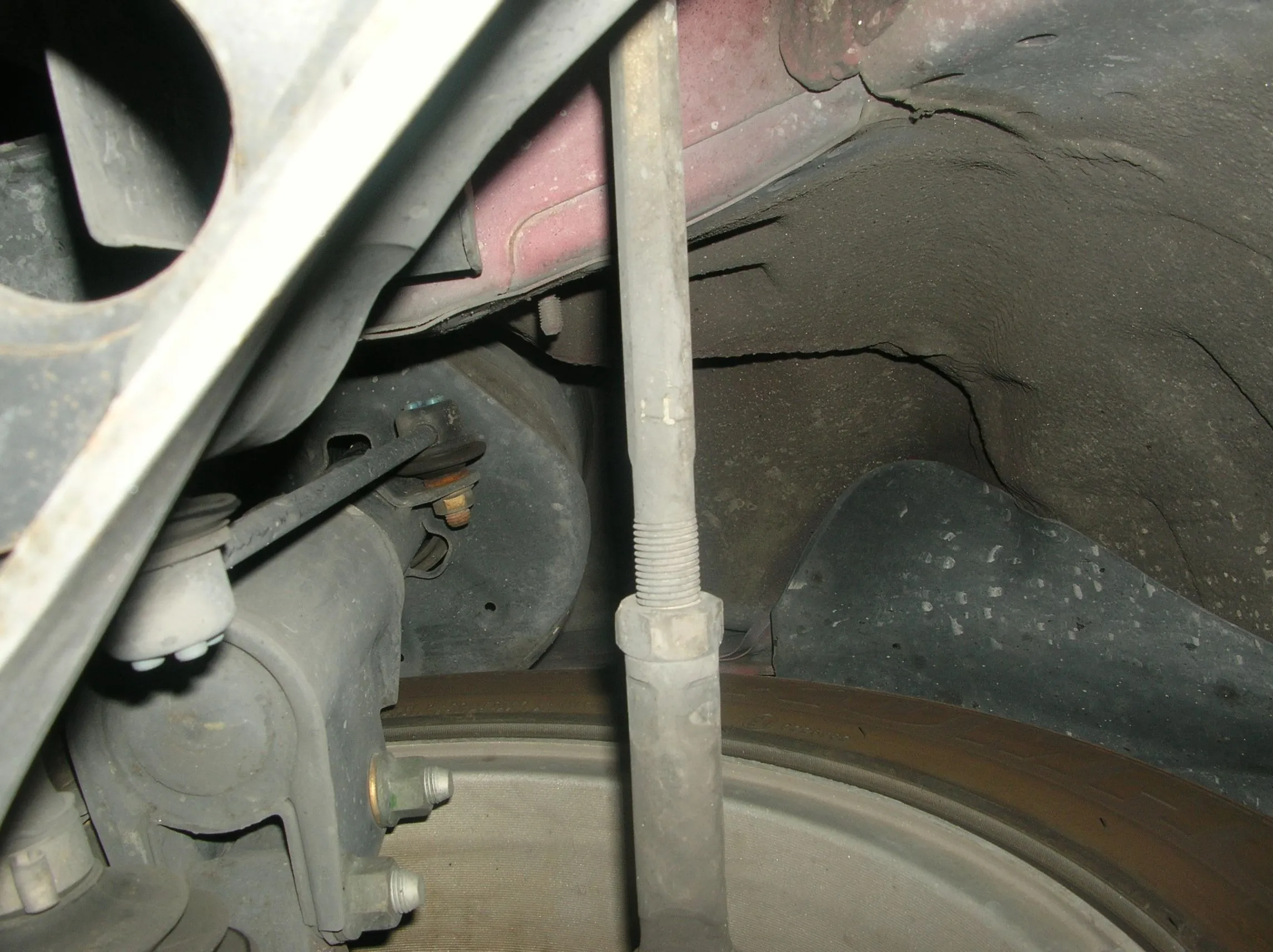

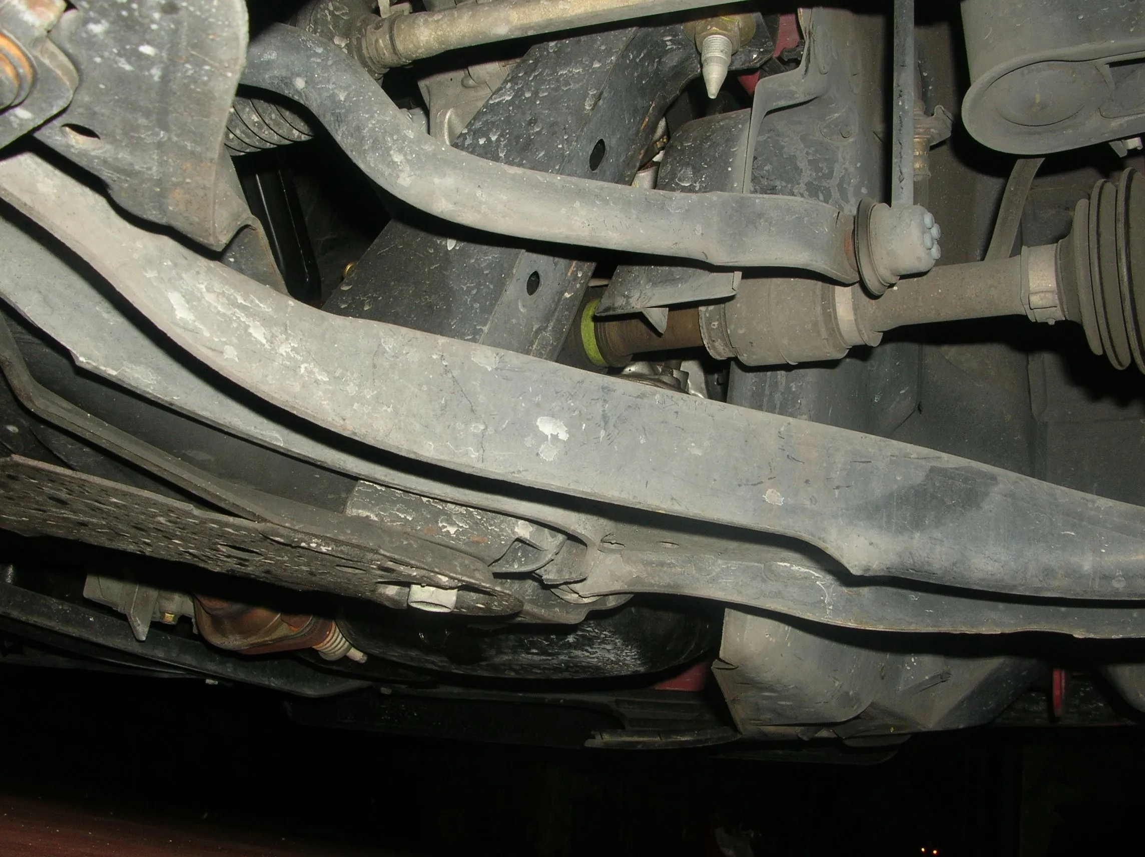

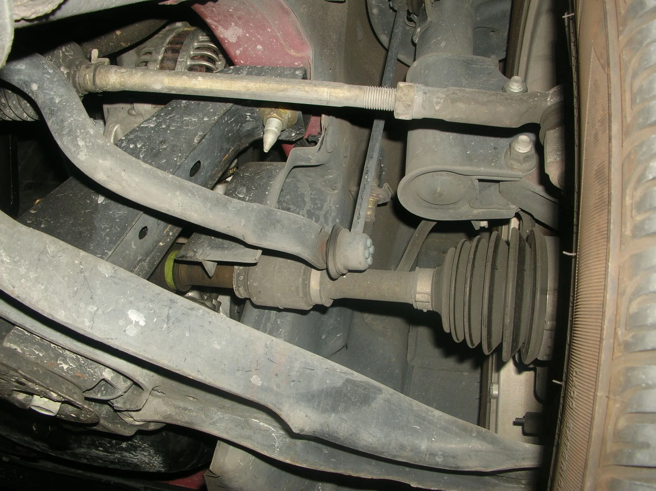

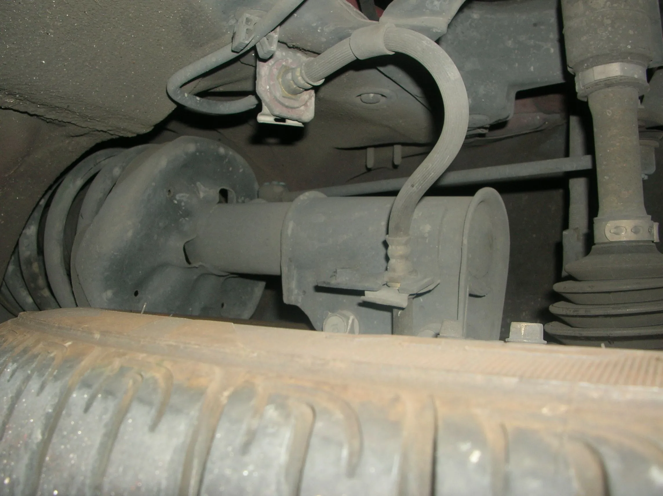

well i took some pics without the car jacked up let me know if you guys can see anything from the pics i took
heres some more
