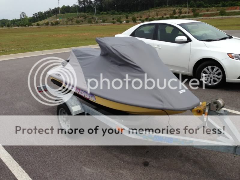

My wife and I just purchased our first Mazda, we picked up a good deal on a used 2013 Touring CX-5. I will be doing some light duty towing from time to time and would like to know if I should be shopping for a class 2 or class 3 hitch.
First, I understand that the car should not tow above its listed max towing rating (2000 lbs GTW) and I have no intention of doing so. Currently the largest thing I tow is a Seadoo XP and trailer, with fuel weighing in about 600 lbs, although in the future I would like to have 2 of these on a double trailer assume 1500 lbs.
