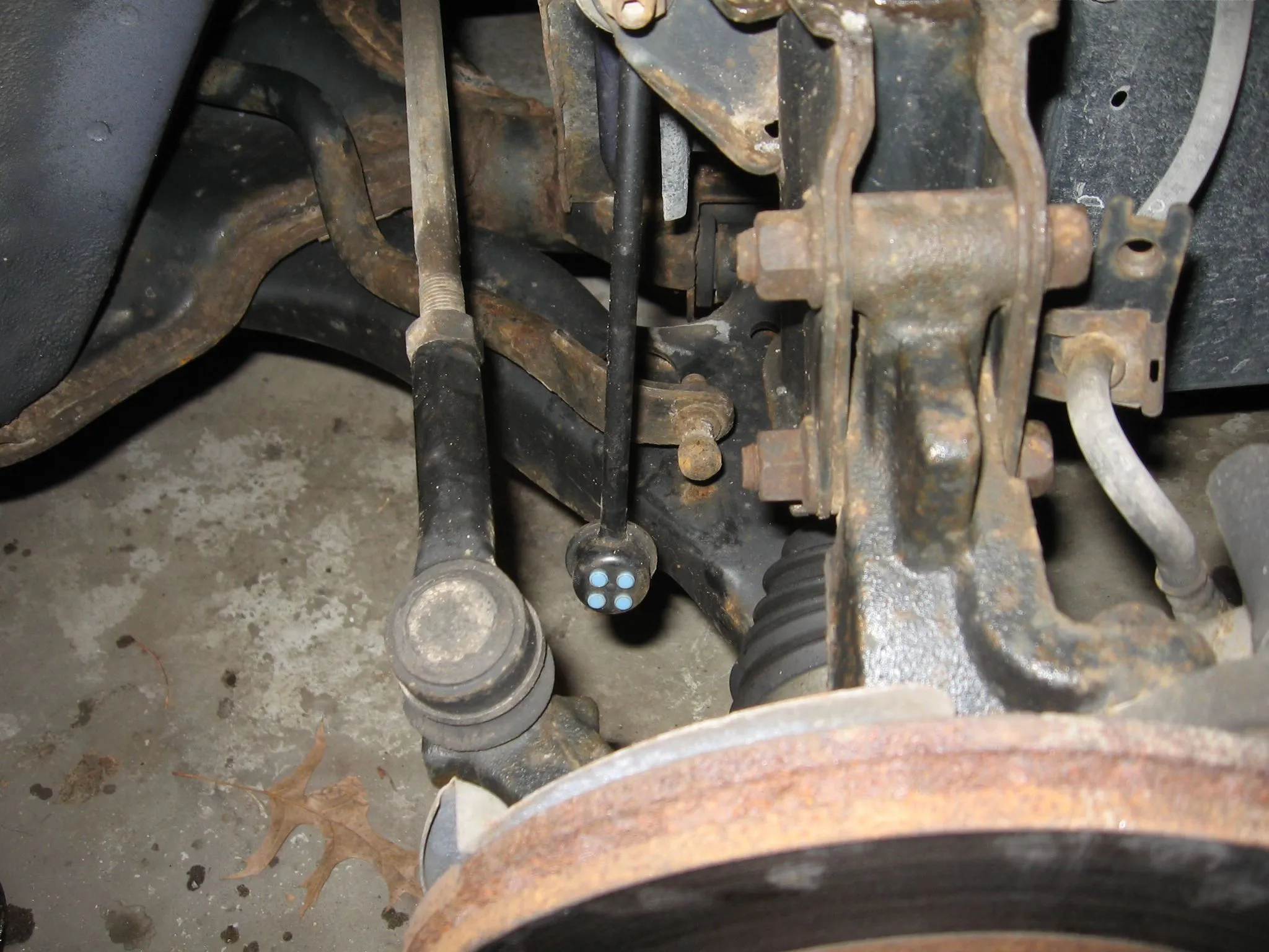

Think I found the reason for the funny handling of my '00 ES on rough roads. This part is not hooked up -- think it is called the stabilizer bar link?
Picked up a replacement at Autozone. Looks like a simple job to pull and replace, just two bolts. Any tips from someone who has done it before?
make sure to have an hex key that fits the threaded part and a wrench for the nut. It will make your life easier and dont forget some pb blast overnight to help.
This. I helped replace a pair on a P5 once that was not nearly as rusty a suspension as your's and still ended up rounding the stupid hex bolt. Ended up having to use a combination of hacksaws, wrenches, and a pipe wrench to get them off. Hopefully you'll have better luck!
yeah i have had a couple of mine be at that point,I just used a dremel and cut through the thing and popped it out that way.
Just finished doing the sway bar link. Even after PB Blaster and a breaker bar, ended up having to cut both top and bottom! The one on the sway bar still wouldn't give (didn't quite get all of the wide flange on the ball side), so I had to grind on it a little bit with a Dremel until it finally loosened up. Took over an hour to get the old one off, the new one went on in five minutes. The other side should go much quicker, I'm going straight to the sawzall!
