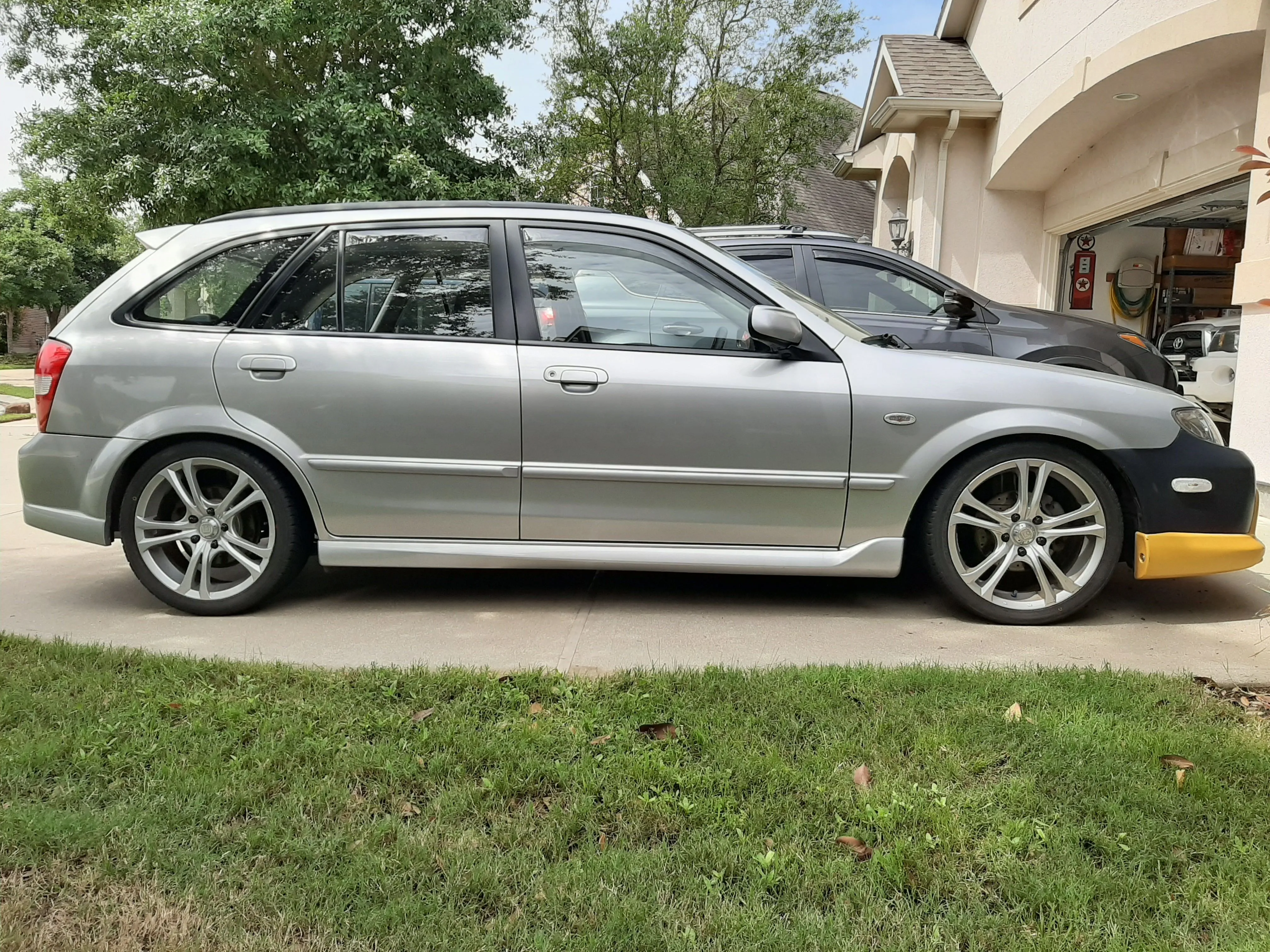

What grille is this from??
Grill is CDM (Chinese, not Canadian) , also have German wiper arms with the little wing on driver side, 323F badging, JDM tails, Tribute nozzles, Familia footwell lighting kit, center console extension - Canadian?, JDM cupholders, M6 rr wiper arm, 03.5 MSP lip, MSP vc/cover, MSP door sills, 1.8 coils, MS embroidered mats............all kinds of other Mazda oem parts, lol................looking for the battery cooling duct from Middle East/African cars, Etude IIRC..............What grille is this from??

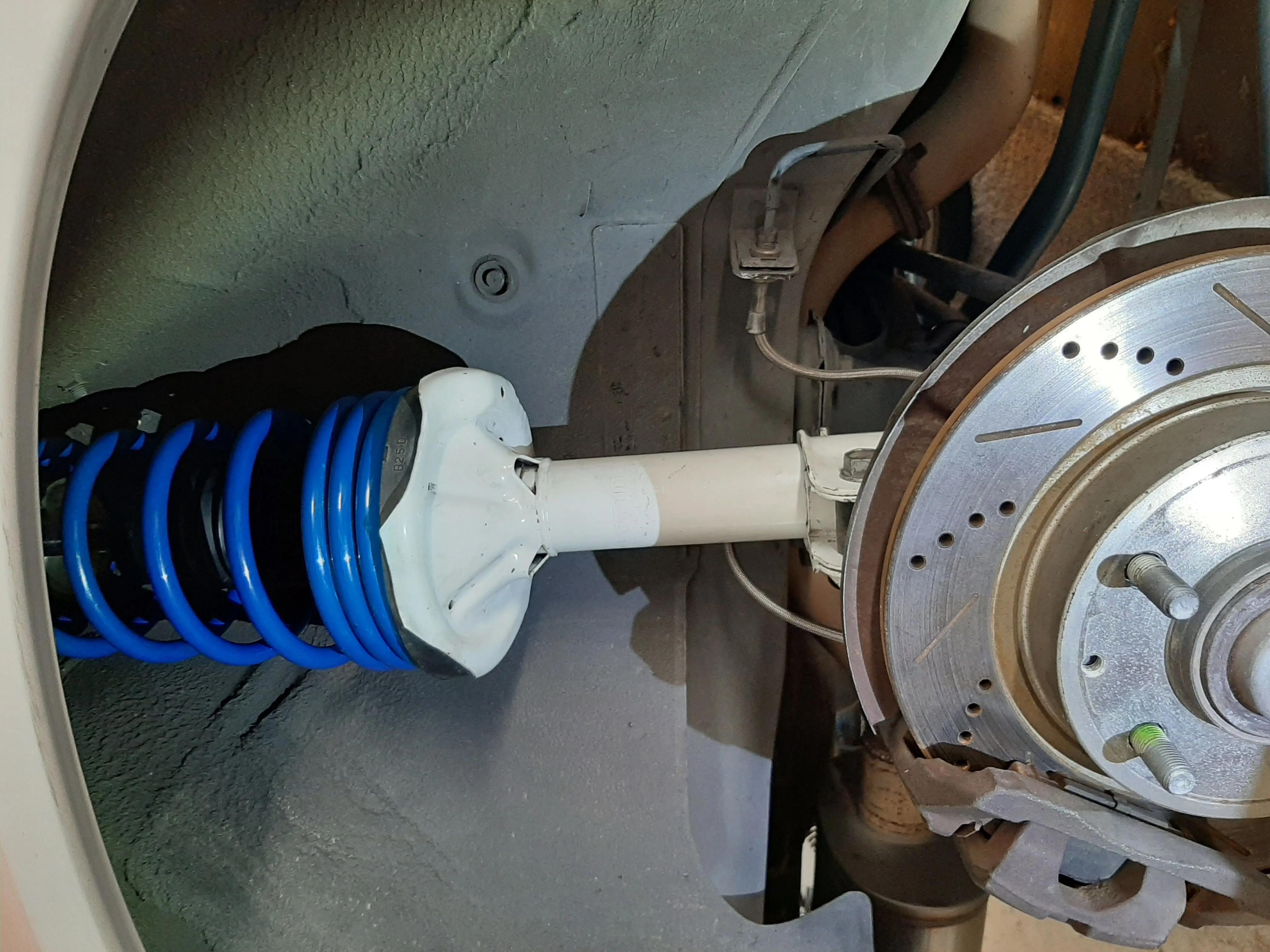

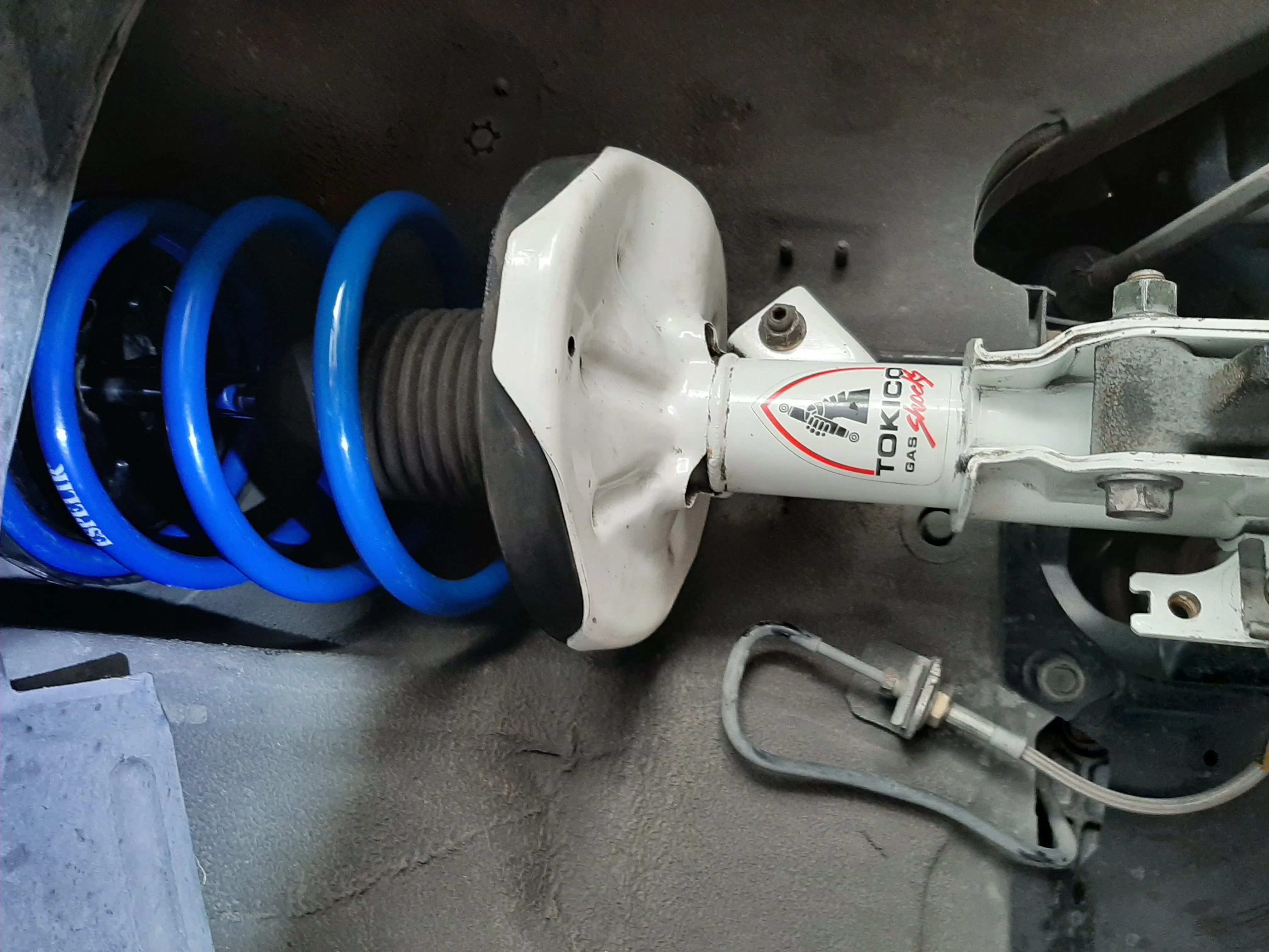

Look at MSP springs, they do like .75 drop IIRC, and then there are Tein H-tech springs that lower 1.3 front and .9 in rear. Those might be something for you to chk out. There was a great thread from back in the day that had all the brands with spring rates and lowering amounts but that chart is gone from the thread. I just read thru 20 pgs of info to find out what I needed..........Espelir are 179/157 and 1.5 all around. Tein S-tech were 190/170 and front dropped 1.9 and rear 1.4This is all quite interesting to me as i'm on all-stock suspension and sorta kinda looking into budget, quality upgrades but also not wanting to compromise on daily drivability, since it's my only car and I drive A LOT. I love my car as-is so i'm trying to get things up to a clean, OEM status first though.
With stock suspension and 195-series tires, my car rubs with people/cargo in the back, though that's with aftermarket (trashy) lower-offset wheels. Even unloaded, the front sits higher and it bothers me.

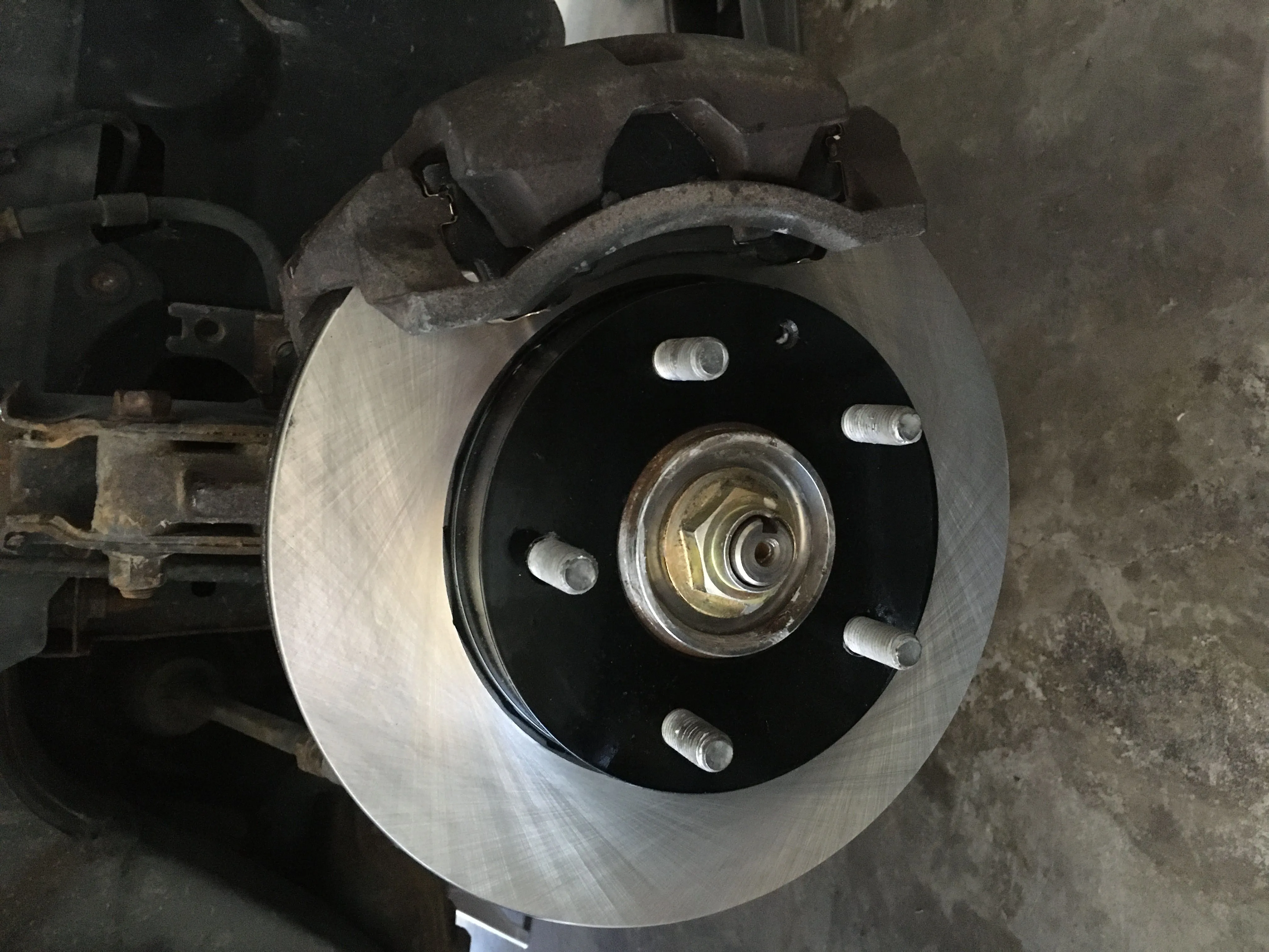

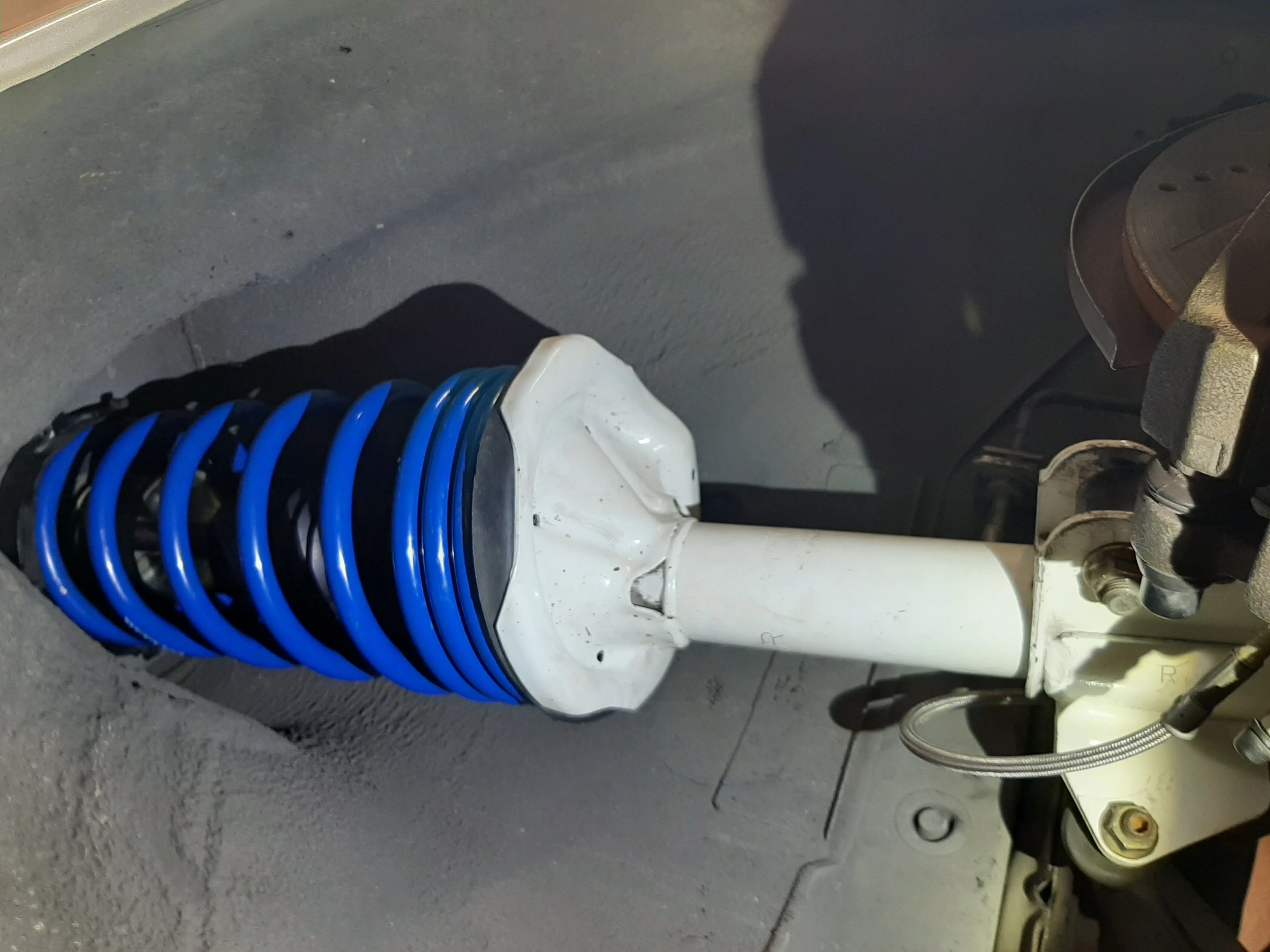

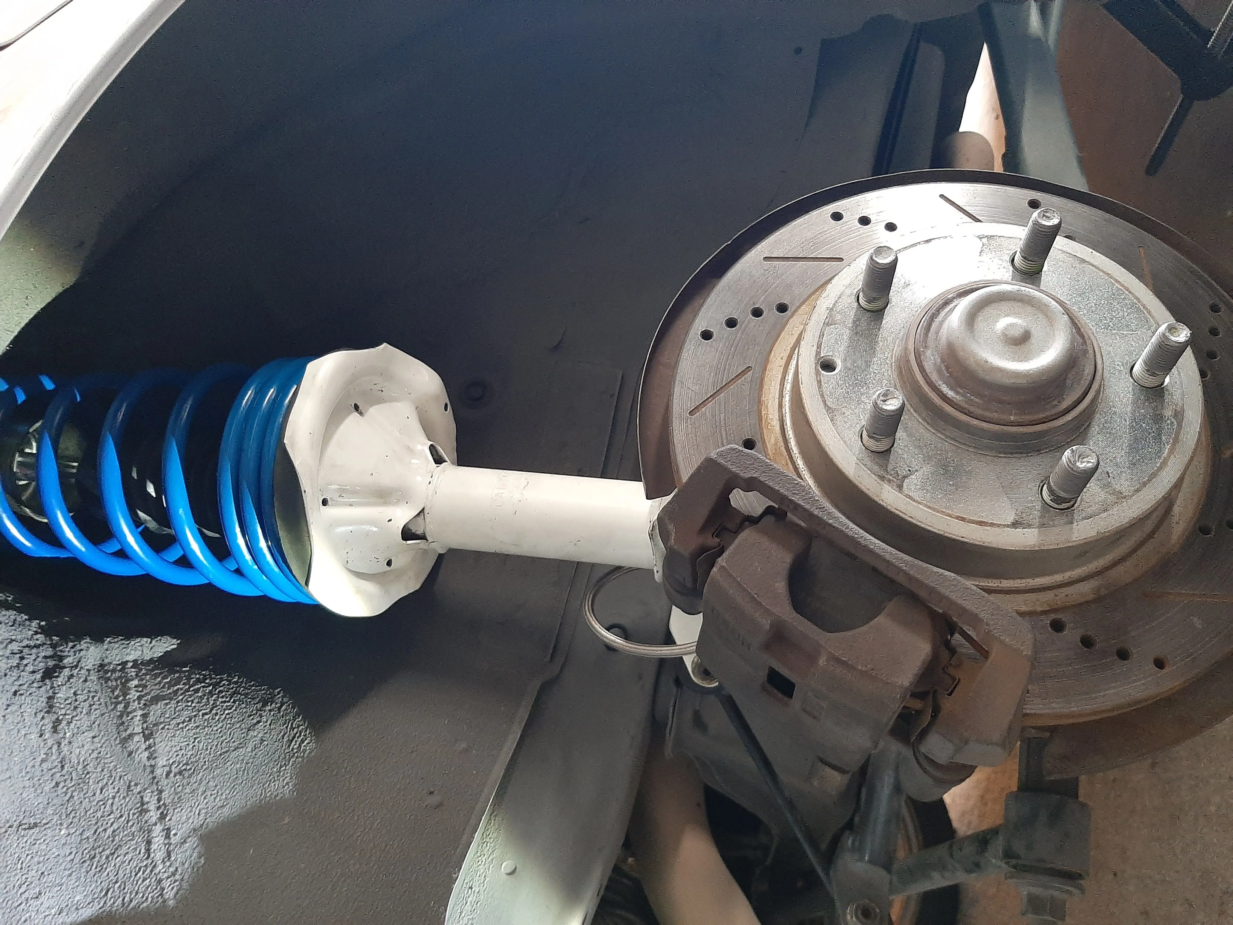

Fresh and clean, ready for another decade of cement surfing. Goodridge ss braided brake lines holding up nicely........................dunno why pics twisted sideways.
I happen to have a set of Tein S-Techs that I am not using. They were tested on my vehicle this week during my coilfest and I decided to go with the Espelirs. Nothing wrong with the Teins, just like the ride height of the Espelirs better, that and the higher spring rate on the rears. Not sure how bad shipping would be on them to even make it worthwhile for either of us. They are just gonna be "inventoried" here on the parts rack otherwise.This Forum Rocks! I too am looking at the Tein kit...
I agree that a MSP will be JUST as old as a P5 and a lot more thrashed....
So new equivalent seems to be the route to take....

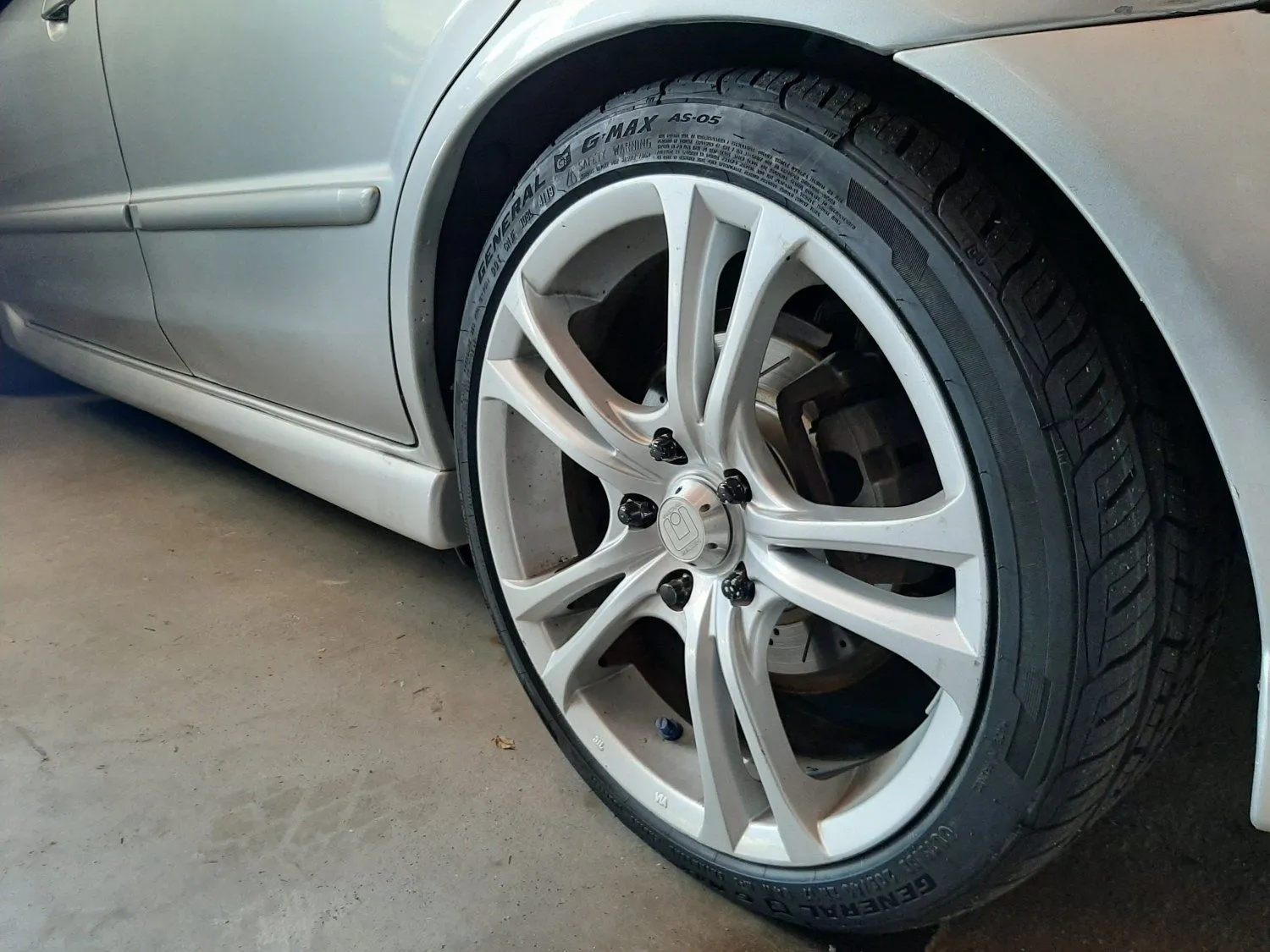

Some fresh new General G Max AST05's and reigned in that passenger side front toe being out with an alignment..............tires & alignment added almost as much ride comfort as the fresh coils did. Between the 2, much happier than before. Coils had 15 yrs of use and tires were 12 yrs old but still more than half tread left. Very noticeable and appreciated difference in ride comfort.
