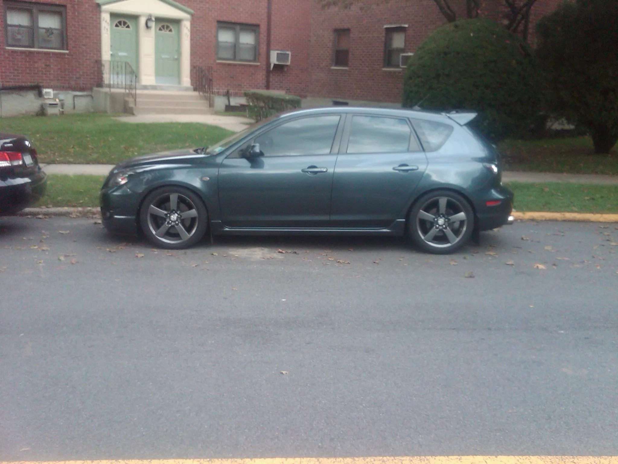

got my alignment done today. suspension work is finally complete
attachment.php
looks the part! Hows the ride and handling. get the preload sorted? what are the instructions for yours? did you have any trouble with sway links?

Threw on my H&R Springs this weekend and gave her a wash. quickest install so far... Both fronts and rears in 2hrs complete. Just waiting on my SBC rear camber arms to arrive so I can throw those on and get an alignment.

Thank you! Maybe its just me, but seems the front sits a little higher than the back, gap between tire and fender, backs are about even, almost no gap. Is that normal or do they need to settle a little? Will, you have HR's, don't you?
2 locals have h&r springs and they have a bit of reverse rake
i raked my coils the right way just to piss them off haha
@eric - preload was sorted out, no instructions, and CS doesnt tell you to reuse the bearing portion of the OEM top hats so that was causing my issues, no problem hooking up the swaybars, tho i do have more preload on the drivers side front than the right, since theres more weight (battery & transmission) on that side it sits lower when the coils are even

Yeah that looks exactly like mine. I don't think it's necessarily reverse rake, but rather just looks that way because of the way the fenders are on these cars.
