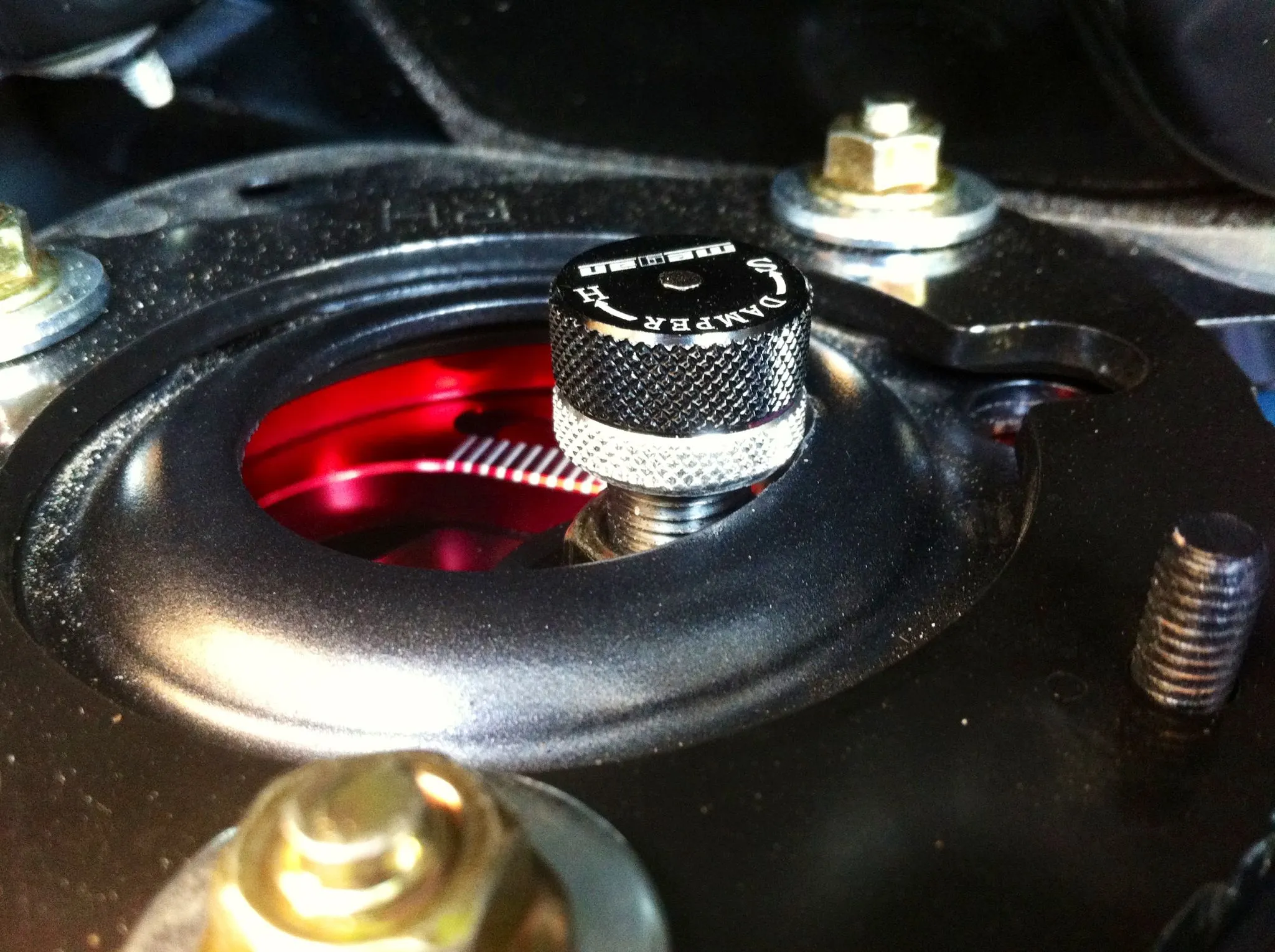

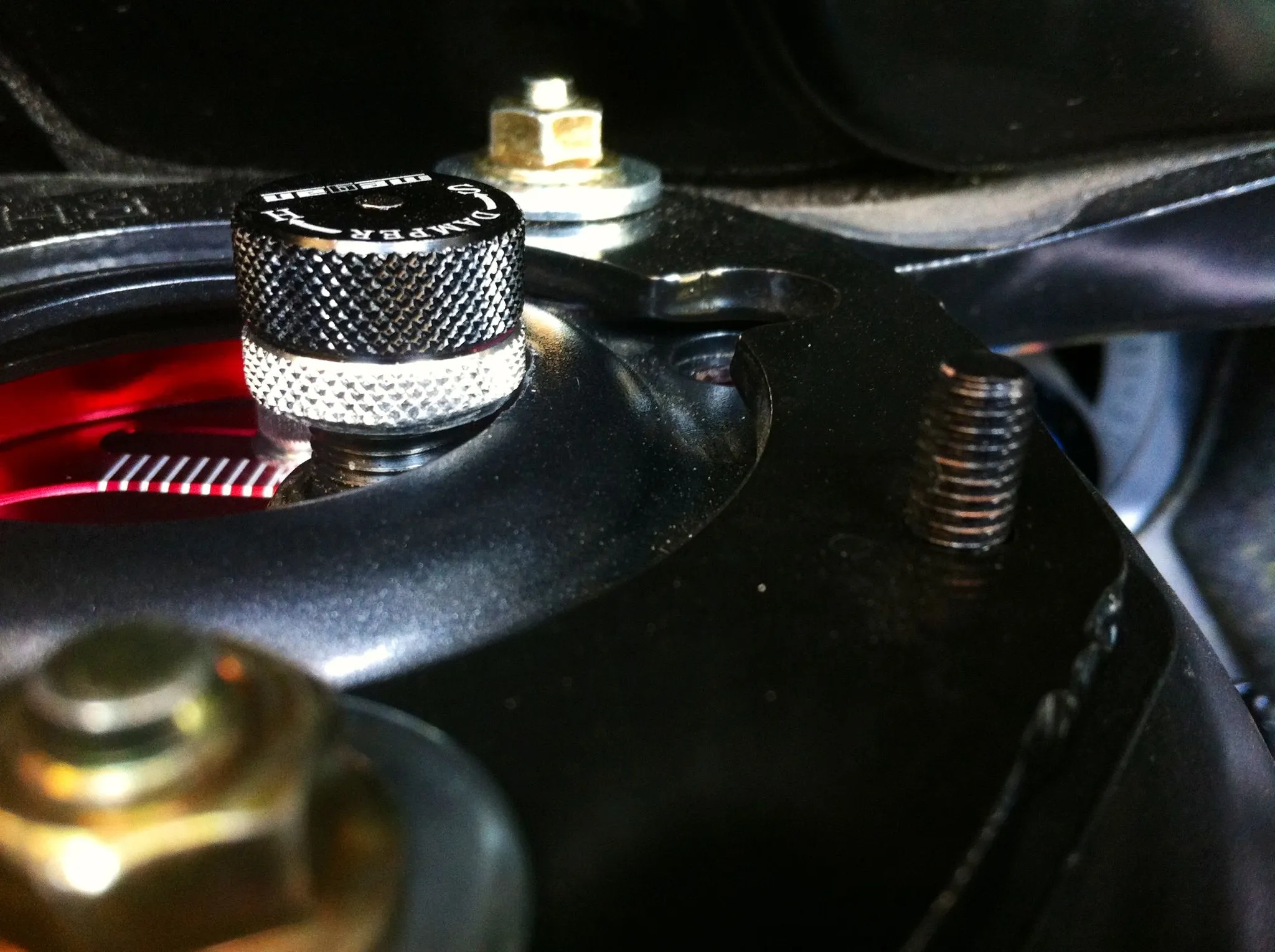

Is it safe to be driving around like this, my dampening knobs are really close to the strut housing. Pretty sure it's rubbing against it, but I don't hear anything. I have my camber plates set to negative.
View attachment 203229View attachment 203230
in theory there shouldn't be any movement there. if it were me, i'd try to move it out a little bit, or cut back the strut tower mount.
