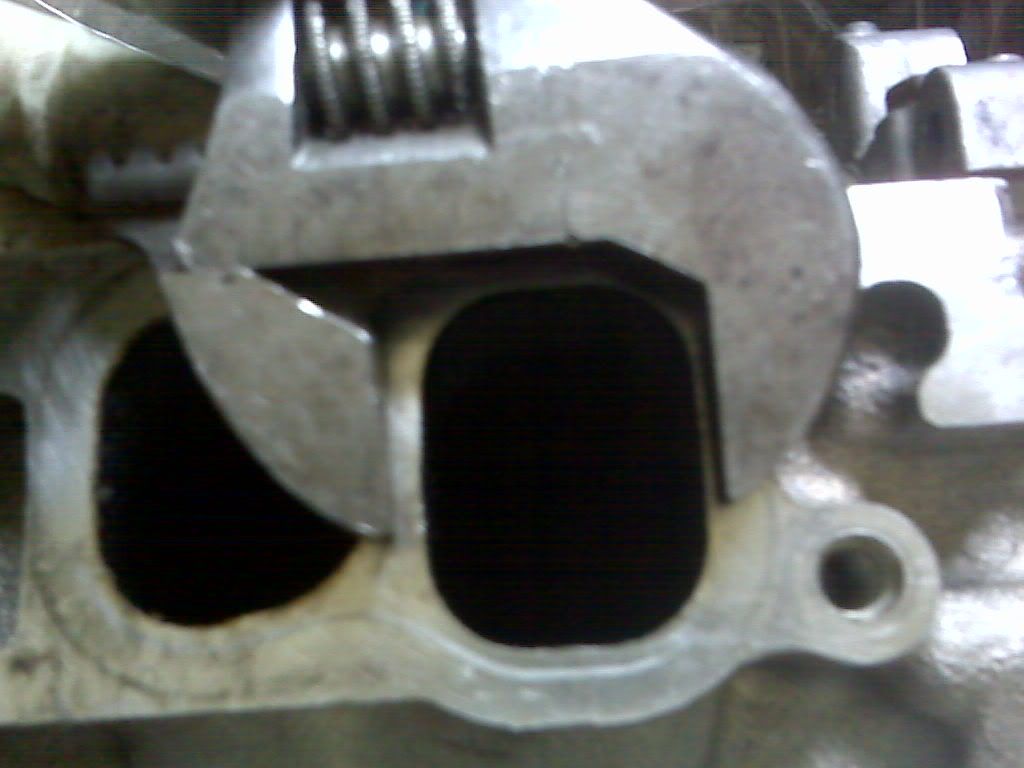

HEAD BEFORE (sorry i didnt have a dial guage but i think you get the point)

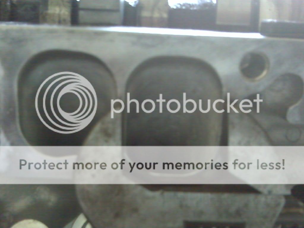

HEAD AFTER

VERY nice! cant wait to see it back together and tested!
Mmmm beefy snail. :)
