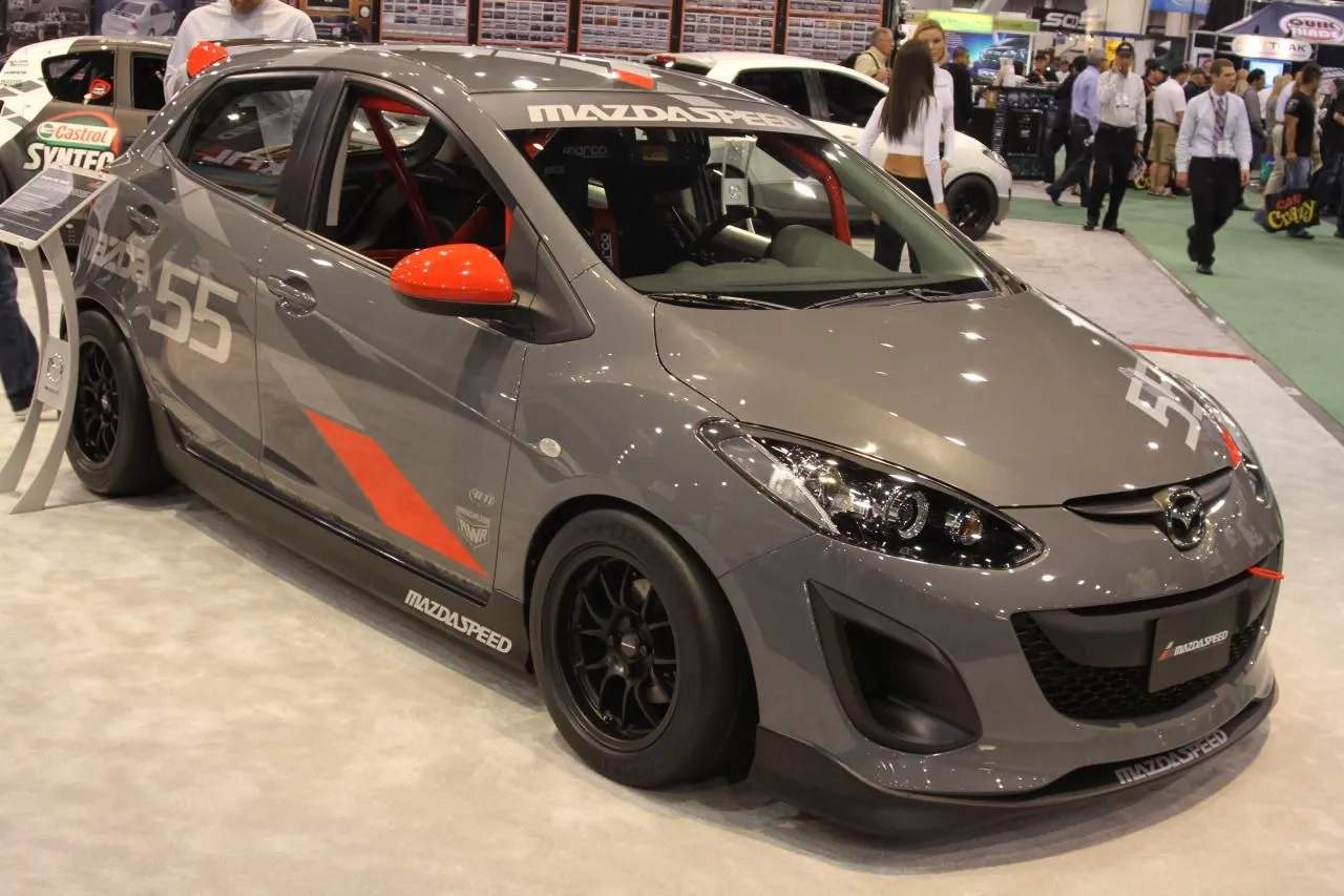

225/45-15 on 15x9's yowza!

If everything goes right, I'm soon to be on 15x9's as well :$.

see what i mean? hotness. so is the 15x9 not doable without rubbing scraping and rolling fenders or what? those are 189 a piece. is it the tire that would be expensive? Oh and those come in at 13lbs each.

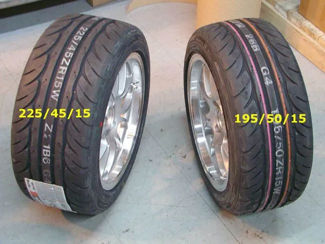

Yeah I like it, Im sure it will work no issues the tires diameter is 22.97 in and width is only .39 in wider than my daily drivers. Mine are way taller and dont rub. This is definately a Miata setup, my friends run these everywhere. However both wheel size and tire size are not as common so prices, choices and availability etc. Here is a visual.

At first I was going to get 15x7 6ULs, since that's the width CorkSport put on their 2 and I knew it worked, but now I think I'm going with 15x7.5s. Other people here have done it and there's no rubbing at all. You will get an advantage in unsprung weight with the 15x7s, but it's only a few pounds so it's probably not going to make a difference. Added contact patch will probably be more beneficial.
