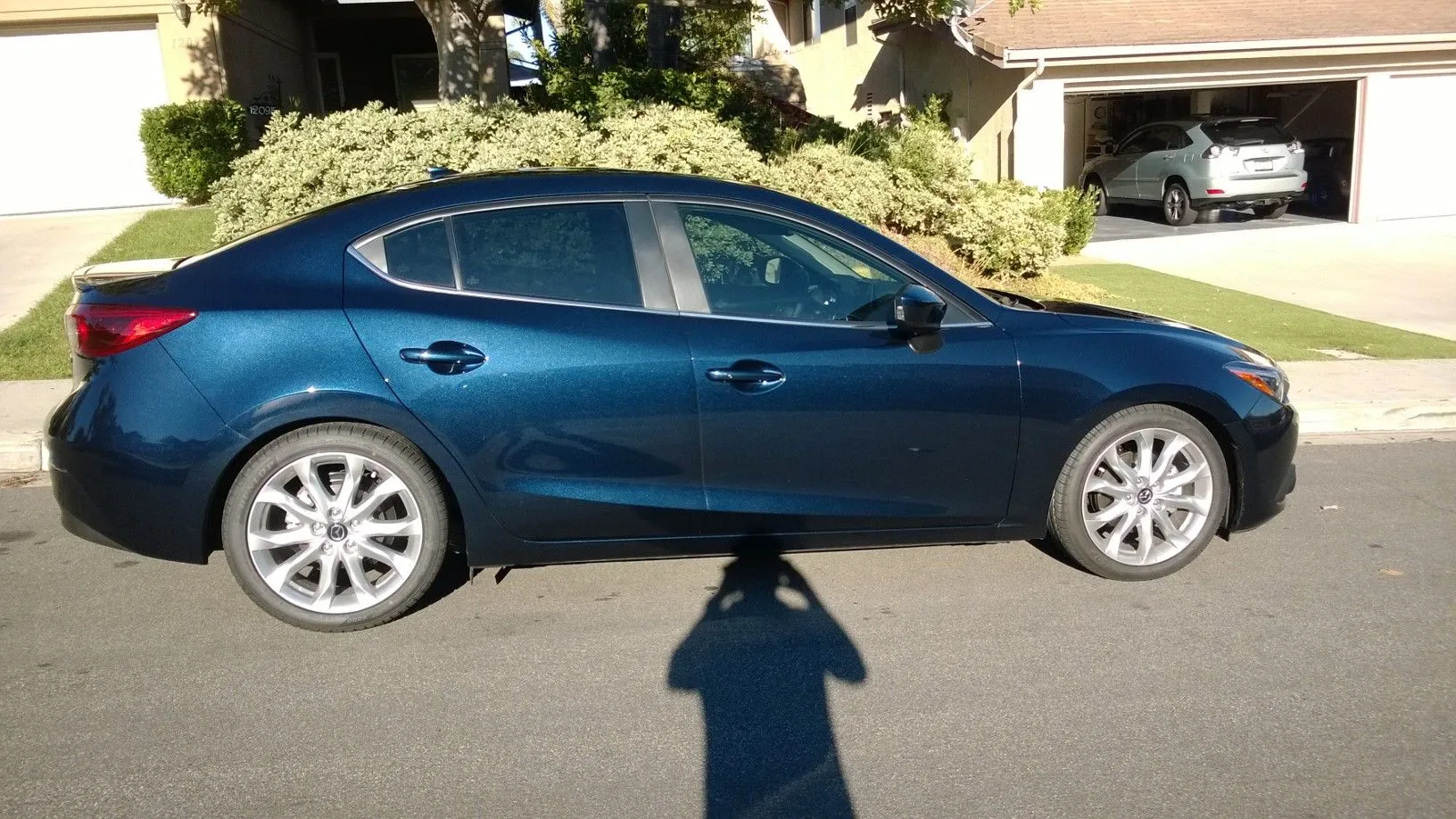

Although my preference was BC Racing coilovers and Swift springs, the $200 Eibach cost, along with a 10% rebate was just too tempting, especially when a Magnaflow catback is on the horizon.
Installation and Alignment: BeeLine Alignment shop, which installed Prokits on my 89 MX6 GT and my son's Civic CX. They have a guy there who's been installing springs and other suspension components for over 30 years. He knows his stuff. Total cost is about $400. The Pro-Kit includes shorter rear bump stops to replace the OEMs.
Ride height: See photo. Ideally, it'd be a bit lower, but with the OEM shocks, that is not recommended. Besides, the car does scrape on some exits to parking lots - not many, but another 1/2 inch of drop would surely result in many more scruffs. Overall, the look is good, but not Coooool! It represents a good compromise (see "Ride")
Ride: My MX6 GT originally had electrically-adjustable struts. If left on the medium setting, they would stiffen up when vehicle speeds reached a certain level. Otherwise, they were comfortable at normal driving speeds. The "sport" setting would make the ride "firmer", all the time. In other words - the best of both worlds.
The Eibach-equipped 3 rides like the sport setting - firmer, but not uncomfortable. Hard turns can be negotiated at a higher speed and with less tilt. No side-hopping has been noticed. Good Ultra-High Performance Summer tires will amp-up the G-loading.
Value: If the tire gap bothers you as it did, me, and you aren't concerned about driving on flooded or snow blizzard covered streets AND don't mind a bit firmer (and more controlled) ride, the Eibach Pro-Kit represents a great value.

Sorry about the giant photo. I took it with my new phone, a Nokia 925. The tires needed blackening, so that's what I did, today before cleaning the wheels.

after a few months of driving it what are you impressions? have the springs settled more?

After more than a couple months, the car seemed to settle a bit more. The front looks great, while the rear still has a gap, though not nearly as much as the OEM gap. Overall, I'm very happy with the stance and the enhanced handling.
The ride is definitely firm and the seat foam density makes it feel a bit more firm, but there is virtually no sway at all when making sudden turns. It feels like my MX5 with the Koni sports on 1/4 firm setting. There is no side-hopping while traversing a sweeping corner on less than smooth roads.
As I mentioned, before, I do have to take some parking lot entrances or exits at an angle, once in a while but do not scrape exiting or entering my driveway.

After looking at your pictures again. Eibach spring are on the list of mods for this semester...
