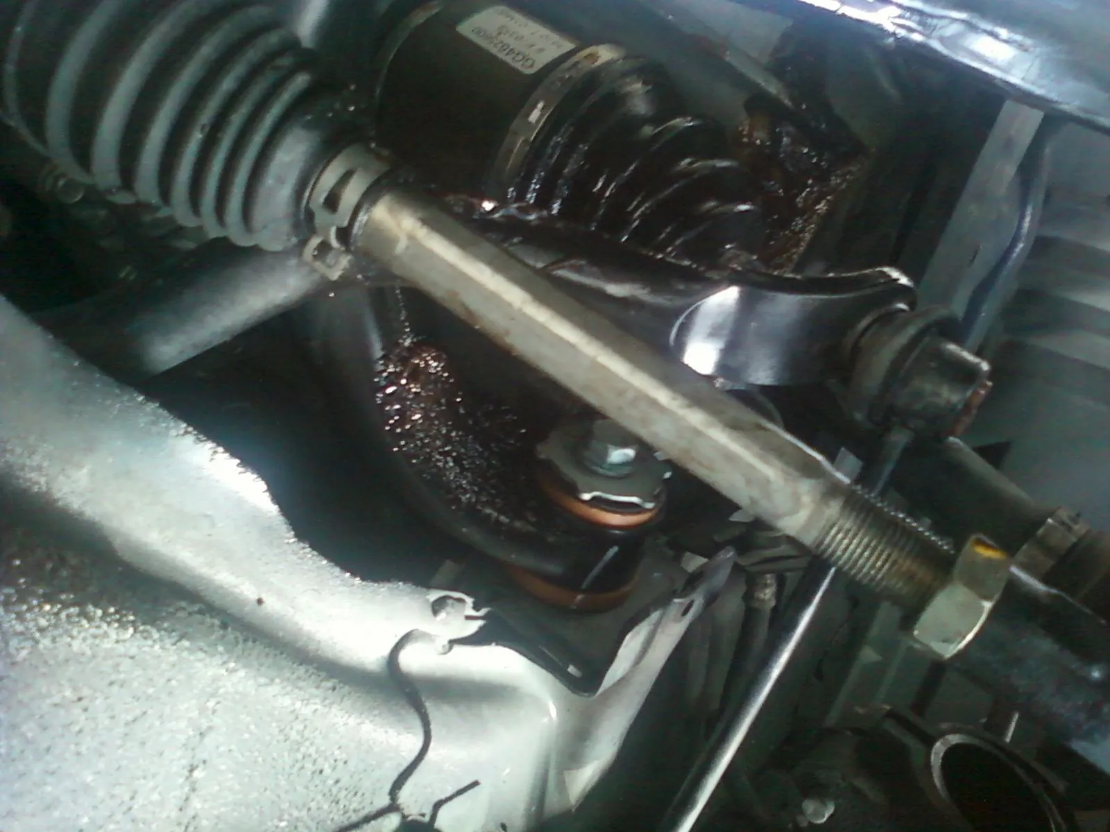

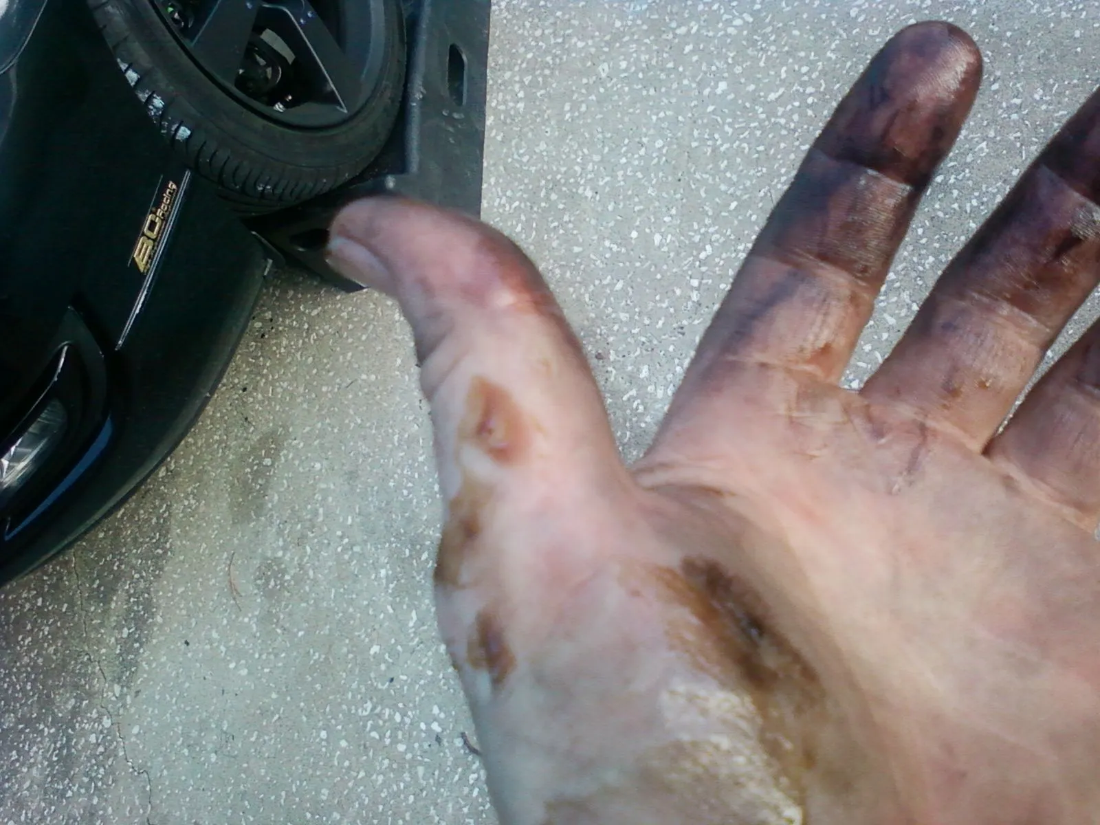

meicalnissyen : 06 LS MS6 07 BM GT (shell has been struck from the roll) May 2, 2010 #1 This has GOT to be a inner boot filure, but I can't find the hole (on the boot, jack ass) please check grease color on my had, and placement on the car Attachments Photo0366.webp 97.5 KB · Views: 189 Photo0363.webp 144.5 KB · Views: 179
J Jchouin1 Member : 2008 Mazdaspeed3 GT Nav May 6, 2010 #2 meicalnissyen said: This has GOT to be a inner boot filure, but I can't find the hole (on the boot, jack ass) please check grease color on my had, and placement on the car Click to expand... It's either going to be before or after the first bellow on your boot. mine tore in the crease between the clamp on the first bellow. Follow your spray pattern.
