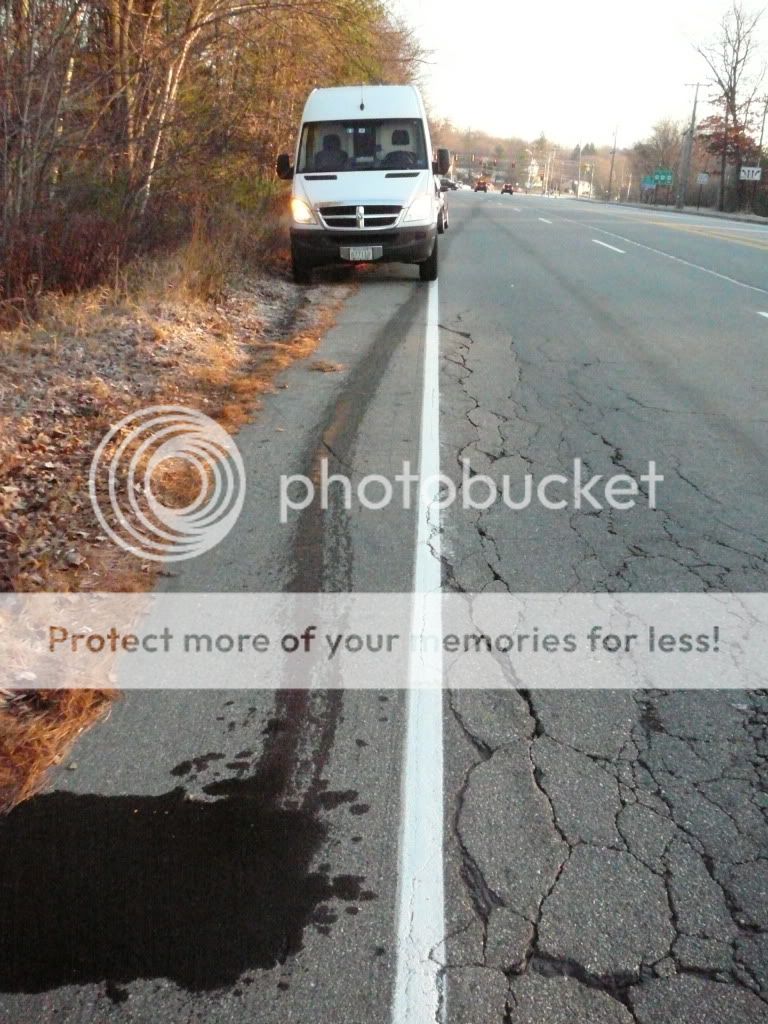

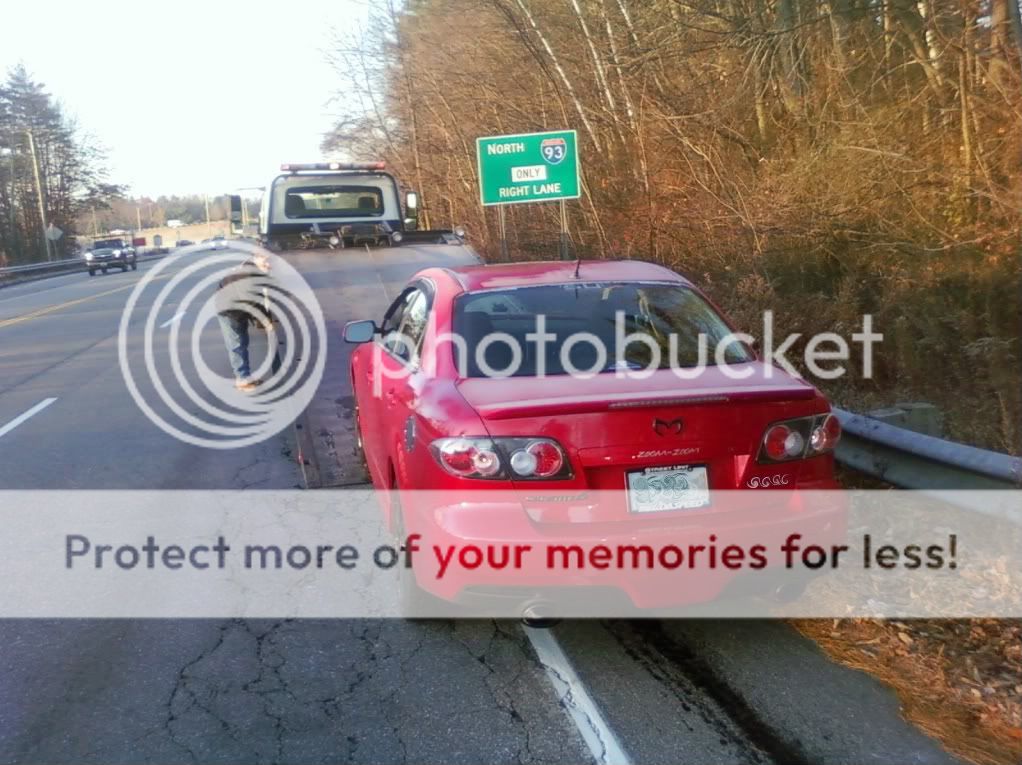

Fast foward to two weeks later. Nothing fabulous, heading to work at 6:30am. Stopped at the red light and took my right turn on red. Noticed the car across from me must have gotten his green, because he got going quickly towards me. I then accelerated about 2/3 to 3/4 throttle to about 4500rpm, shifted and BOOM!!! Smoke in the rearview, sounds of engine hitting the bottom of the car. I shut off the key and coasted over to the shoulder. I was devastated more than pissed, I knew it was related to my idiot-shifting from weeks prior. I opened the hood to see if anything was visible. Nope, but as I turned away from the car and took my phone out of my pocket, I heard a sound. Like the sound when your gas grill lights. HOLY F!! oil on my downpipe caught FIRE!!! You want to see a 6'5" 300lb guy start dancing? Do that!! I flagged down a guy and thankfully he had a gallon of water. Dumped it all over the rear of the engine and took care of the fire. WOW. That scared the crap out of me.
So now what? Call Mazda roadside? (Still covered under the 4yr 50k bumper to bumper warranty) They are just going to tow it to the dealer, where they can see my mods and tell me to go screw, right? Well, lets see..... I called a local towing company to bring it back to my house. $80 later it was in the driveway, and I used my winter beater for the rest of the week.

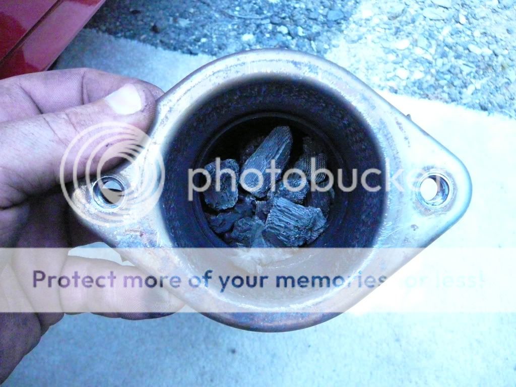

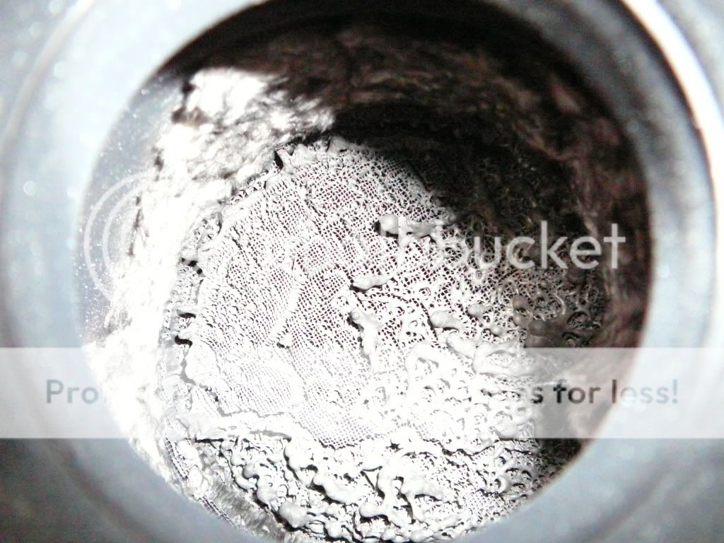

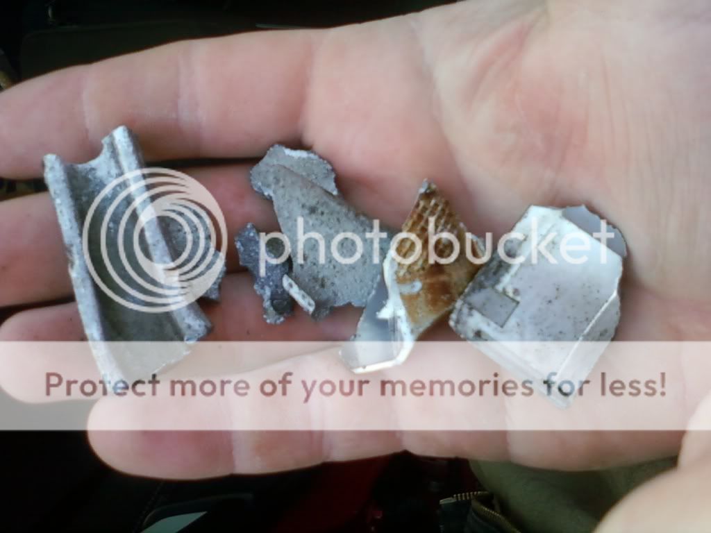

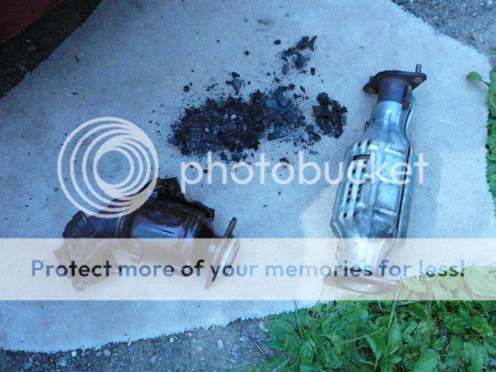

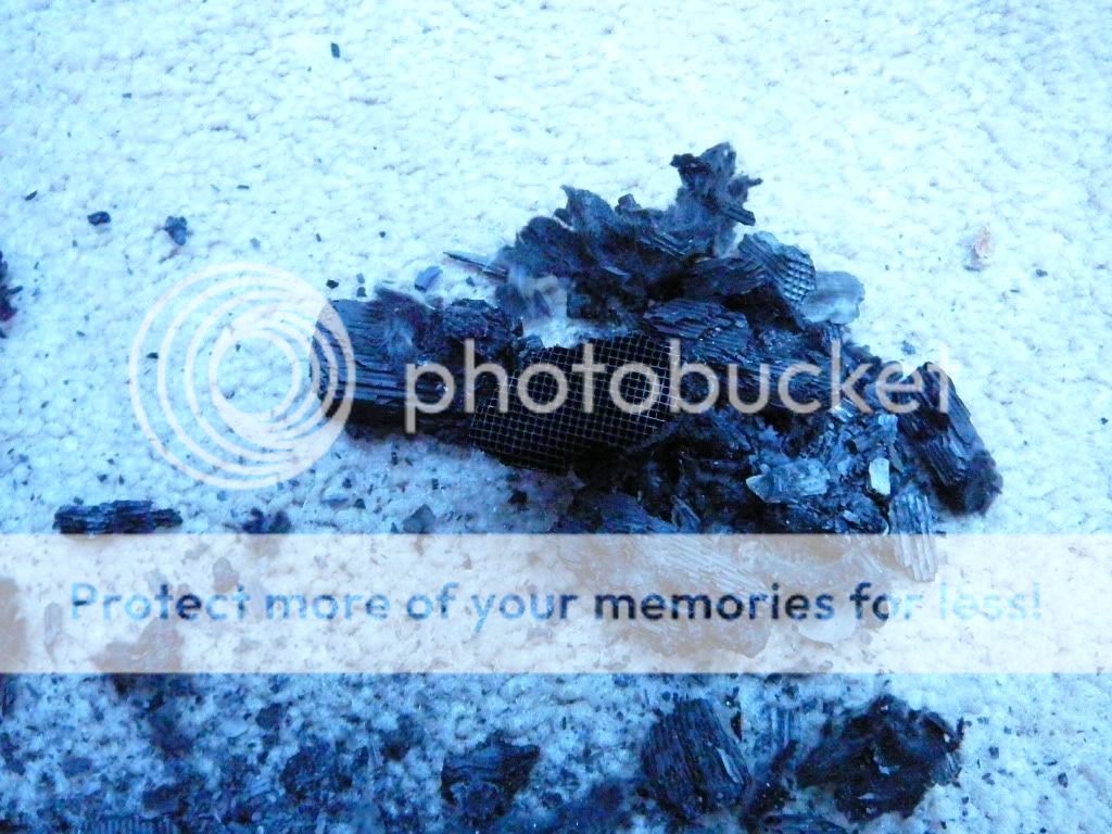

Saturday began the surgery. With the help of my buddy dan I took out every mod and put all my stock parts back in. SUBSTORY- Back in May my front catalytic converter melted and broke apart, flowed down to the second cat and plugged up the exhaust. (this was before my downpipe, but I found all this when I did the downpipe install because I knew the cat blew up) when I did the install I saved EVERYTHING, including the chunks of cat. conv.....
So now we are putting my stock airbox, exhuast, etc. back in, and I put the chunks of cat in the exhaust where I found them. Once it was all back to stock, I called Mazda, told them it died on the road with a big BOOM and it needed to be towed from my house. They picked it up that day and off it went.

Here are the pics: CAT BLOW UP
