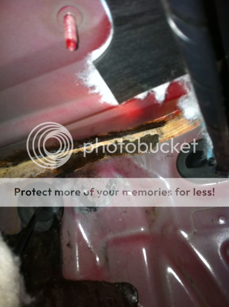

I read through this and the other 3-4 threads on this subject and I just wanted to post up what my experience was - I had the never ending puddle on the drivers side floor board only -
I really hoped it was just the sunroof drain - checked them all and they work like a champ
So I moved on to the cowl area - after I got the cover off and did a whole lot of digging and pulling out brackets/electronics and cutting the rubber matting/insulation under the dash/pedals area I finally got high enough in there to discover this:
having just bought the car used - I wasn't too happy but it's an Ohio car and you get what you get for high miles
I scraped out the majority of the rust, put some rust inhibitor on it, dried it, covered both sides w/ silicone, pushed a piece of rubber in the actual hole and sprayed the top with 3m rubberized undercoating - I'm pretty confident water isn't going to come in any more
