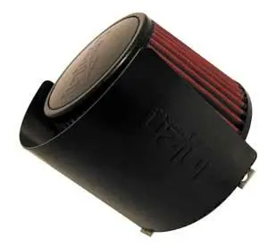

You should get an Injen HydroShield for it. I've never had any problems with rain on my CAI. You can put a HydroShield under a running faucet and the water will roll off. Splashes from a puddle won't be a problem with it.
Also, you can purchase a heat shield for the filter (which is a metal shield that shields half of the filter for a SRI install. You can use this same shield as a splash shield. I've never needed one, and never had an issue, but it may be something you could consider.

Or, just buy a HydroShield and a Heat Sheild for it. (eyeballs)

They come in diff. sizes, I think I got mine from autoanything.com but you can just look from Injens site and see who their online retailers are, for the MS6 get the size medium, trust me, its all you will need!!!!

HydroShield - Medium
You can pick up the heat shield on ebay...
Others have found them at their local auto store, but mine don't seem to have them.
Good luck!

That's why the HydroShield and the Heat Shield are a good combination. The HydroShield has been proven not to interfere with airflow, only prevent the water from entering.
The Heat Shield does not physically cover the filter or restrict air flow, but acts as a barrier to the water splash. The cool air from under the car and from the vents in the wheel well are unrestricted. So you're all good there too. (rockon)
