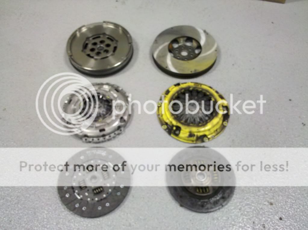

First the pics... Mazda on left(these are the revised parts found in the clutch effort TSB), ACT on right:

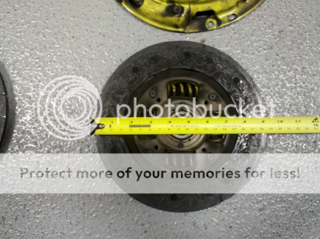

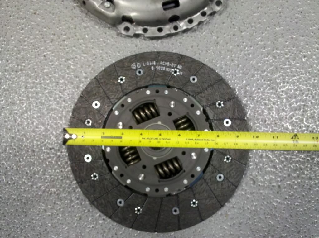

The Mazda clutch disc is 9.75" in diameter, the ACT is 9.50" in diameter:

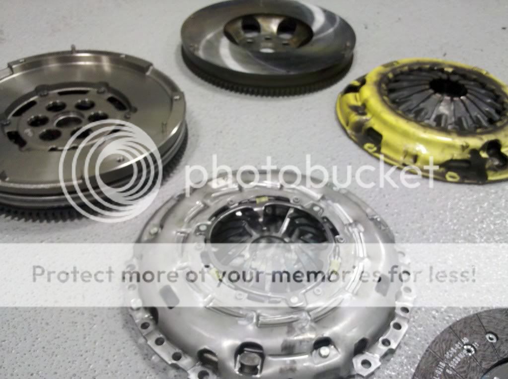

The pressure plate assemblies. I am not sure how spring stuff is calculated, but it -appears- the ACT clutch will be much heavier... which could give you the false illusion that it is going to hold more power... whether true or not.
And here you can see the dual mass flywheel that the MS6 comes with.

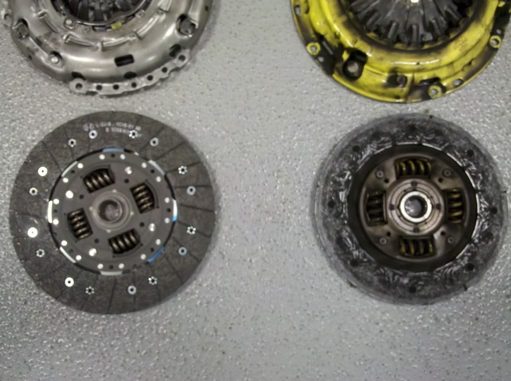

I measured the width of the clutch linings from ID to OD... these are the results:
Mazda: 1.875"(that's 1-7/8) wide
ACT: 1.125(that's 1-1/8) wide
By knowing this number, we can subtract this number from the OD radius... to get the ID radius that we need.
Mazda: 3" radius inside the friction area
ACT: 3.625(that's 3-5/8)" radius inside the friction area
