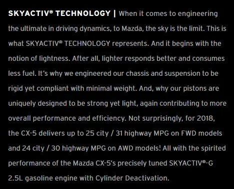

I have a 2018 , deactivation started in 2019 model MAZDA's.
From the U.S. 2018 brochure...
