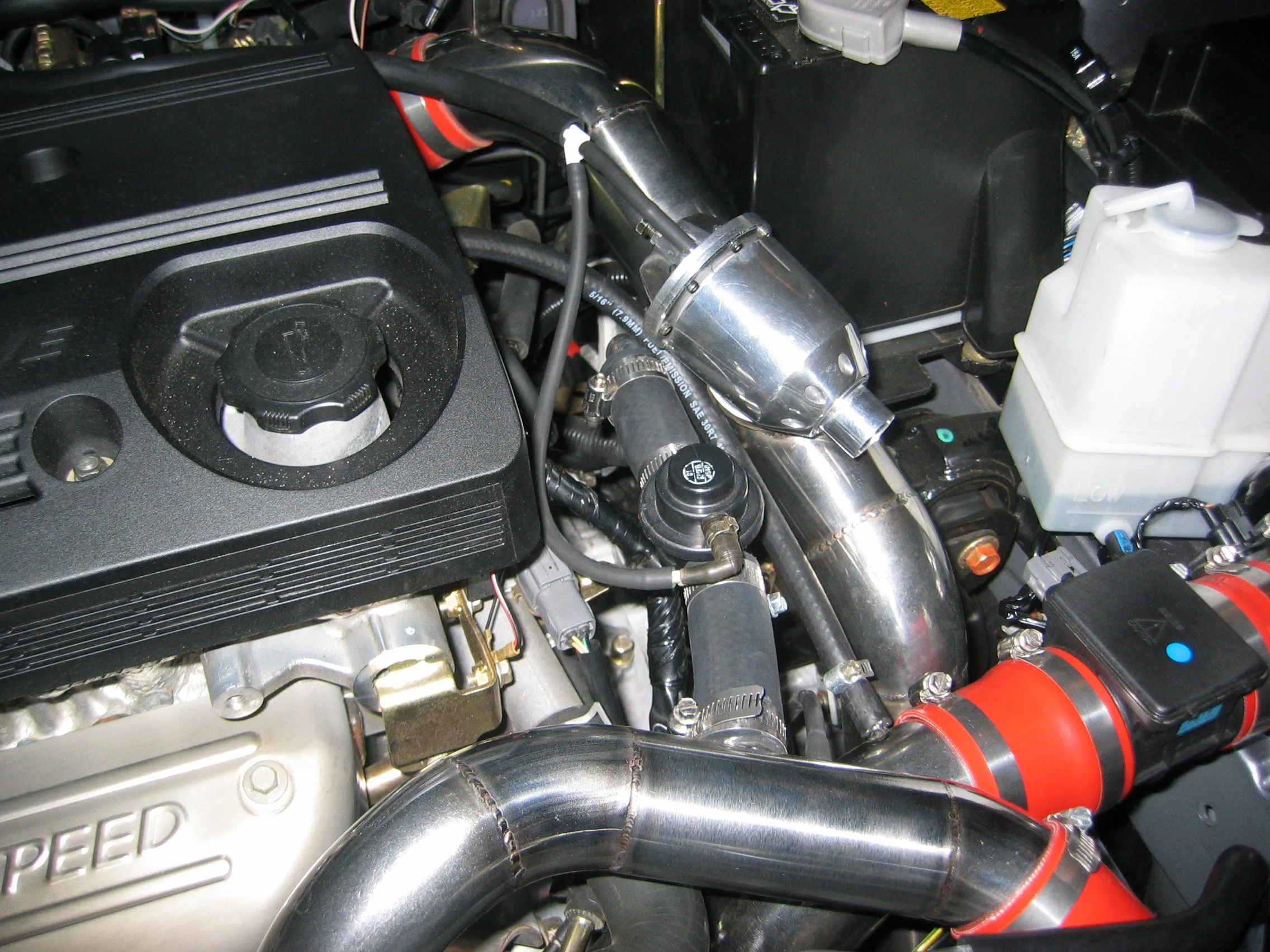

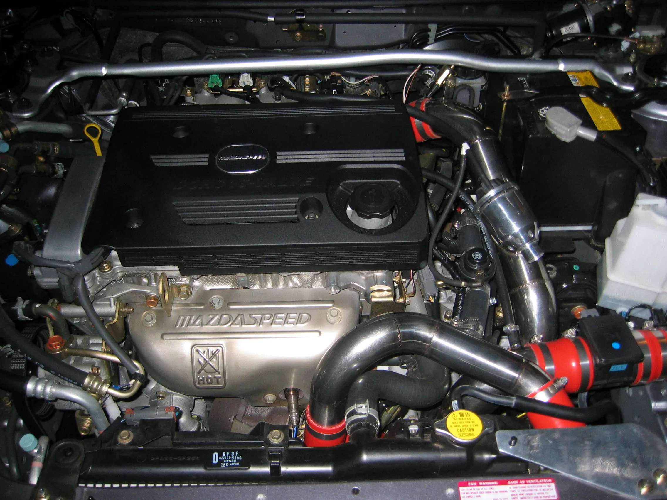

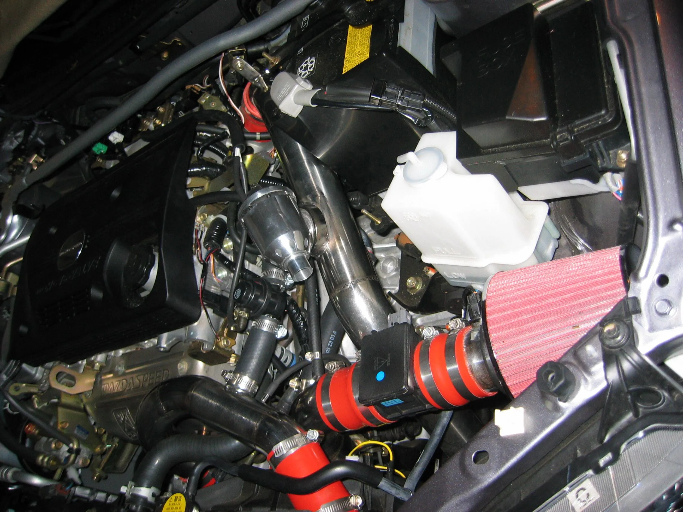

u welded a flange on the upper pipe for the bpv correct ?
No problem.
I had a one inch fitting welded on the upper intercooler pipe. Actually, I had the wastegate nipple moved to the right and the I had the BPV fitting welded right where the wastegate nipple used to be. It was the most direct route to connect the BPV line.
Just make sure you find someone who can do stainless welds. If you just go to a muffler shop they will not do stainless welds and the fitting and welds will rust out on you.
Mark
you moved it right meaning towards the turbo ?? the car is in the bodyshop so i cant really try it now :) how man inched did u move a pic would be awsome thanks ...
By "right" I mean when installed so it is moved towards the drivers side fender.
I'll try to get you a picture tonight.
Mark
Sorry, I had better pics but my xD reader doesn't seem to be working.
Hope these help you out.
Mark

FYI - these pics were taken before I routed the HKS to the brake booster, and the BPV and boost gauge to the intake manifold.
Mark
