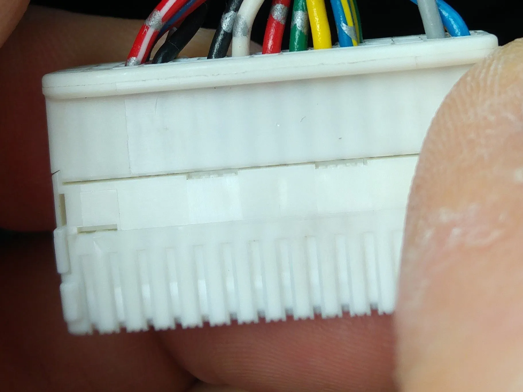

2013~2016 URGENT - what is this connector?
Mazda CX-5 Sport Nav auto 175
Aiming to replace my NB1 unit with an aftermarket one, I believe that the white multiplug connector is for the Bose amp system, can somebody confirm, or tell me what it is? Thanks!

OK, no help so far on this forum, so I contacted Mazda UK. According to their technicians, this plug holds connections for USB/Aux, Bluetooth, Microphone, and Smart City Braking System.
This last one (SCBS) really doesn't sound right to me. Surely it has nothing to do with the head unit - all the display in in the instrument cluster? Can anyone enlighten me on this aspect?
The answer
Well I sussed it out from various schematics. There are connections for Aux/USB, Microphone and Bluetooth. Nothing at all for SCBS, don't know where Mazda got that from.
