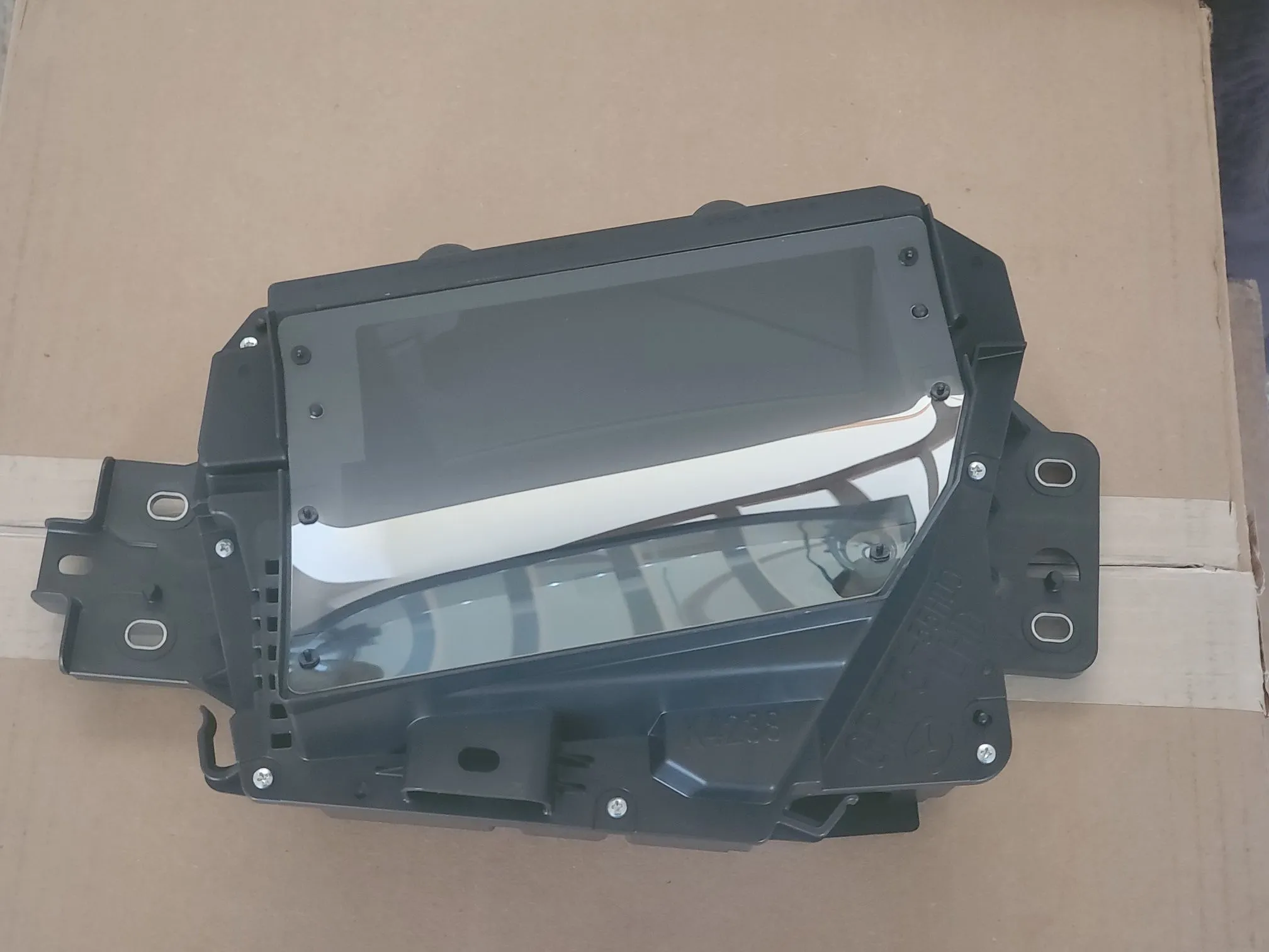

There is two parts needed
GRF5-55-HU0B Display Head Up

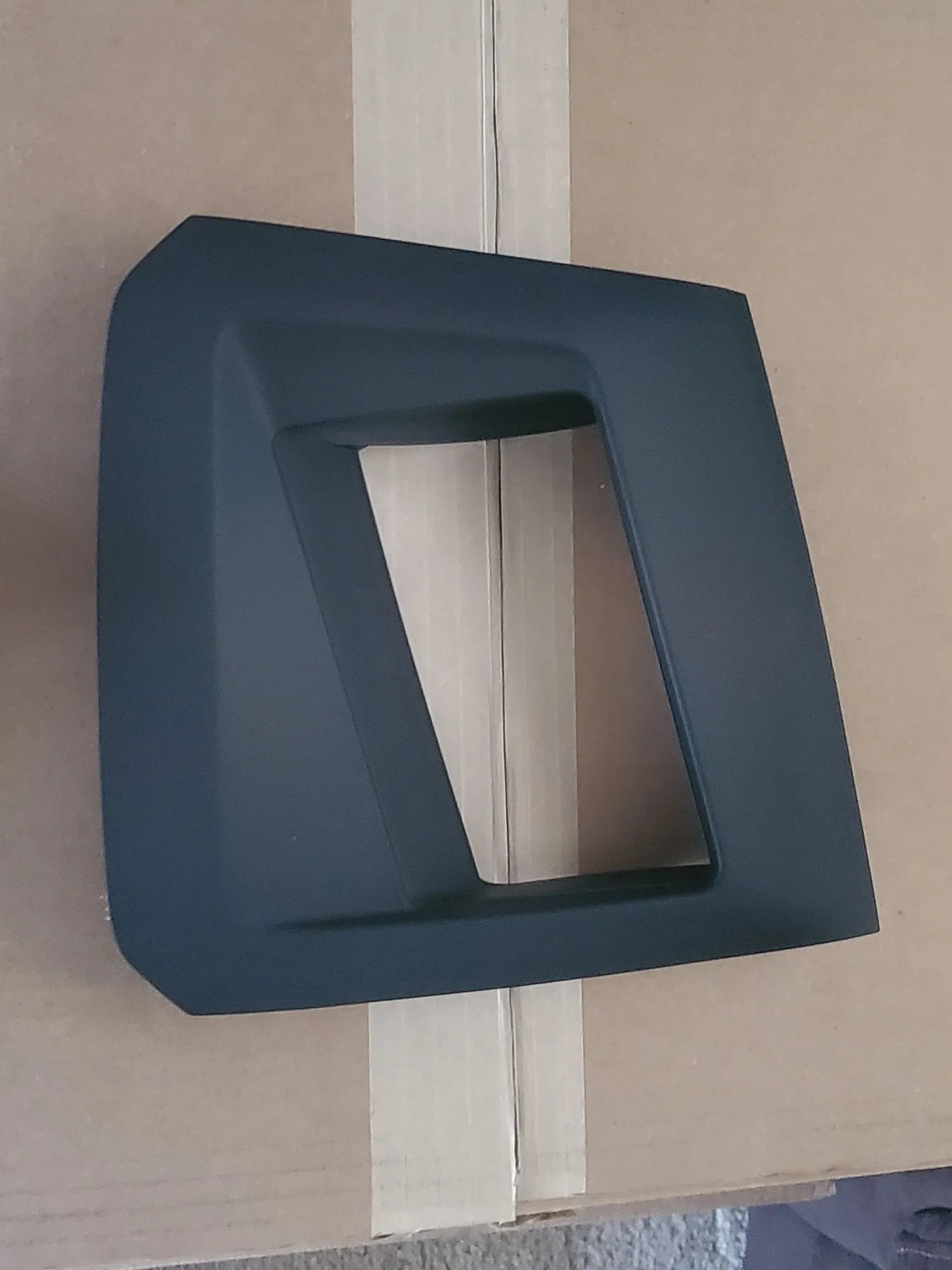

GRF5-55-41XA Upper Cover
I made the order and parts will arrive tomorrow.

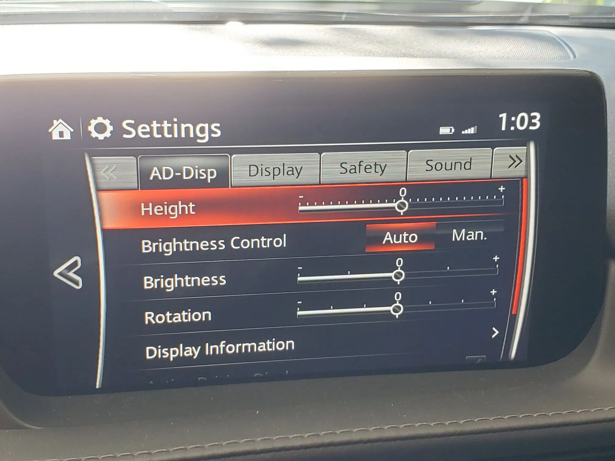

One last thing I need to verify is the control/setting tab on display will show up or not.
What I would expect, the tab would be activated when new part plugged in. Will see!
To be continued...

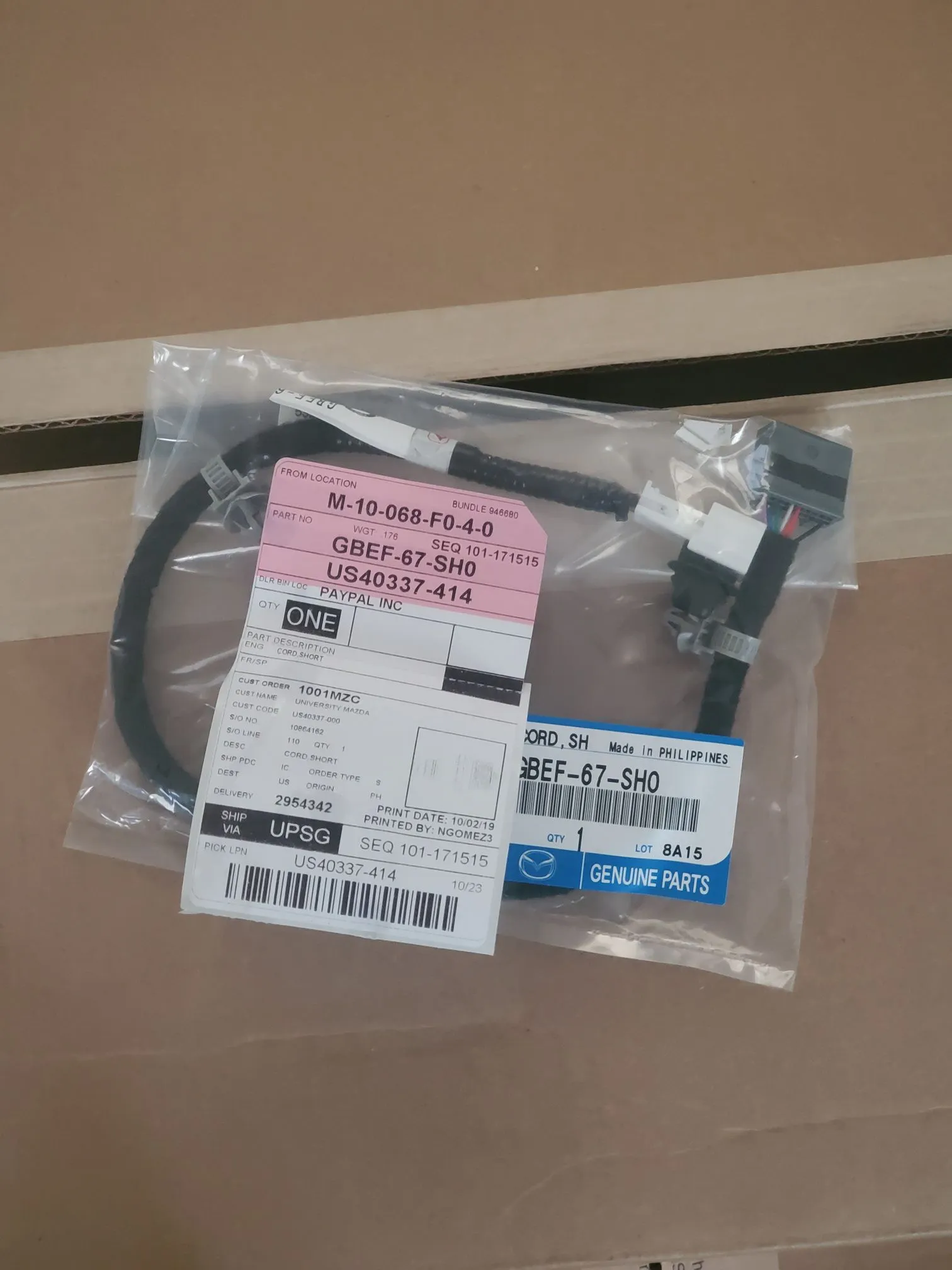

GBEF-67-SH0 Wire

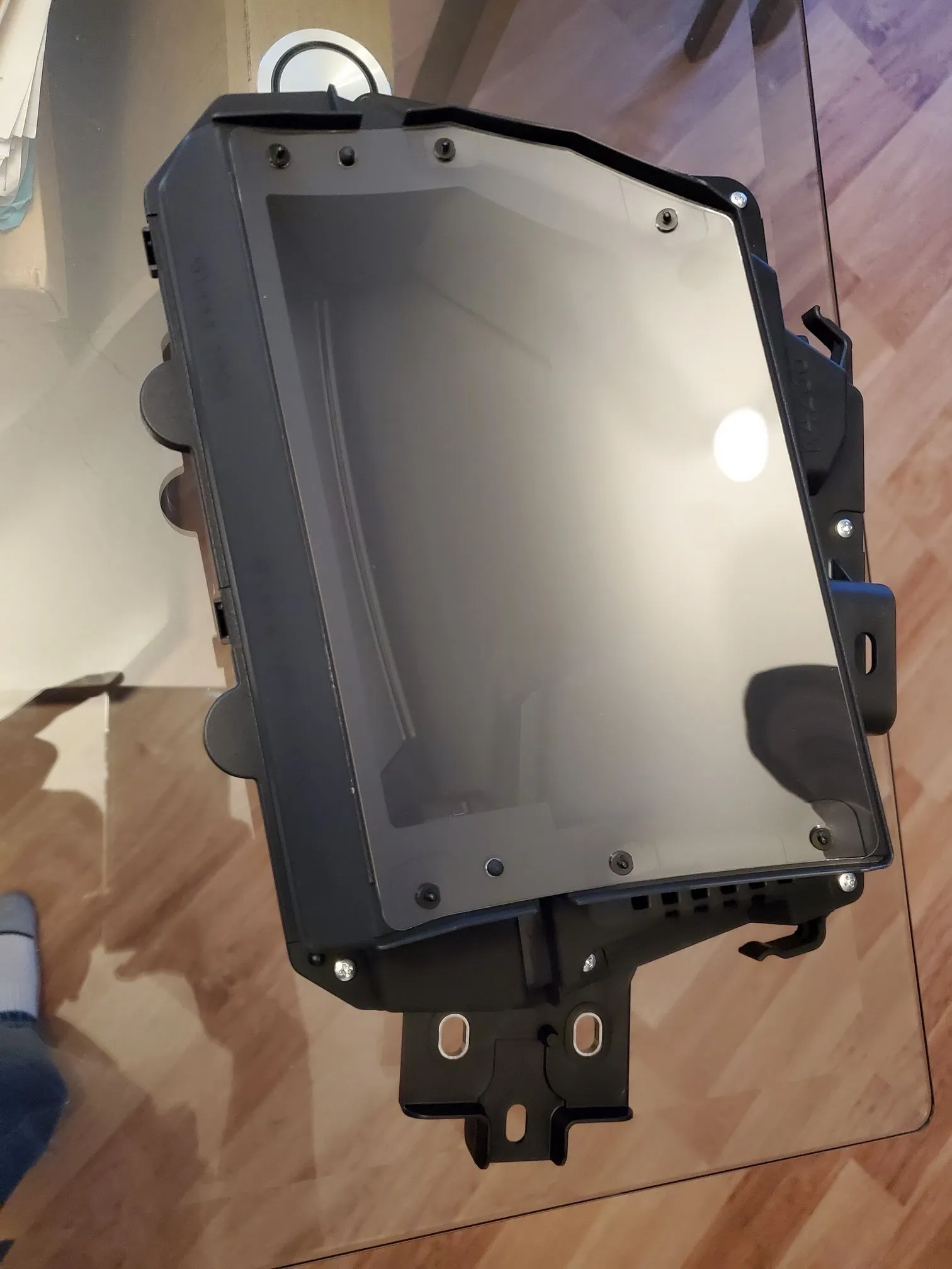

GBEF-67-SH0 Wire
There is part number for screws but you can buy them from any auto parts store. You need 4.
So, I got all parts I needed. i removed terminal cable from existing connector and plugged the HUD in.
It worked. AP-Disp tab appeared on display when you go to setting. I can see projection from the HUD.
Technically, it is Plug-n-Play but installation is another story.
