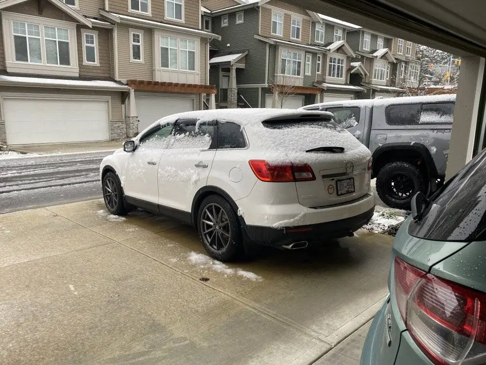

The CX-9 is a very big and sporty looking vehicle, and even the stock 20’s looked too small and too far inset for my taste. Add to that, the fact that I wanted winter tires on separate rims, so I put some winters on the stock 20’s and got a set of 22’s. Totally transformed the look of the car, and as Sm1ke already mentioned, my 22” setup is lighter than the stock 20” setup! Win, win!
Wheels are Verde Axis - Satin Black, 22x9 ET 20. Tires are Pirelli Scorpion Zero 265/40/22. No rubbing.
Looks really cool. Is ride quality severely affected by running 22's? I'm thinking of putting 22" Rotiform wheels on my car.
My ride quality is very similar stock, but only because I went with a good light weight wheel with good quality tires. If you go with a cheap/heavy wheel with cheaper tires you would almost certainly notice a significant degradation in ride quality/performance. Wheels and tires are very much “you get what you pay for” IMO.

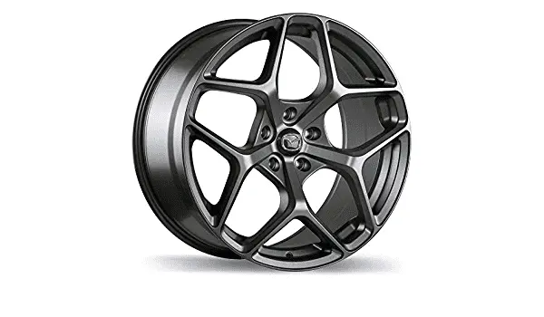

In case someone in the future is in my situation regarding an upgrade to 20s and they live in the Toronto area or wherever. I picked up my vehicle in mid-August. For several weeks I looked on kijiji and FB Marketplace for OEM 20s and it was hard to find. I did post a wanted ad and someone contacted me during that timeframe and was willing to sell his in October after he changed to these, which you can get on mazdashop.ca for $1,359 CAD plus tax (MAZDA M012 ALLOY WHEEL (MATTE GUNMETAL) - 16"/17"/18"/20"):

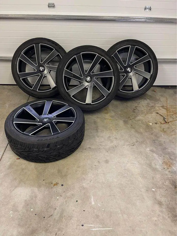

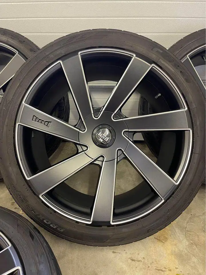

And finally, a few days ago someone posted some nice 22s with the right bolt pattern and centre bore not too small with 40 profile tires, all in good condition (all seasons used only two years), about an hour from me for $1,500. But dammit, they're matte black and I'd have to paint, and the style is a little too different than what I'd like (pics below). They came off a Pilot. And someone 45 minutes away from me posted Vossens with a style I like (similar to the Aussie fella's car that Mike posted a pic of), with tires, for $1,200, but 35 profile tires.
