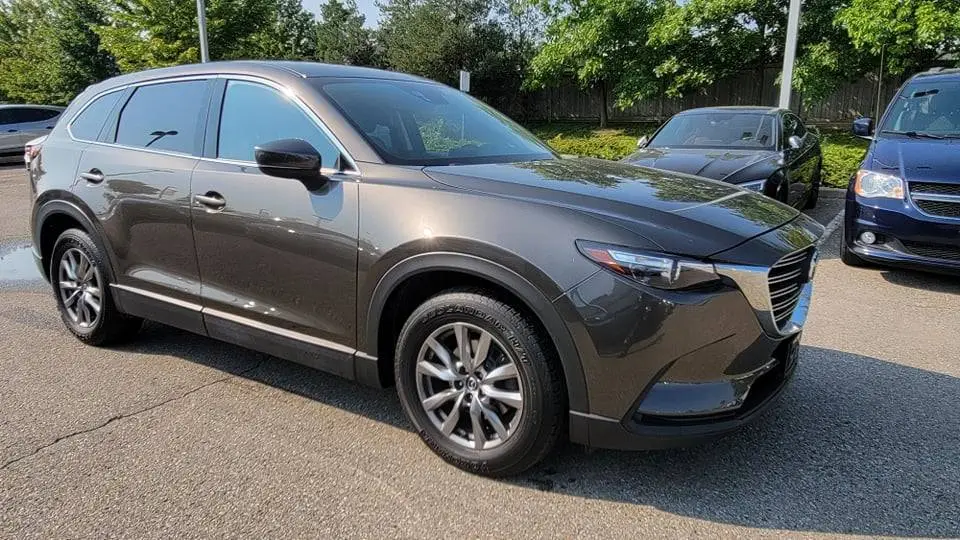

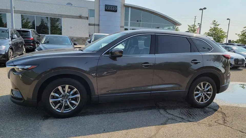

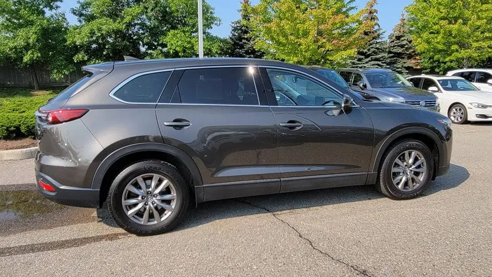

Here are some pics, which are from the dealer. When the sun is out the car shines more and doesn't look as dark grey like in these pics.

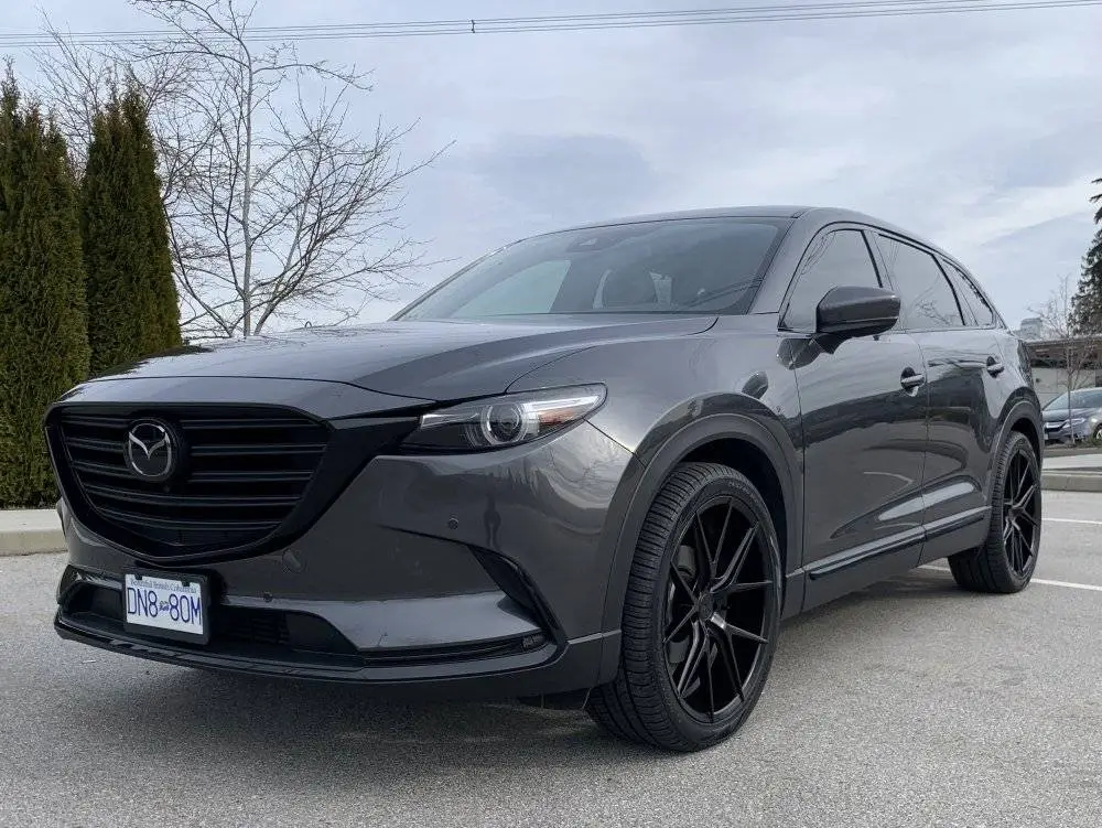

I put 22s on my CX-9. I'll attach a pic with the wheel specs below.
As far as specs, I took a picture of the space between the inner rim and the suspension, just to get an idea of how much room there is to play with. Then took note of the plastic fender guard's design and how far away the outer face of the rim sits from it (again, just an approximation). Then I used a tire/wheel size calculator to find a setup that worked for me. Personally, I use willtheyfit.com. Here's a pic I took of the space between the inner rim and the suspension with my OEM 20x8.5 +45 wheels on the front. The rear has more space to work with, but I wanted to go with a square setup so I could rotate the wheels and tires.
attachment.php
Keeping the above space in mind, I plugged the specs of my OEM wheels/tires and the specs of my intended aftermarket wheels/tires into the tire/wheel size calculator to see the differences. Here's a pic of the same space above, with the aftermarket 22x10.5 +30 wheels and 285/35 tires installed.
attachment.php
Others have also put 22s on their 2016+ CX-9s. Here's @Stryker medic's CX-9 on Ace Alloy Convex, 22x9 +35 all around with 265/40 tires. Looks about as close to an OEM-style wheel as you can get, IMO. He says no rubbing issues with this setup.
Here's a couple of pictures of @Edgar_C's 2016 CX-9 on Vossen CV4 wheels (now discontinued), 22x10.5 +30 with 285/35 tires. No rubbing with this setup either.
And a couple of pictures of my setup. Basically the same as @Edgar_C's setup, just with different wheels (Vossen VFS-2 in satin bronze) and 5mm wheel spacers in the rear.

Unfortunately I wasn't able to find any pictures of a 2016+ titanium flash mica CX-9 with aftermarket wheels during my quick search, but I think I'd agree with you in terms of your preference for a brighter coloured wheel like silver, or a polished/machined silver.

Mike, post a photo of yours with 22’s. I honestly didn’t think 22s would look good on the CX9 but yours look fantastic, especially with the contrasting color.
Thanks! Pics posted above.

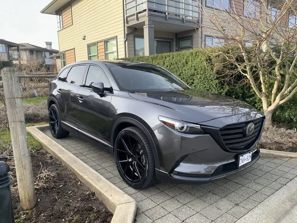

I’ll toss in my 2 cents…
The CX-9 is a very big and sporty looking vehicle, and even the stock 20’s looked too small and too far inset for my taste. Add to that, the fact that I wanted winter tires on separate rims, so I put some winters on the stock 20’s and got a set of 22’s. Totally transformed the look of the car, and as Sm1ke already mentioned, my 22” setup is lighter than the stock 20” setup! Win, win!
Wheels are Verde Axis - Satin Black, 22x9 ET 20. Tires are Pirelli Scorpion Zero 265/40/22. No rubbing.

Really nice.
I've been paying more attention on the road now to the CX-9s and the 20s merely look "just fine" to me. Certainly good enough for a family vehicle, but it's still overall an attractive vehicle. Since there are so many more options, new and used, for 20s I am really considering just settling for that since it's my wife that will be mostly driving it. However, I do have to look at it everyday in my driveway so still pondering the 22s, but all the used ones that pop up are not the right bolt pattern and not a suitable style either as they're usually more aggressive looking wheels that belong on a Charger or a pickup, etc. Though there's a few Mercedes and BMW wheels, but they don't have the right bolt pattern.

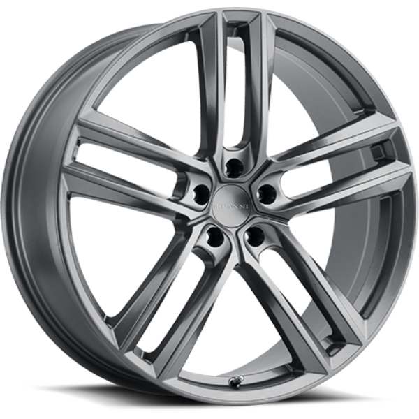

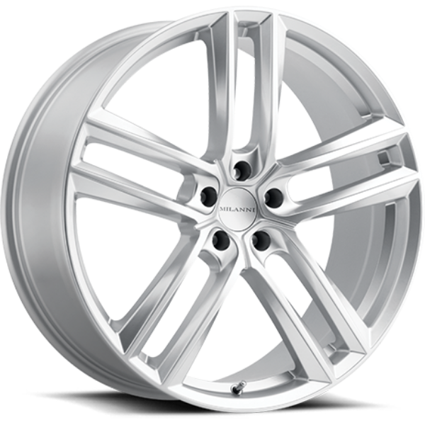

Here's a 22x9 gunmetal for $324 CAD with 10% off at the moment. And then the silver version. This would be very close to what my brother in law has on his Tiguan.

I like the darker colour on the first set. The wheel style is a great choice, it has an "OEM+" look to it.

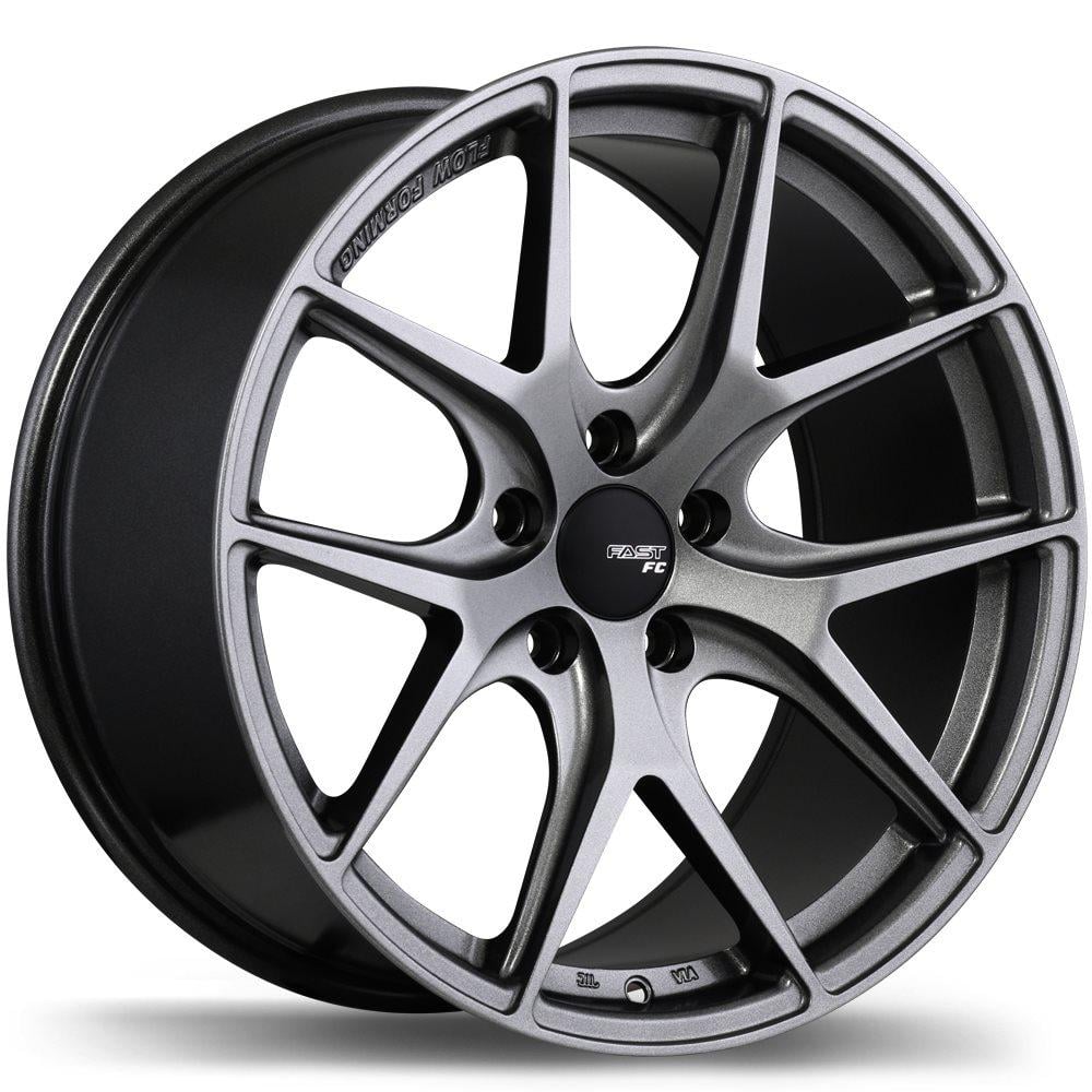

Been thinking about 22s again. I like this look:
And I can get these wheels for $307 CAD, no tax and free shipping. They are Fast, which has a relationship with Mazda. They are made in Montreal.
Problem is that they only come in satin bronze and gloss black. I actually emailed them to ask if they'll ever be producing them in the ever popular gunmetal or titanium. If not, I was thinking of DIY spray painting them. Then if I didn't like the shade after one season I could change to something else. Also down below is a titanium shade I like.
