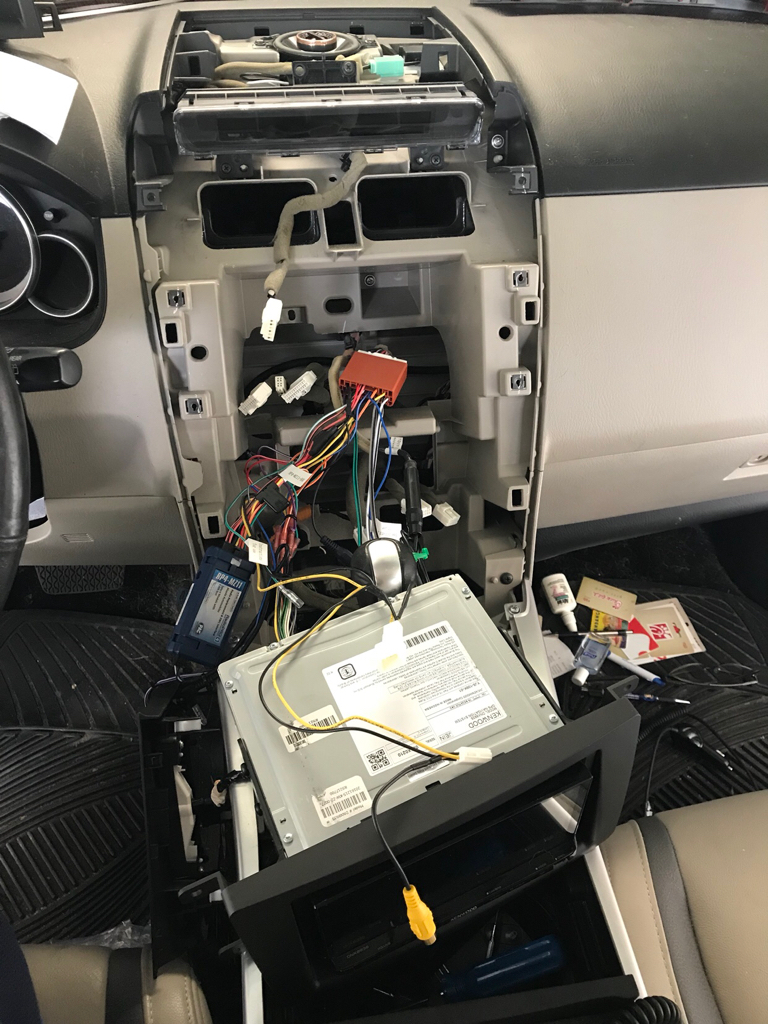

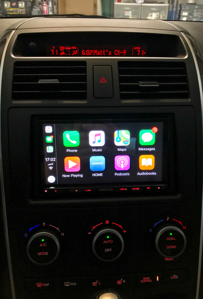

The deck went OK. Crutchfield's guide diagrams and photos were very helpful, but the material provided with their ready-made wiring harness left much to be desired. I never did get my factory rear-view camera to come up on the new deck. The image quality was so poor on the OEM screen, I've learned to live without it, anyway. At first, CarPlay didn't come up, but re-initializing resolved that. For the life of me, I can't figure out how this particular unit was a "scratch and dent" special. The only "damage" I see is a bit of crusty gunk (dried adhesive, maybe) on the edge of the screen, most of which came off with my fingernail. And the firmware shows to be the most current, so I didn't have to screw with that.
Steering wheel controls work fine. You'll see when I get around to posting photos that I changed the default "AUDIO" to "Matt's CX-9" on the dash screen. I haven't seen anything on how to change the time, but as this weekend was Spring Forward, I went ahead and did that adjustment before I removed the OEM deck. Also of not about the OEM deck, when I ejected a CD I'd had in there for years, the screen stuck in the down position. I don't listen to CDs anymore, so I have no idea how long it's been like that.

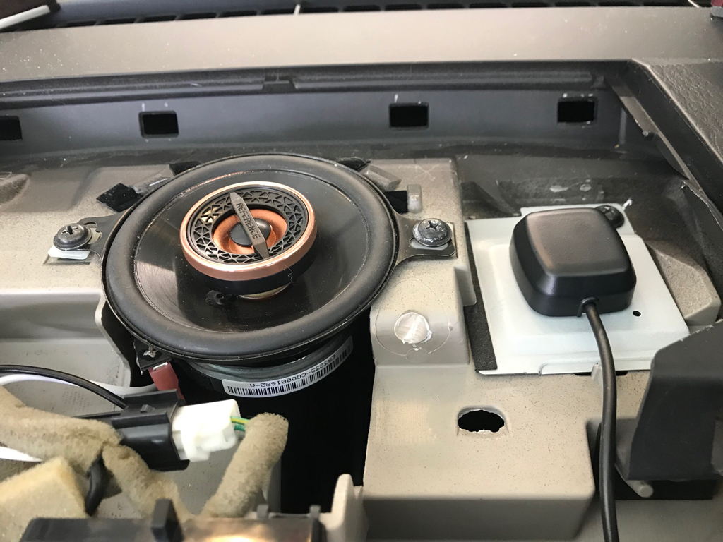

I wanted to use the OEM GPS antenna, since I found it under the center speaker grille, but the connection went into one of the harnesses and I couldn't find where it came out. I simply removed it and put the Kenwood antenna in the same spot.
The three dash speakers were fairly easy to replace. One problem I had was the two corners left little room to get any kind of tool up under the windshield, but I persevered with a vise-grip and a bit from my screwdriver kit.

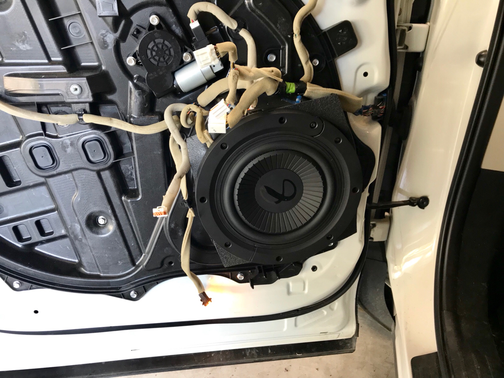

The Infinity subs didn't fit. Though they mounted just fine, the flange around the edge is too beefy for the door panel to fit without further modification to the panels, which I'm not willing to do. I'll return them and am looking at a couple of 6x8"/5x7" models from Infinity and JL Audio. Precision Power and Focal have 8" coaxials that might do the trick, too.

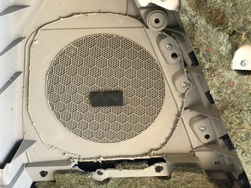

Well, after the 8" Focal components didn't fit the space (off by .25"), I revisited the Infinity Reference Flex 8" subs I mentioned earlier. It took a Dremel and some trial and error, but I got them to fit. It's not pretty on the back, but everything fits and functions.

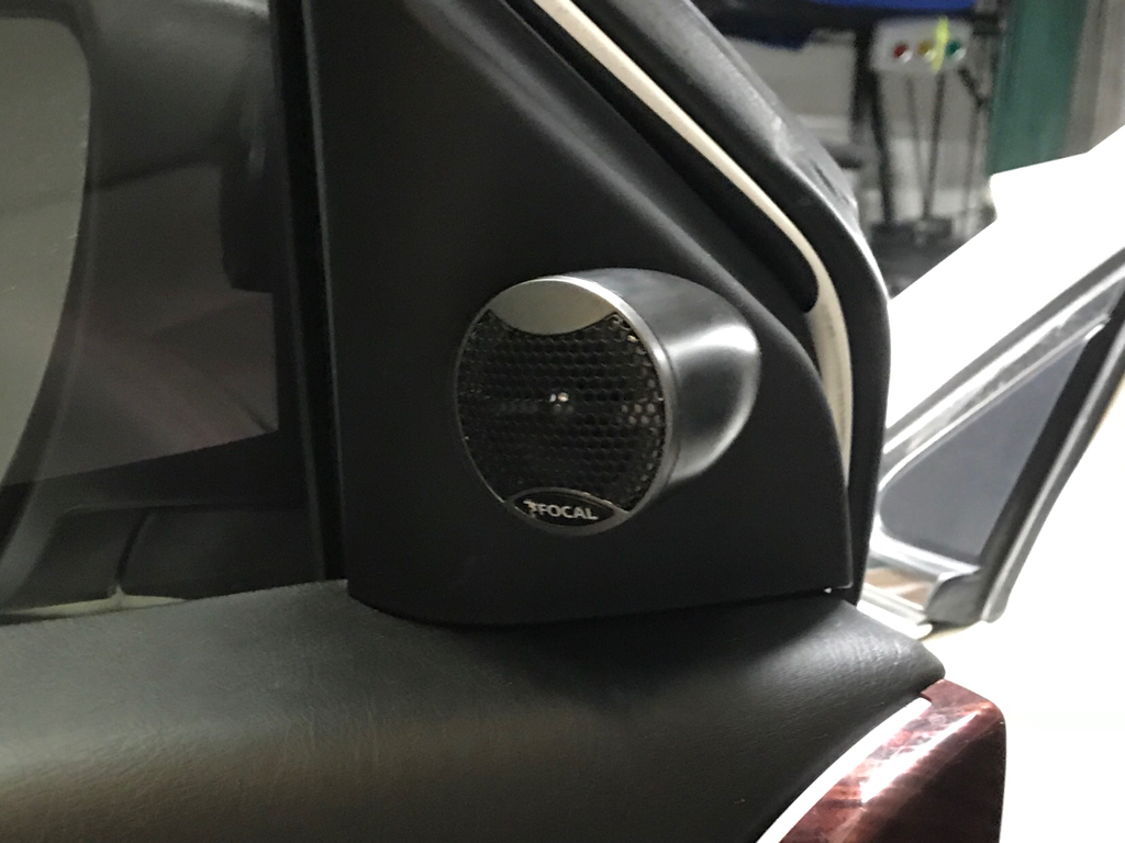

On the downside, I drilled and attached the Focal component tweeters in pods on the little triangular trim pieces on the door. I either need new ones now, or live with the holes.
Before I return the Focals, I'll see if by a miracle I can fit them on the back doors.
The Focal tweets I had to uninstall.
Infinity 8" sub fits the stock holes, albeit with longer screws. Foam baffles behind.
After Dremel shot of the door panel. It ain't pretty, but it worked.
Kenwood eXcelon DNX893S is a solid upgrade. Got it for around $550, scratch & dent. Other than a smudge that came off with my fingernail, I see nothing wrong with it.
Replacement center channel. I may go with a Kappa Perfect 300m if I can find one on Ebay without its mate. Note the Kenwood's GPS antenna where the OEM antenna once was.
Rat's nest mid-install.
a little OT: You have an interesting A/C display...how did you get that to work?
You know, with those big boys in the doors, you don't even need to subwoofer in the back if you give the infinitys some power and cross them over properly. If you want to spend the money & space for it, put a 12 or 15 in the back area to pick up the very bottom octave (20 - 40Hz).
