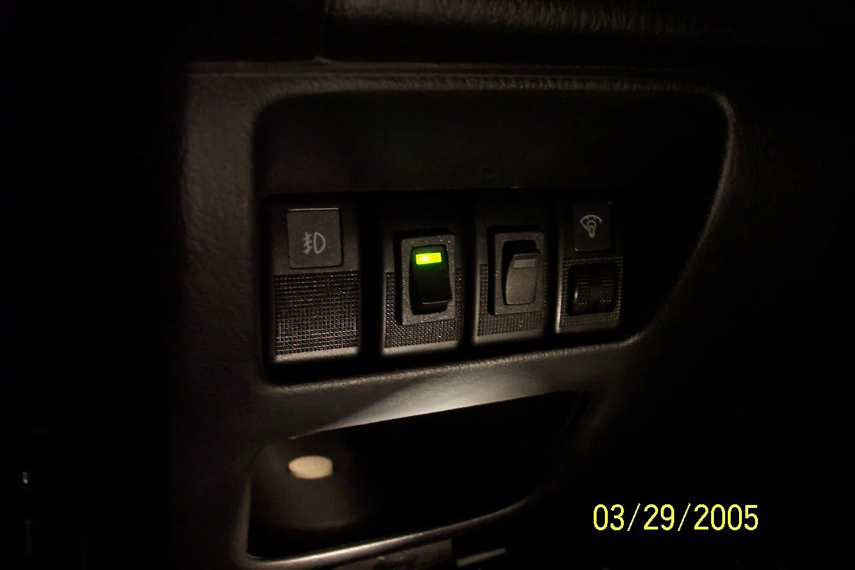

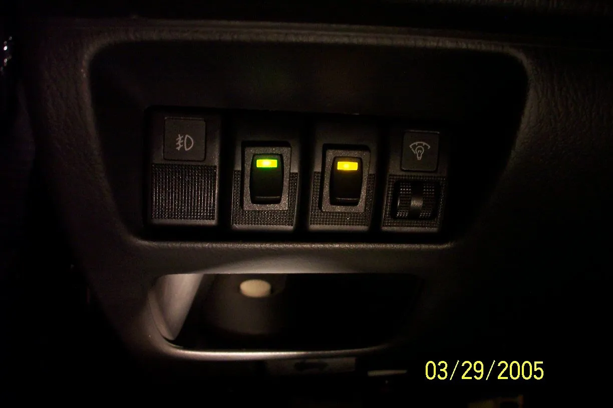

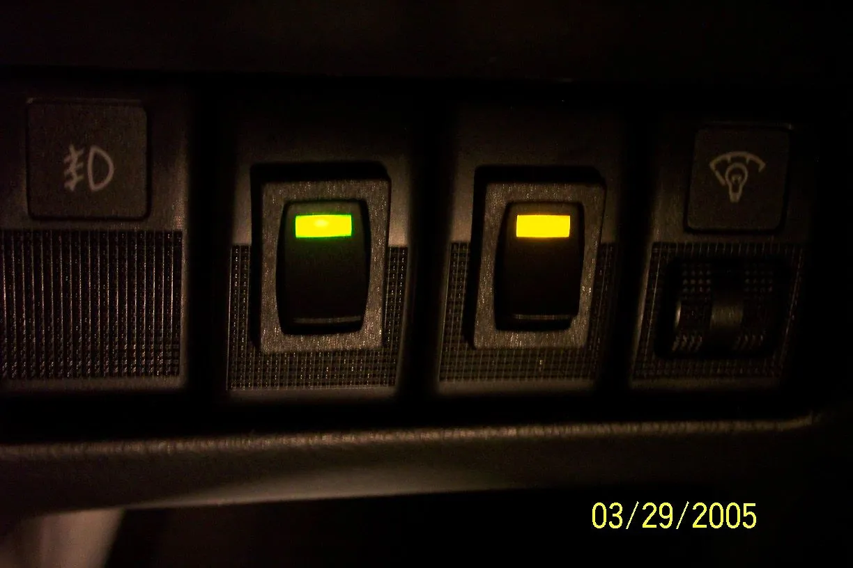

This past weekend I installed the boost and map switches in the two blank panals. As suggested by WillisW555, I used a Sears rotary tool to carve out rectangular holes for the switches. The end product looks as if it was installed by the factory. Unfortunately, my digital camera is being fixed, so pictures will have to wait until its returned to me.
For a factory look I cut all the wires to the switches so I could pass the switches through the front of the blank panals. I then used some additional wire when needed, and butt connectors, to finish up the job. The ECU power switch is zip-tied up under the dash with all the wiring. I am pleased with the final result.

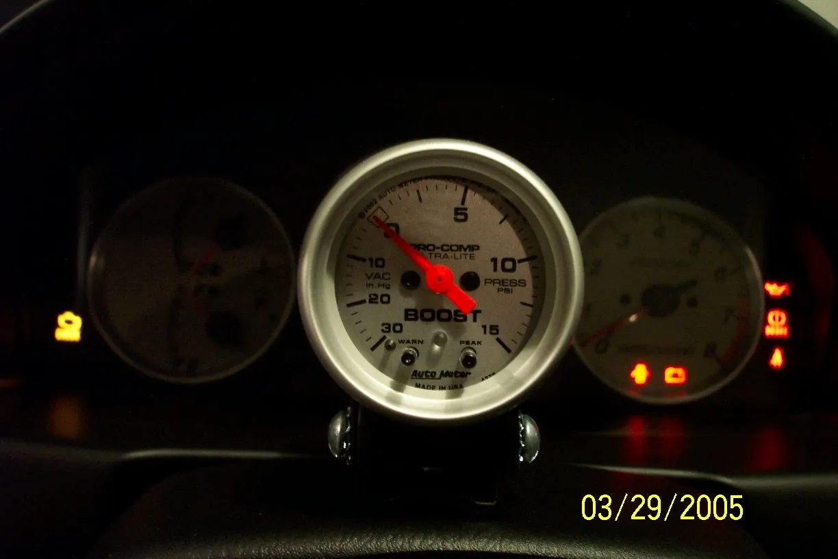

Okay, here are the promised photos of the installed Unichip switches (the first three photos), plus a shot of my Autometer Pro Comp electronic vac/boost gauge (the last photo). The second switch from the left with the green light on is the boost switch, and the second from the right (the light is off in one photo and the orange light is on in two photos) is the map switch. The light being on indicates the switch is on high boost or map B, respectively.
I noted what I did in earlier posts, so I will not comment further unless asked to do so. I am quite pleased with the final result.
