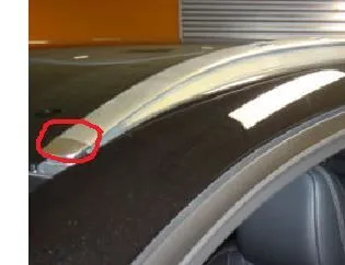

A simple test - put some painting tape on the part that joins the head and body of the roof rail (there's a small gap). Turned out my passenger roof rail was making that noise and was silenced by the tape.

I have a whistle in my new CX-5 as well. It starts a bit above 30MPH and increases in pitch up to highway speeds.
Did some poking around and it's the right roof rail.
If I put tape between the window and rail, the whistling goes away completely.
I looked again tonight and noticed that there's a decent size gap between the rail cap and the rail itself on the right side. It tapers from the outside to the in (wider at the outside, narrow on the inside). I believe that is the likely cause of the whistle.
I'll take it to the dealer next week to get it fixed, replaced, or removed completely. I didn't actually want rails but the trim and color I wanted had the rails and I just had them charge me less for the upgrade.
EDIT: Sure enough, a single piece of tape covering the gap between the cap and rail makes the sound go away.
