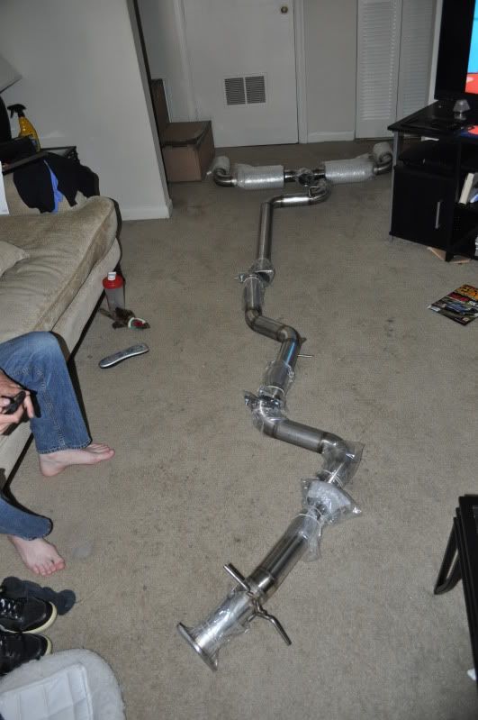

I recently purchased the Ultimate Racing test pipe and cat back exhaust. The install was very difficult due to my lack of tools and no car lift. I had a low profile jack. So the car wasnt that high off the ground. The section that went over the rear axel was the hardest portion to remove and install. The secondary cat was the easiest. An impact wrench and car lift would have turned this into a two hour ordeal, but it ended up being six hours total time.

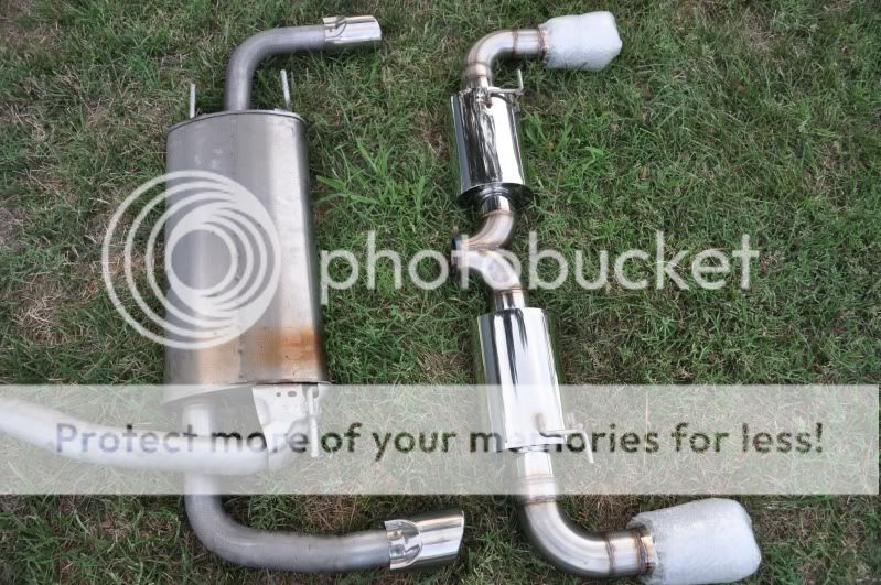

stock exhaust
ultimate racing

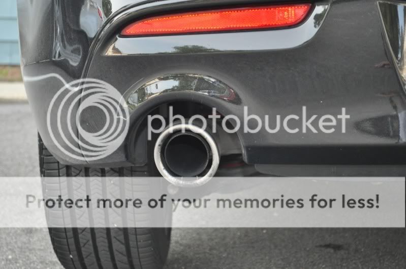

Did you notice any change in the soot that ends up on the back of the car with the new exhaust? It looks like the design of the tip is different and I wonder if there is any change in turbulence or air flow which would affect how much soot ends up on the rear bumper and hatch.

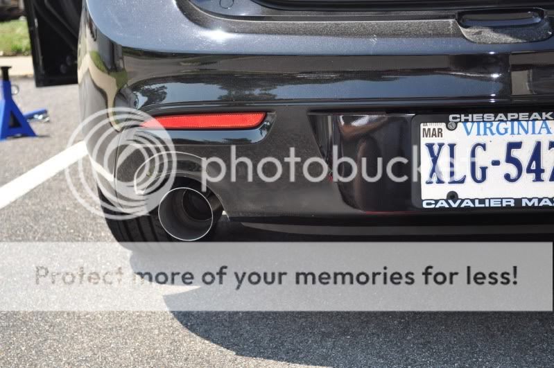

I agree the welds aren't the best looking.... the welder was moving too fast when he created that weld in the pic.
Been a hot minute since the install. So now that I am used to it, the sound is awesome. Still hasnt gotten on my nerves and it is just short of the STI with a Greddy TI-c exhaust on. But you can definitely hear the difference in the lesser aggressive cams of the Mazda. But it still sounds mean. The soot is still there. Just as rich as before. The Dyno showed 10.0 afr from during WOT, so no change there. need me some AP action.
