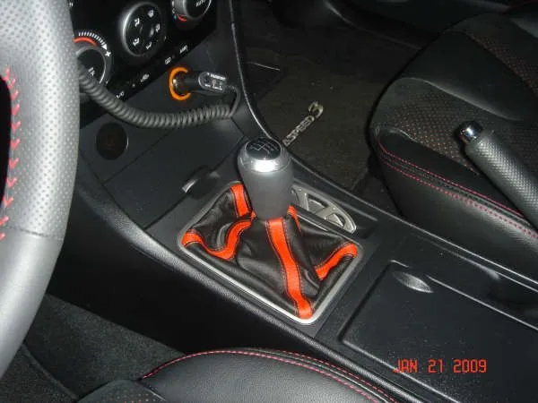

Just put a new boot on too, which makes it look as awesome as it drives
