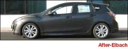

I just put new wheels on my car and for some reason the wheels look much smaller. I want to reduce wheel gap so I am seriously considering Eibach Pro Kit springs. The drop is less than 1.5" which is a necessity unless your are willing to buy a camber kit and new shocks after a year. If I install the springs and something does go wrong, I wouldn't want stock parts on the car anyways. The suspension problem would need to be directly related to the installation of the part for them to legally void it anyways.
In your case, going through all the trouble of buying used springs or overpriced springs from Mazda and getting them installed seems like a big pain and IMO a waste of money. I would bet that 5" would look very similar to what you dislike now.
Hope this helps and let me know what you decide on. I attached a photo of the eibach springs after. If I buy springs I'll send you a pic
-Jack
