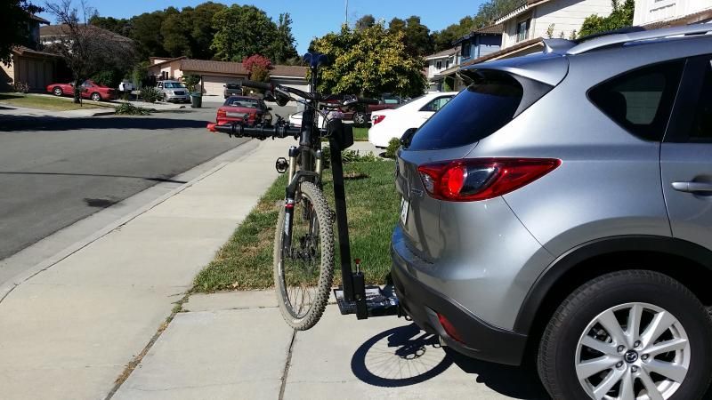

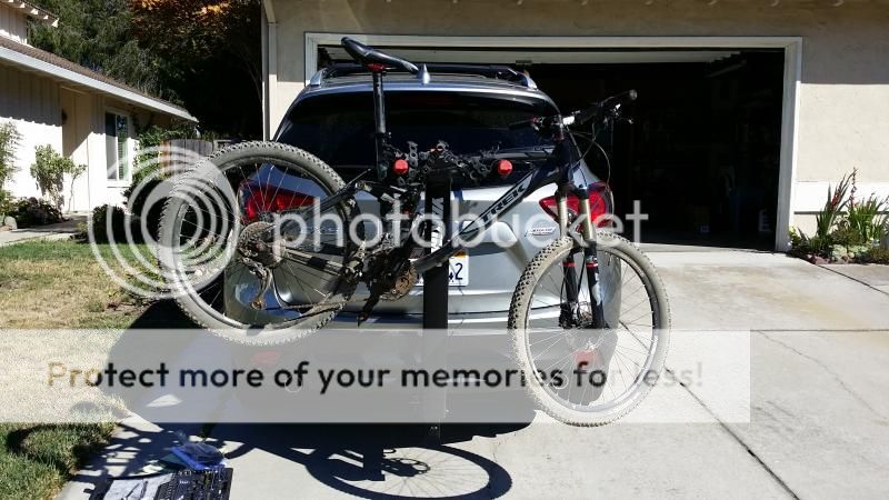

You are going to be MUCH happier if you install a hitch and use a rack that mounts to it, no question. Spend the extra dough and go with a hitch from etrailer.

I will never, ever ever ever use any bicycle rack that touches a car's paint. Ever. A hitch rack is the only viable option, and preferably a rack that doesn't touch the bike frames, either. The types that secure both tires are best for both car and bike.
