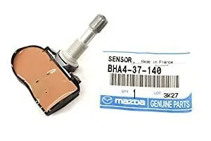

You can either get 4 TPMS sensors and install them to the winter tires, or you can just let the TPMS warning light on without installing the TPMS sensors. For TPMS sensors, you can either get OEM or after-market ones. OEM runs about $68.58 each and after-market one such as Autel MX-Sensor 2 in 1 (315MHz + 433MHz) Clamp-in 100% Cloneable TPMS Programmable Sensor runs about $29,95 each. When you get after-market sensors, make sure the seller programmed the sensors to be Mazda CX-5 TPMS compatible.
Aftermarket or OEM TPMS Sensor
