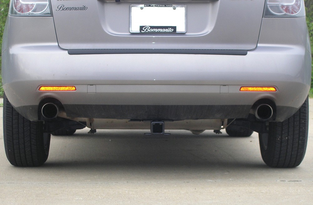

etrailer.com sells the hidden hitch and drawtite in which both need no cutting of the bumper and are a clean install
Class 3 - 2in receiver
EDIT: i just placed an order for this hitch so ill update you guys on how the install goes. Looks pretty simple after watching etrailer.com video
With help from my bride, we installed a Hidden Hitch from eTrailer.com. It was a smooth and easy install. Absolutely no problems. I suggest that you watch the installation video about 3 times before you proceed. It looks just like the one posted above. Silver CX-7. (hump)
