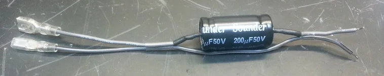

I had to cut off the connector and extend the wires.
This bass suppressor I had to put it together, since they give you the bare capacitors only.
I have used the wires with connectors from the component speakers that I have purchased. Those won't used connectors, they will be soldered to the factory connector's female plug.
