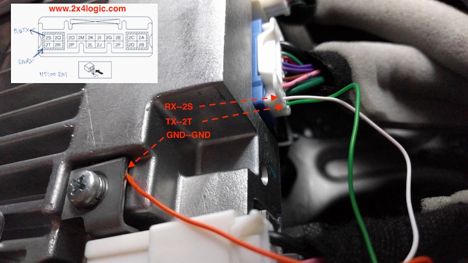

Mazda AIO tweaks can disable the touchscreen lockout. You will have to do connect directly via serial depending on your firmware.

I did the mod two months after purchasing the vehicle. Taking apart the dash was the easy part but wiring the CMU took more time than expected. Overall, the entire process was about 2 hours. The software for Android auto isn't perfect but it's definitely superior to stock. In additional to install AA, I have touch screen while driving, removed the disclaimer, removed the safely back up warning and the delay lag when scrolling. I have FW 59.xxx something though, not FW 70+
