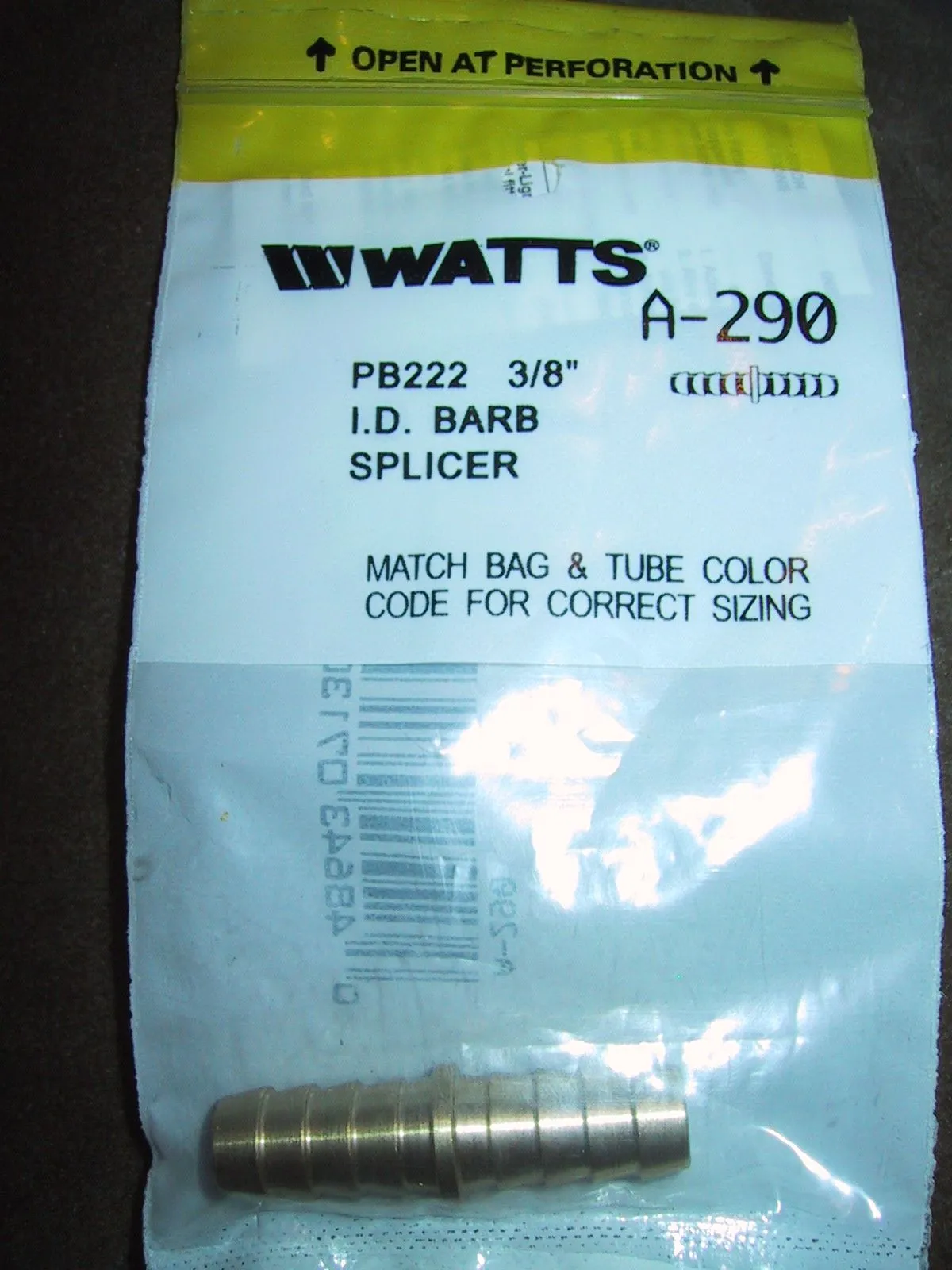

Hi guys, I just did the TB coolant bypass, and just wanted to share some pics I took during the process. I was also doing the TB thermal spacer at the same time, so I took my TB all the way off, but you dont have to do that if you just want to stop the engine coolant from going thru the TB. There are two hoses coming from the engine to the TB that run coolant thru it, to help with emissions and warming up the engine. But this also warms up the air coming in to the engine, which is a bad thing. All you need to do is get a 3.8 in I/D coupler from Home Depot (in the plumbing section) and run the hoses together. See pic 1 for the part that you need from home depot. I jacked the pic from this thread
http://www.msprotege.com/forum/showthread.php?t=71052&page=2&pp=15
Because I didnt take a pic of the bag. Oops, but I will give credit to Protege_Speed for the pic. There is more info on this mod in that thread if you are interested.

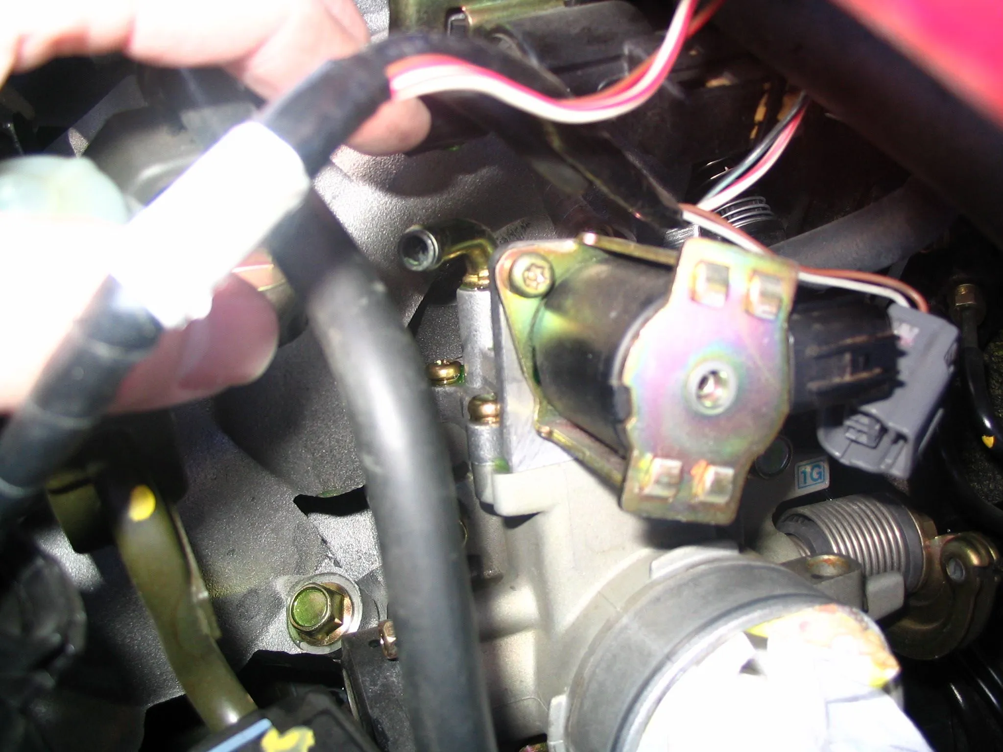

Here are the rest of the pics for this mod. Its really not too hard, but might be difficult if you have big hands. In one of the pics, I show the TB removed from the car. In this one, you can see the fittings that the coolant hoses connect to, on the left hand side of the TB.
I hope this helps, and just post if you have any questions and I will try to answer them. 30 minutes tops, and you will be done.
EDIT: Oh, almost forgot. Once you put the coupler in the hoses, the old clamps will no longer fit (as you can see from the first pic below). You will need some small screw type clamps to make sure the hoses stay put.
