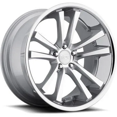

1st is: 20x8.5 Silver Wheels 5x4.5 (offset +35)

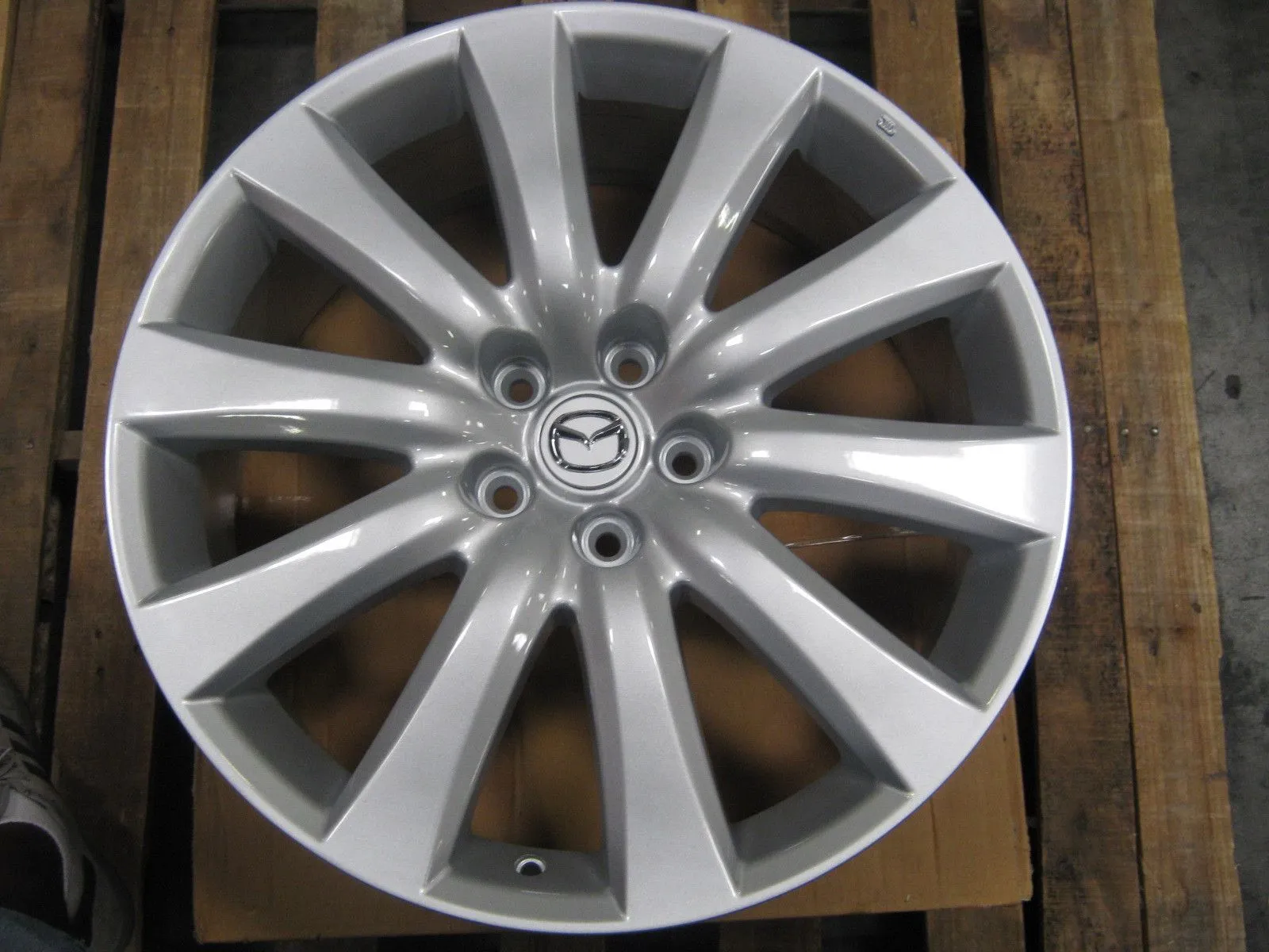

2nd is: CX-9 20" OEM Factory wheels 20x7.5 (offset +45)

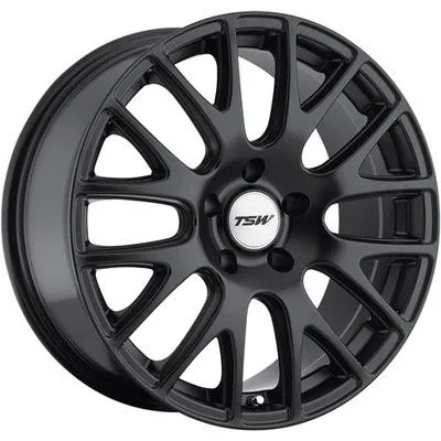

3rd is: 20x8.5 Black TSW 5x4.5 (offset +40)

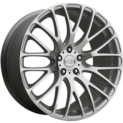

4th is: 20x9 Silver 5x4.5 (offset +35)
All good choices, though I would prefer the TSWs in silver (IMO, with some notable exceptions, the current black wheel craze sucks). I've wondered about those larger CX-9 wheels; does anyone know if they will fit CX-5?
I have no idea on any of these whether they will fit the CX-5.
I'm hoping members of this forum can tell me based on size and offset (dunno)
Someone put the CX-9 wheel & OEM CX-9 tires on the CX-5.
I can't seem to find the thread but look for it.
I musta' missed that. If anyone can resurrect it I'd appreciate it!
I would stay away from #3.. that is a very common aftermarket rim, #1 looks tight, but chrome wheels really depend on your car color/exterior trim imo. (I don't think chrome wheels would genrally go well with the CX-5 unless maybe you put those chromes trims on it, but that would probably just look tacky). OEM wheels, nty (although the cheapest route). What color is your c-5?
My CX-5 is white. I agree with you...I think #1 will look good but do you think the size and offset will be okay?

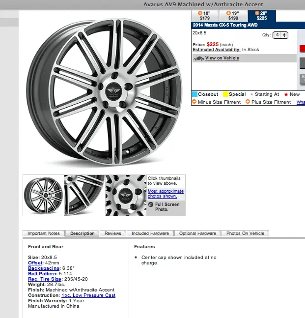

What about this one...tirerack
The offset is better than #1?
Yeah going from 50 to 35 is a lot. Offset measurements depends on the width of the wheel also.
Measure how far in the fender the OEM wheels sit.
Put a flat surface(flattened cardboard box) against the face of the wheel & use a tape measure to measure from the flat surface to the inside lip of the fender.
Dang, those 20" CX-9 wheels do look sharp.
I kind of dig how it retains an OE appearance.
No to the TSWs. Don't cheapen the appearance of your classy CUV with dark wheels. It is a played out appearance.
As for a +35et offset, I'll bet you'd be fine. Though, +35et w/ a 9" width is getting pretty aggressive. Not sure what the limits are on the CX-5, as it doesn't appear anybody has really attempted to have tested them.
Spacing the wheel face 15 MM from the hub really isn't much, especially on the CX-5, which places the face very far inside the body with the OE wheels, also has a rather large wheel well area and sits a good distance from the ground.
I think the bargain here would be the CX-9 wheels, assuming you can find a good pre-owned set. Otherwise, I like the first set. 8.5" is a good width and a better match with the +35et offset. You can accommodate a 245 series tire on an 8.5" wheel. No sense in going beyond that. You'll compromise the car's excellent efficiency, and possibly rub.

What do you think of these: http://www.tirerack.com/wheels/Whee...el=CX-5&autoYear=2014&autoModClar=Touring+AWD
Link isn't working, if that's the wheel customized for your car, it wont show up.
See attached picture...shows size and offset.
Offset: 42mm
Backspacing: 6.38"
Bolt Pattern: 5-114
Rec. Tire Size: 235/45-20
Weight: 28.7lbs.
Finish: Machined w/Anthracite Accent
Price seems reasonable?
